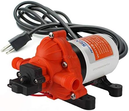

Overall…pretty pleased with this setup. Next up is finding a small cheap pump on Amazon and maybe some type of filter for the fill… And a tank that’s not a bucket. But for now, a few buckets will work well for me. I’ll just pour them back in to fill.
Here is the one that I purchased. Check it out and see if it would work for you and within your budget.
It comes with 1 inline filter and I bought a 2nd one. I’m gonna use 1 between the tank and pump and the 2nd one between the table and tank. Hopefully this will help keep my water clean. I also came up with the idea of putting magnets around the drain holes so to catch more of the fine particles. Your setup came out really nice. I’m gonna be plumbing mine pretty much the same way controlled with a check valve and 1 on/off ball value. Been working so much that I don’t have time to start putting my CrossFire Pro together. It’s been sitting in the shop for almost 2 months (Batch 1). Oh well at least I still have my original CrossFire going.
Thanks for the info! That looks like what I need!
I got this water pump from harbor freight . it is $50 with coupon right now. the in/outlet’s are 3/4.
It can fill up the table in about 2 minutes.
