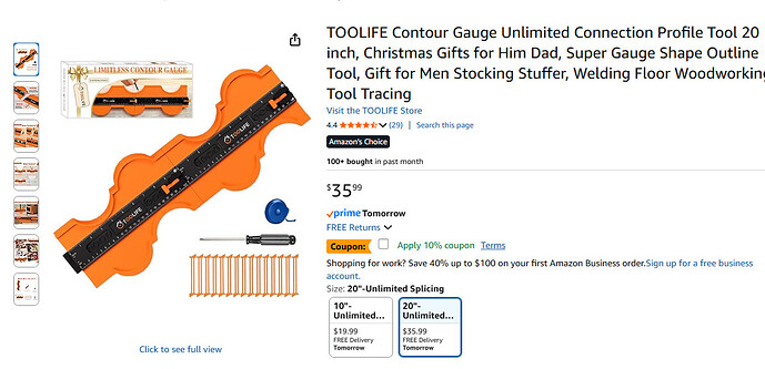

I have been doing the “poor man’s 3D scanner”:
One of these helps:
https://a.co/d/3XDEWE8
And then use the Shaper Trace device. It is very crude at best and still takes me about 10 to 15 prototypes until I am satisfied/worn down.

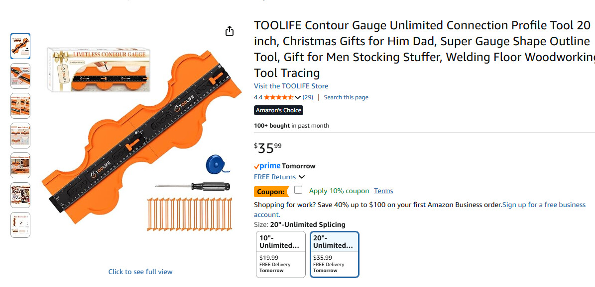

I ordered one. It looks like it could be beneficial.
+1 to this! I got two as soon as I saw this. One for each workshop!

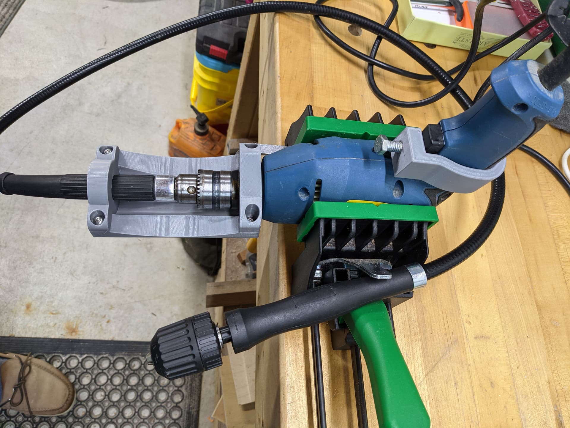

With it I’ve made (among other things) this, a drill continuous fine speed control by pressing the Contour Gauge into the handle, at the switch level, of the drill. Easy peasy. 2D, extrude, add threaded hole, print, done.
