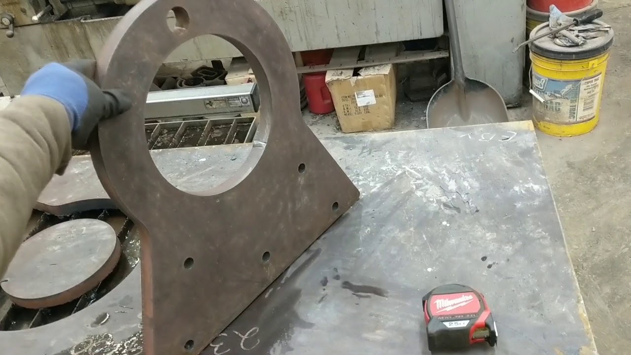

I have a small project to cut 1" plate with my Everlast 82i. I was wondering some feedback before I give it a go. Essentially it’s just a tab that gets welded to the end of a hydraulic cylinder that supports a conveyor. Might weld it to a nut instead and thread it onto the cylinder shaft. Not sure yet. If I can pull this off it will save me some where around 7000 bucks(yeah, i know… crazy) so I can use a common cylinder vs a factory custom unit. Need to make 3 pieces.
I plan to throw on my hand torch and crank it to 80amps. Play around with leadings to get an edge start in sheetcam. IPM is where i’m guessing… maybe 4-8 IPM??? should I keep standard .06 height? Should I put ceramic tiles at the bottom of my water bath for protection? I’ve only ever cut 1/8" plate and under.
Anything I’m over looking?

I don’t see any reason it won’t work. Edge start, 80 amps, 6 to 8 ipm, 75 psi, .065 TH.
The 2 things that would cause a draw back is getting the torch square with the work and your air compressor being able to keep the air constant.

That should work fine. I would cut the outside but drill the bolt hole.
Man am I pumped. This is my first attempt. Dross came off with a plyers. 1" Mild steel. Everlast 80, 1.2mm tip, 6 IPM, 75psi. 80amp, edge start, .15 pierce height, .065 torch height. 3 seconds(probably didn’t need that much), water in table and ceramic floor tile lining the bottom of the water pan, used but good consumables.

It did come out well. I would have used a 1.3mm/80 amp tip and 80 psi but it did work.
