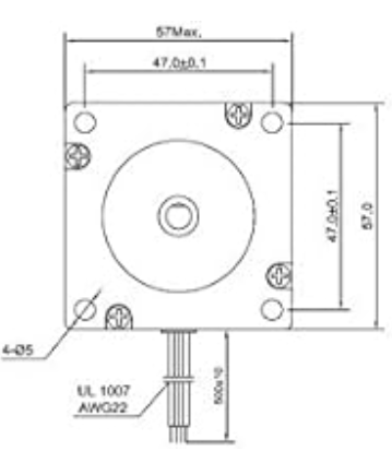

Will this motor from amazon work as a replacment?
Amazon.com: STEPPERONLINE Nema 23 CNC Stepper Motor 2.8A 178.4oz.in/1.26Nm CNC Stepping Motor DIY CNC Mill : Industrial & Scientific
Thanks in advance
That looks pretty close. Langmuir states specs of 180 oz/in and this is 178.4 oz/in.
The hole pattern seems to be correct. I measured mine and was guess-timating the centers of the mounting holes to be 47.8 mm and the diagram is showing of your product is 47.0 mm.
So I think that would be a pretty good replacement. You could contact Langmuir and they would sell you their actual one. (I see that you are in Australia…so understand that ordering from Amazon would be easier.)

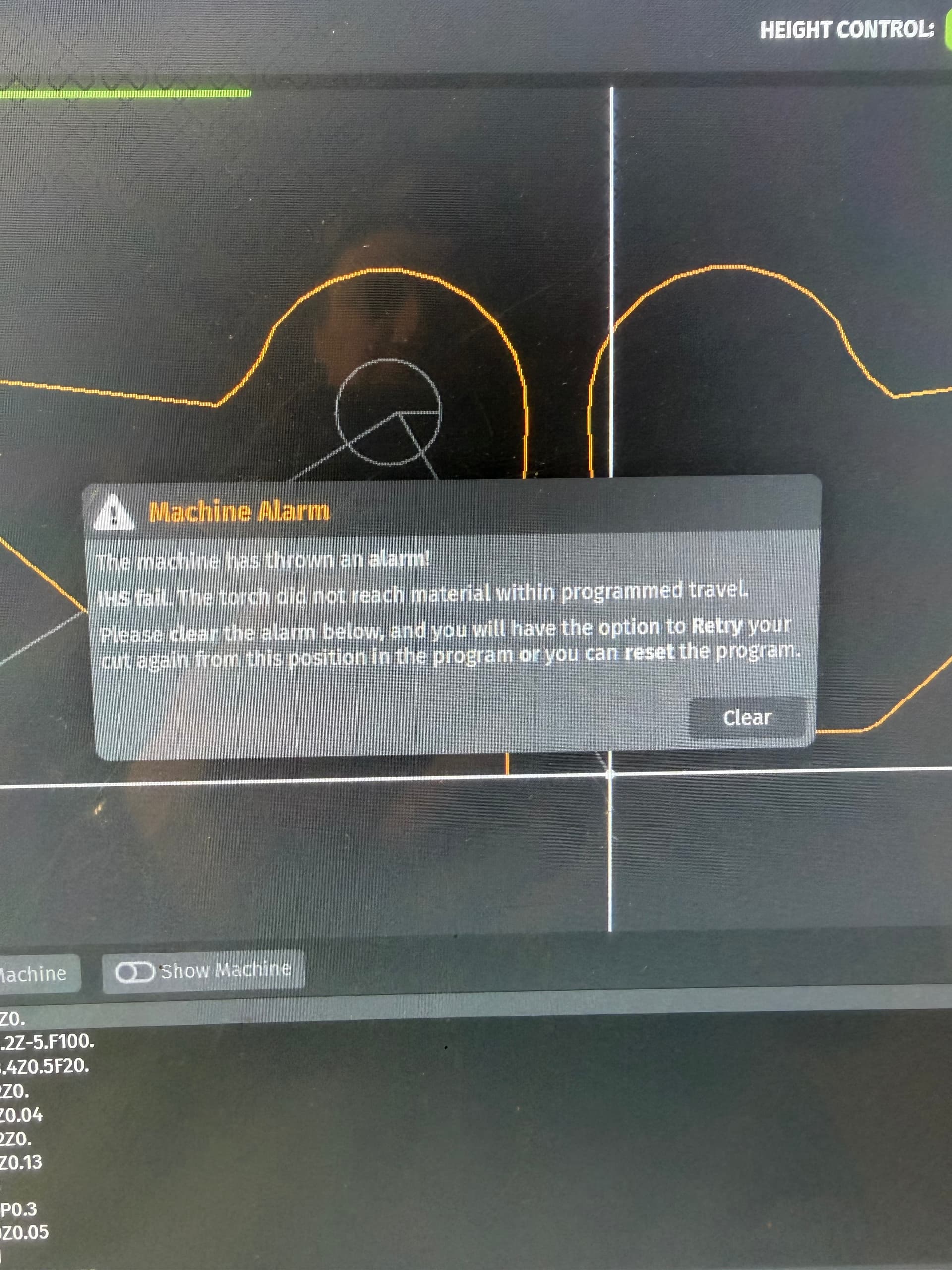

Okay got the new driver in that solved my problem there, now I am having a new issue. The torch cuts the first hole. Moves to the second one touches material and then throws this code.
Did you flip the dip switches on your driver to match the driver you took out if not it might be running at a different rate of speed / distance.
Or the z axis coupler might be slipping or the initial height sense contacts aren’t connecting (but you would notice that 'cause it would be driving it into the sheet too hard installing of the motor)
Both drivers looked exactly the same when I checked them out before the swap. I had this same issue when I first got my table but then it stopped doing it. I’ll double check the coupler when I get back home today.
If you’ve been messing with the Gantry wiring you may have knocked off/loose the IHS switch connection. I’d check that. There is a ‘light’ on the Firecontrol Screen that indicates when the IHS switch is operating.
Thank you to everyone for the info and advise. Table is working again!!
How? What fixed it? Reward those who helped you by letting them know.
Well the driver fixed my z axis issue, and then the coupler was loose from the steeper motor to the rod on the z axis tightened that up and workin great now.
