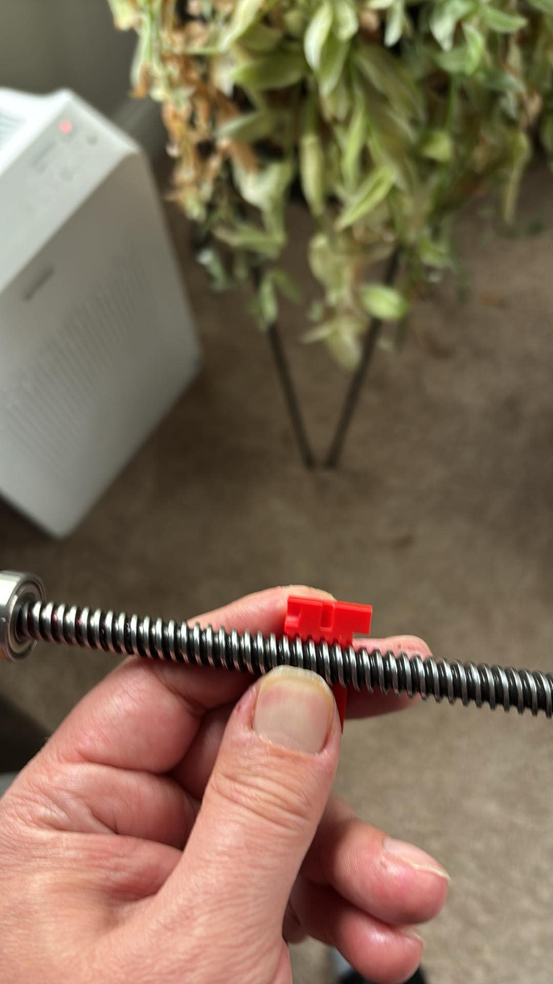

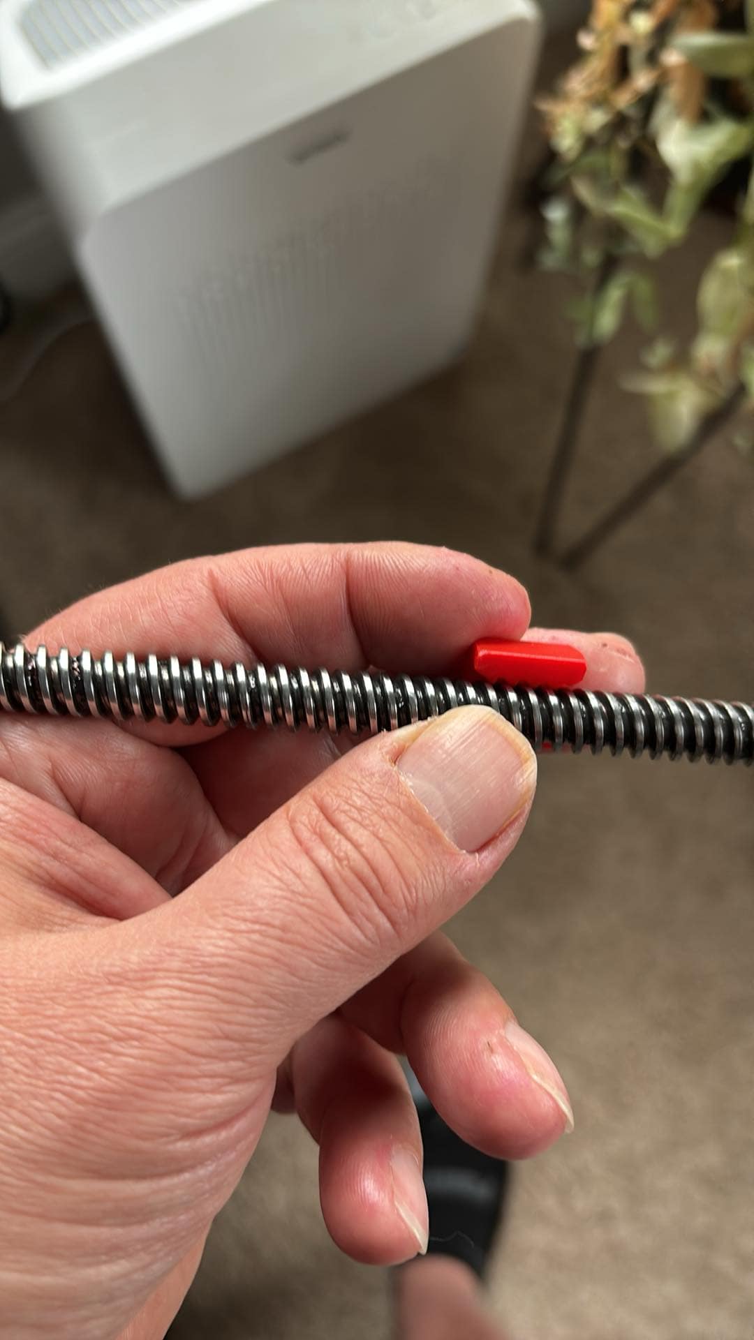

I’ve been noticing a lot of slop in the plastic part that rides on the Z-axis screw—looks like it’s wearing down, and the screw itself has some wear too. I’m looking to 3D print a replacement using a stronger material like carbon fiber, but I’m having a bit of trouble dialing in the screw dimensions. It seems like the wear is mostly in the middle of the screw, since the part fits snugly at the top and bottom but gets loose in the center.
If anyone knows the exact specs for the lead screw or where Langmuir sources them, that would be super helpful. I’m guessing it’s either a 3/8-8 ACME thread or a TR10x3 trapezoidal thread. A direct link to where they get them would be even better.

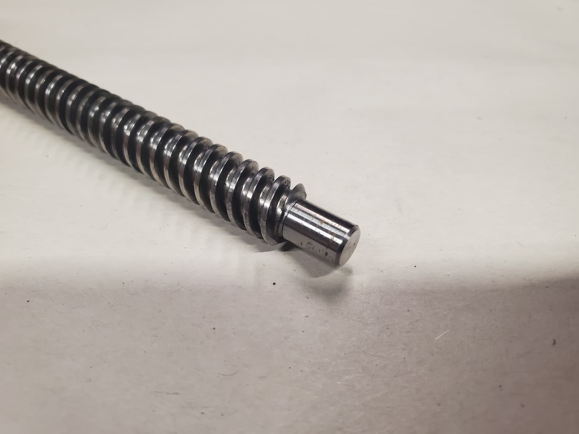

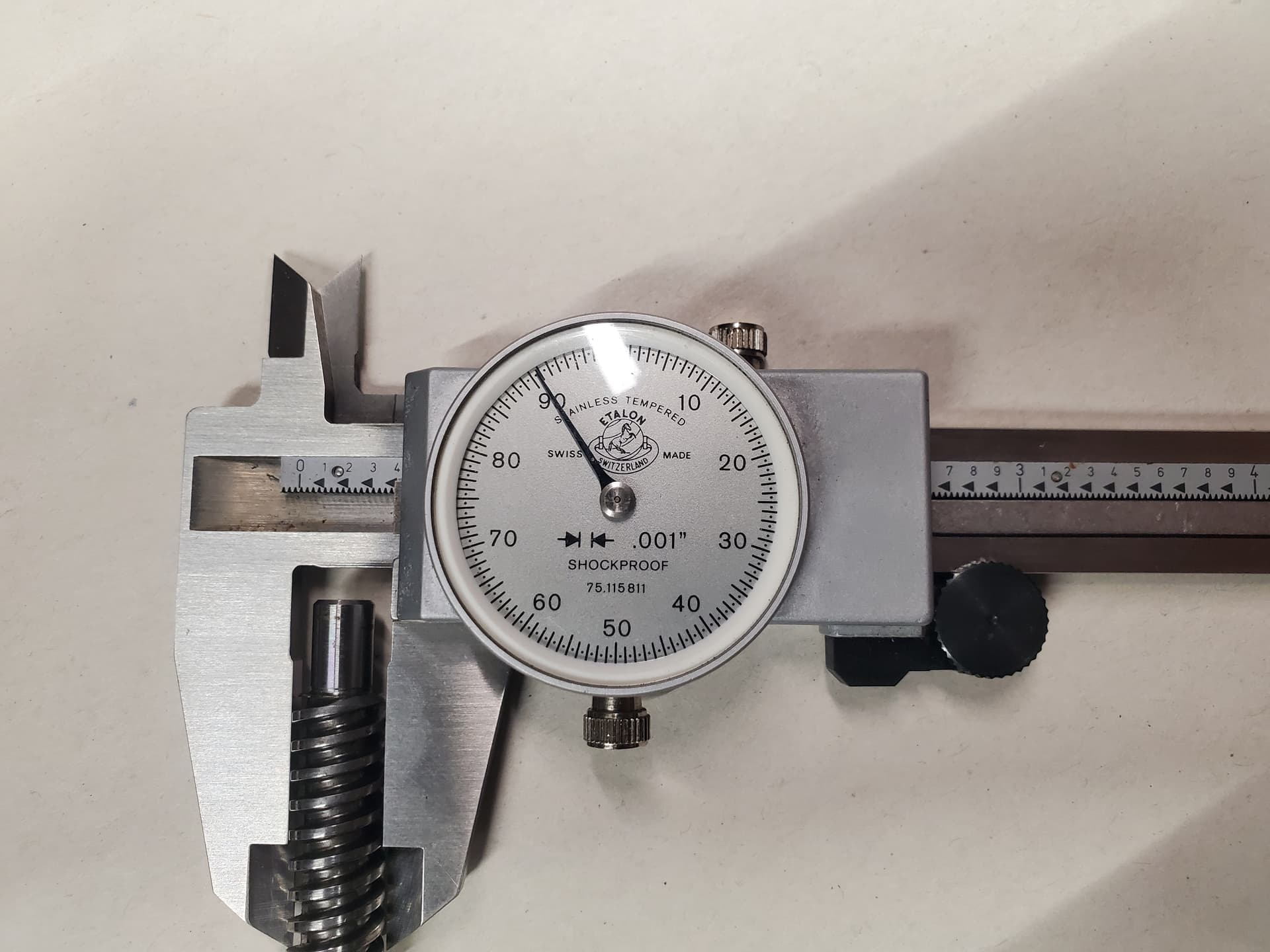

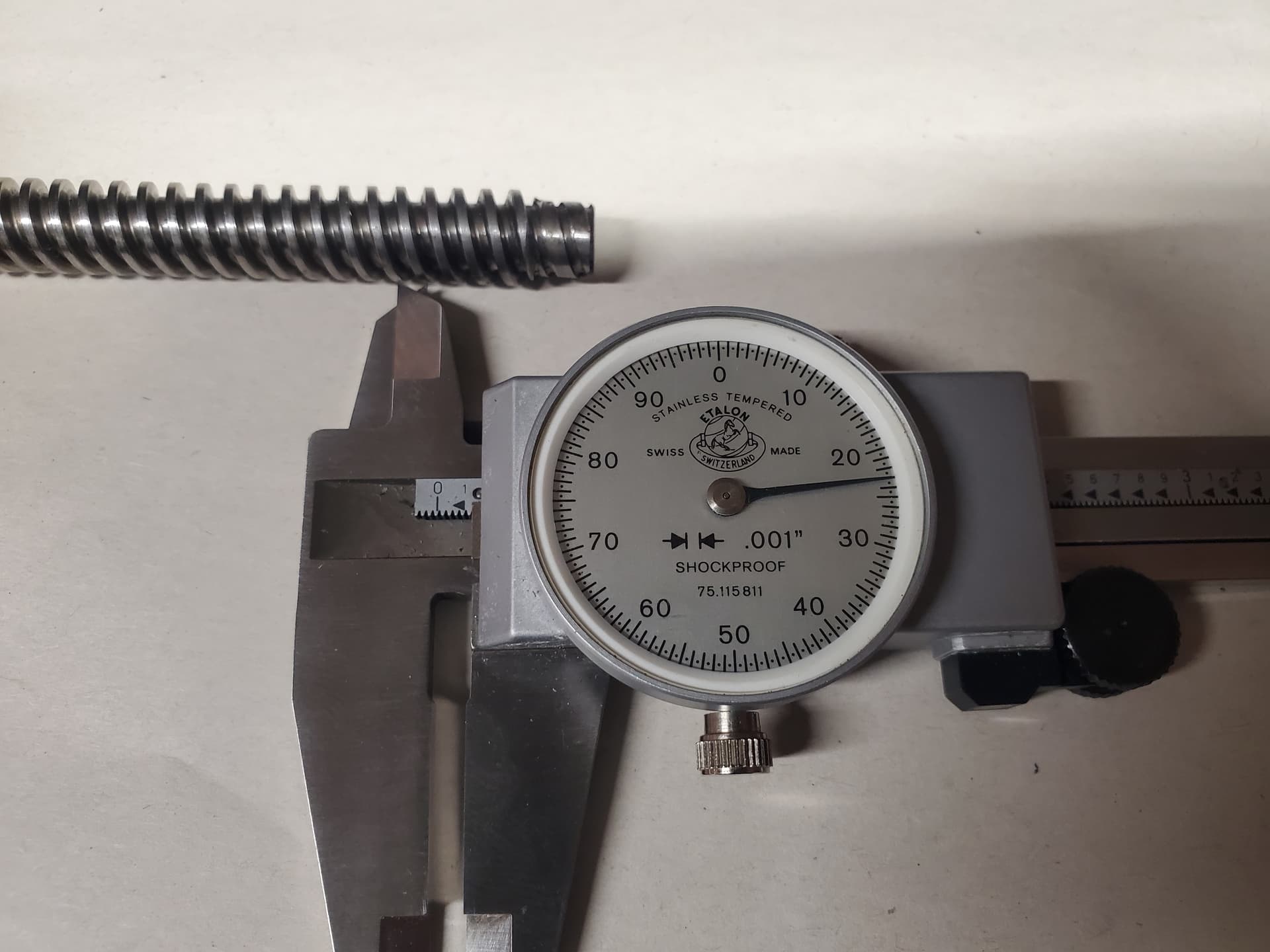

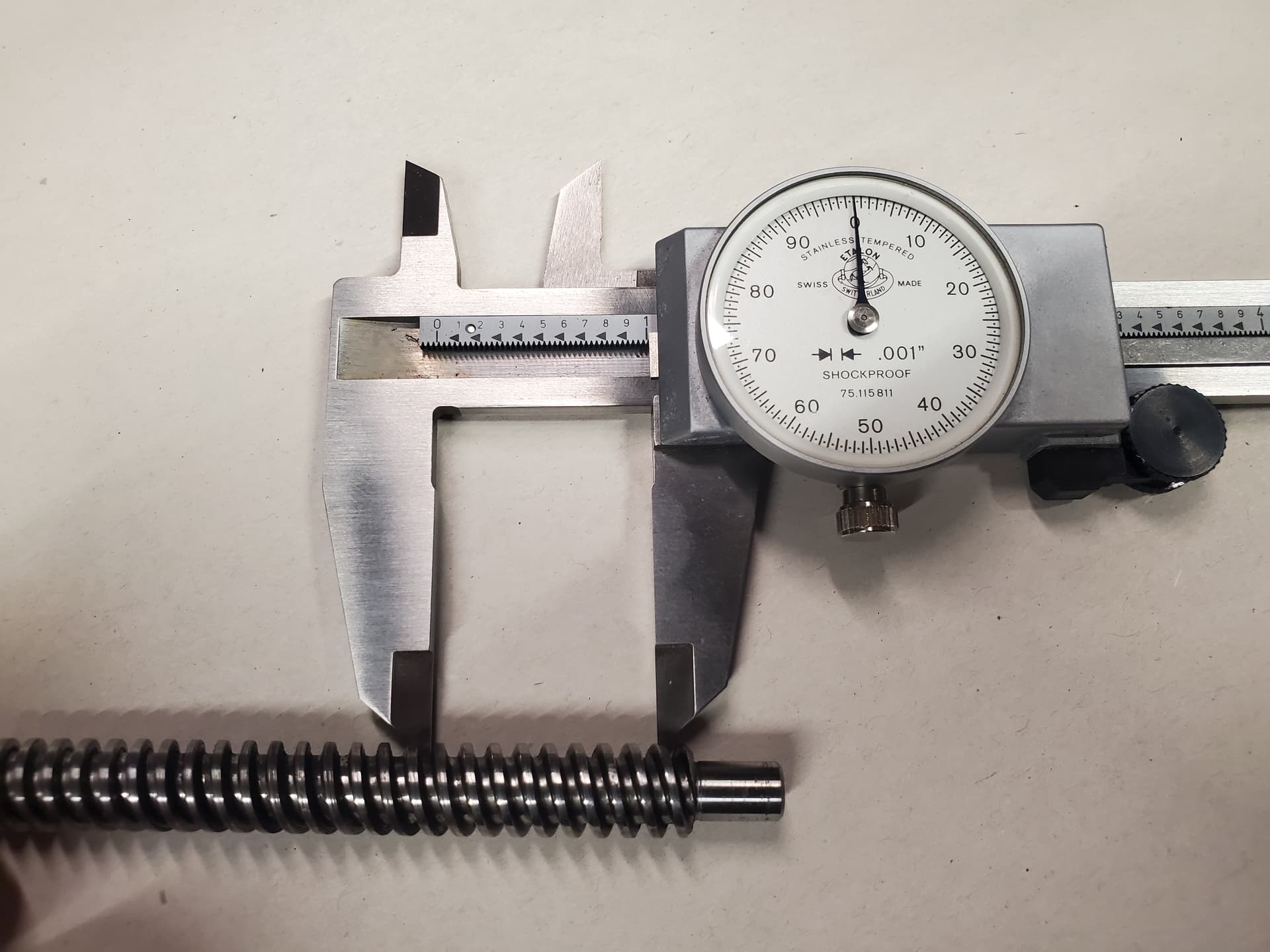

So far I measured 1 start, a diameter of 0.3905", 9 threads per inch, and between the leads something like 0.1230"
Thats what my buddy was getting too.
Got bored, figured I’d measure it.

It’s probably the same as the Y axis rails, which are 3/8-8 4 start acme screws.
If the screw is worn from the nylon nut, an abrasive filament like carbon fiber is going to make it worse.
I would contact Langmuir and just purchase a new lead screw and nut.
I’m all for making my own stuff, but putting a new nut on a worn screw is like putting a band aid on a bullet wound.

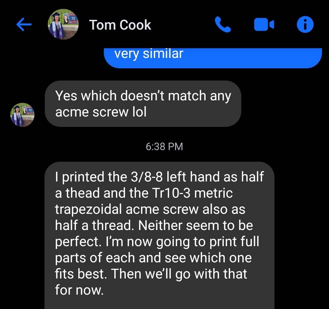

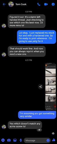

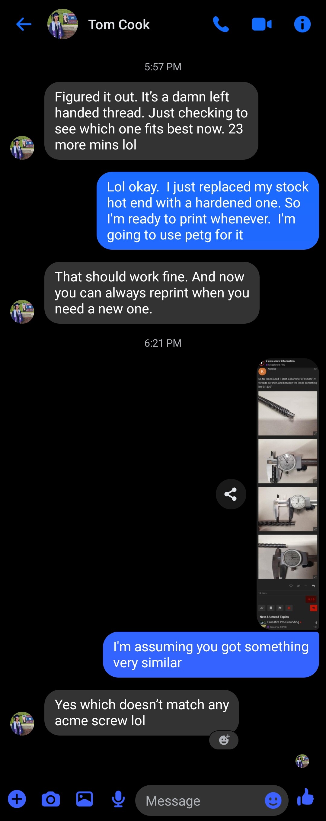

Ill end up ordering new ones tomorrow. This is just to get me back up and running till it arrives. The set i have on the plasma now is jamming. I have my buddy the spare set i have to work with

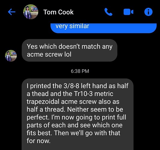

the problem im finding is that early on they used a 1 start screw, and then later switched to a 2 start screw. i have a new screw and nut coming in the mail and will see what style they are using now. and from there i will work more on figuring the screw out. i spoke to them on the phone and they are not able to disclose the thread information on them, i can however confirm it is acme since that is in the part number.
The pictures and measurements shared are that of an entire Z axis assembly that is only a few months old.
Give me some dimensions when you are able, I may be able to figure out what the thread details are…
