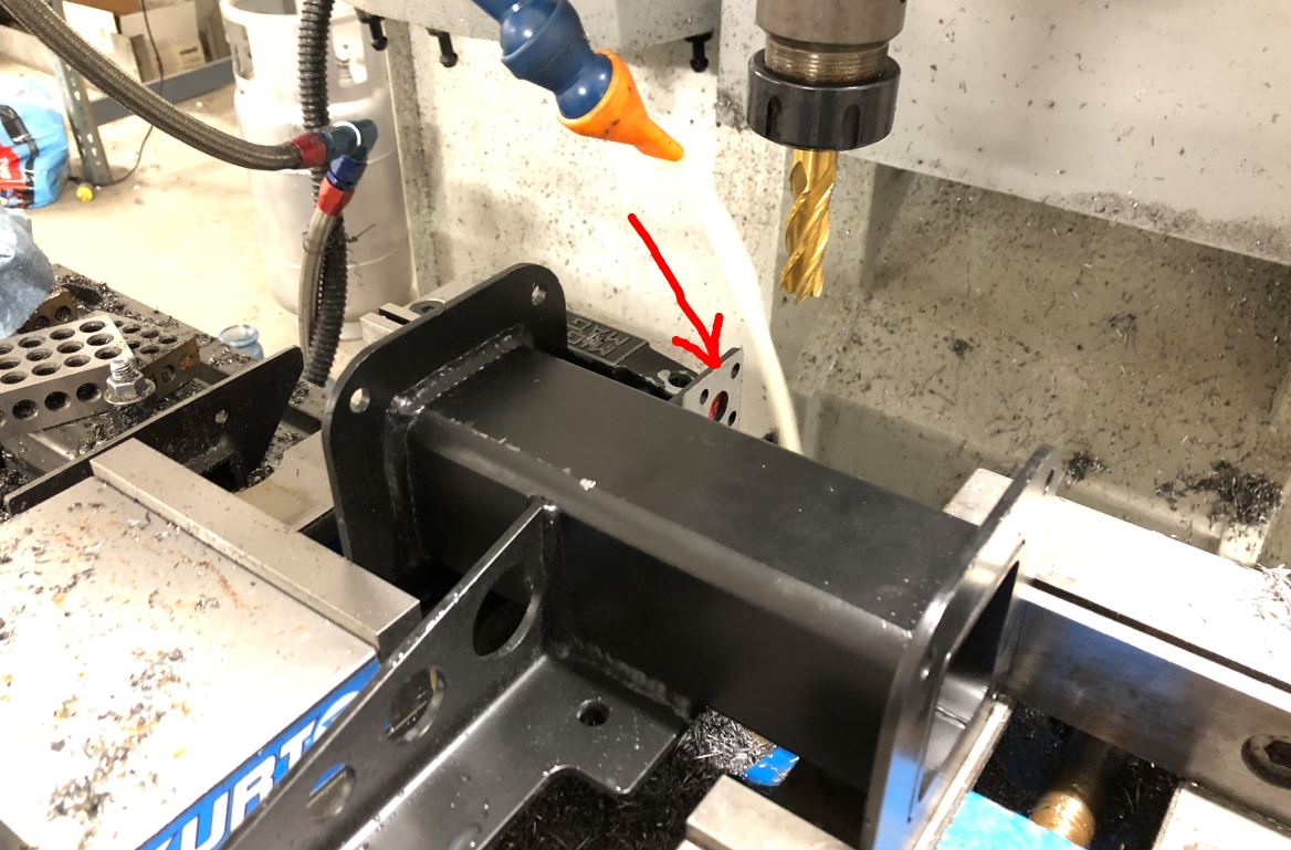

A small number of customers have encountered an issue on their machines where the Y axis binds intermittently during jogging of the Y axis. The root cause of the issue is a minor manufacturing defect on the Y axis carriage weldment where the lead nut mounting flange is not exactly perpendicular to the axis of the lead screw. Therefore, tightening the lead nut bolts applies a preload between the lead nut and lead screw which increases the friction to a level that can’t be overcome by the Y axis motor.
Since learning about this issue, we have reinspected all of the carriage weldments in inventory and scrapped the ones that were out of spec. Our vendor is currently manufacturing replacements (after fixing their process to prevent this from occurring again).
If you are one of the unlucky few that encounters this issue when you run the machine for the first time, rest assured that the fix is easy. First, it is important to lubricate your lead screws. This is something that we have always done, but we completely forgot to put this instructional step in the user guide. If you check the user guide now, you’ll notice that it now states to lubricate your lead screws with multipurpose oil or engine oil.
If you encounter binding even after lubricating your lead screw, first make sure that your lead screw is lubricated, it is due to the lead nut mounting flange being slightly out of square. To correct it, use washers between the lead nut and mounting flange to shim the lead nut. Below are before and after pictures showing the repair to a customer’s machine. In his case, he used two washers from the bottom bolts to shim the top bolts.

In order to maintain our production rate, we have decided to rework the Y-axis carriage weldments to fix the issue that is the subject of this thread. We are milling the lead nut mounting flange flat so that it is perpendicular to the eventual axis of the Y-axis lead screw. After milling, we are deburring and applying clear coat to prevent corrosion.
See picture below, the red arrow shows the machined flange:
