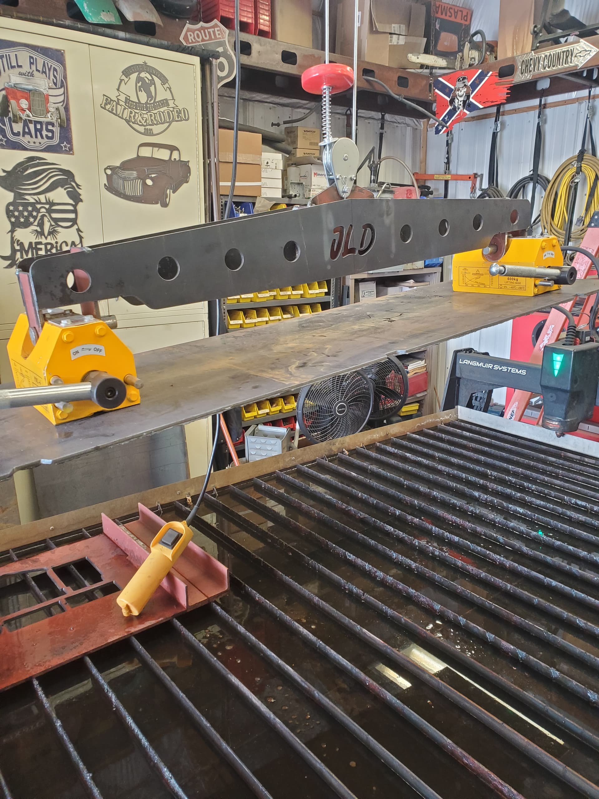

Amazon. 600kg lifting magnet. We’re planning to get another one and fab up an I-beam spreader to minimize plate bending. Will let us lift 1/4" plate (sags too much with just one magnet).

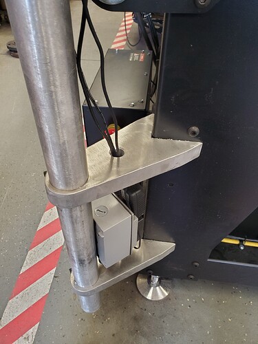

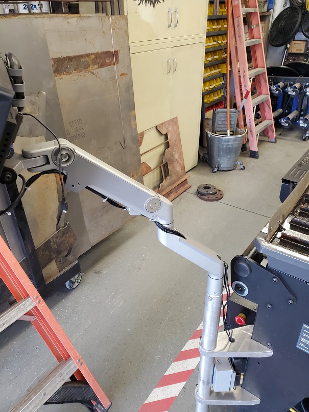

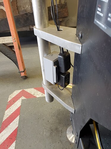

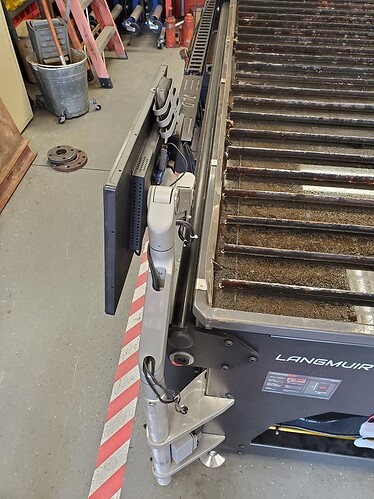

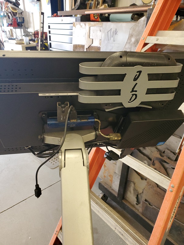

Just a Little Upgrade to the Computer Station. Turned out Pretty Well. Tore apart the Articulating mount, machined it for a post and Played a Litte on the ol’Smithy for the Mounts and computer swivel. Added a GFI outlet and routed to my cable chase at the back of the table, so no more tripping on cords. :smiley:

Nice setup. Just finished an overhead trolley in my garage with electric hoist and double mags

That is a sweet double magnet setup. I dont think I will be cutting large enough sheets to need such a set up, but then again…I may be hitting you up for more info!
