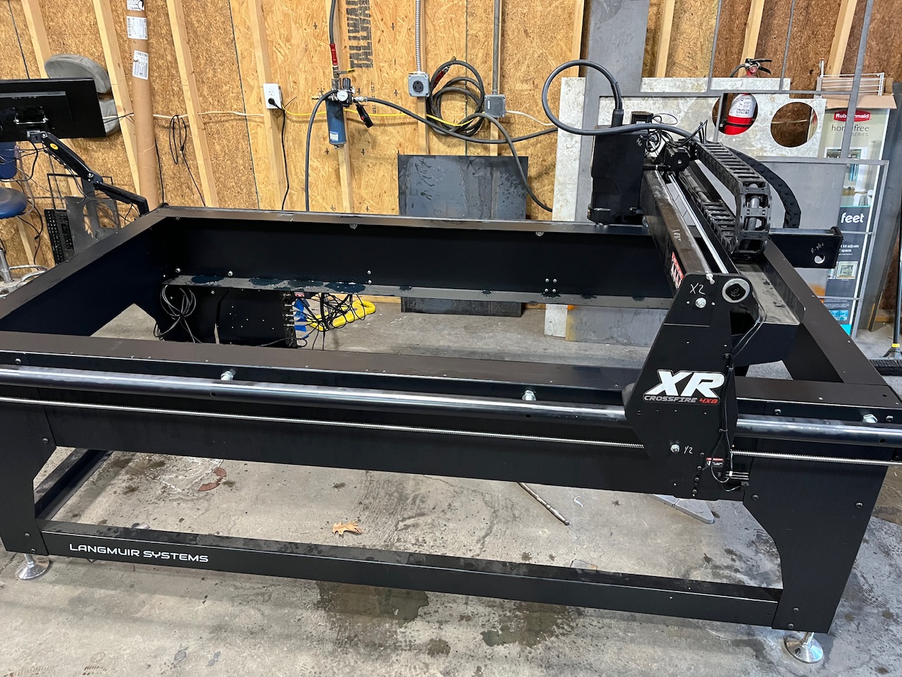

XR not cutting square

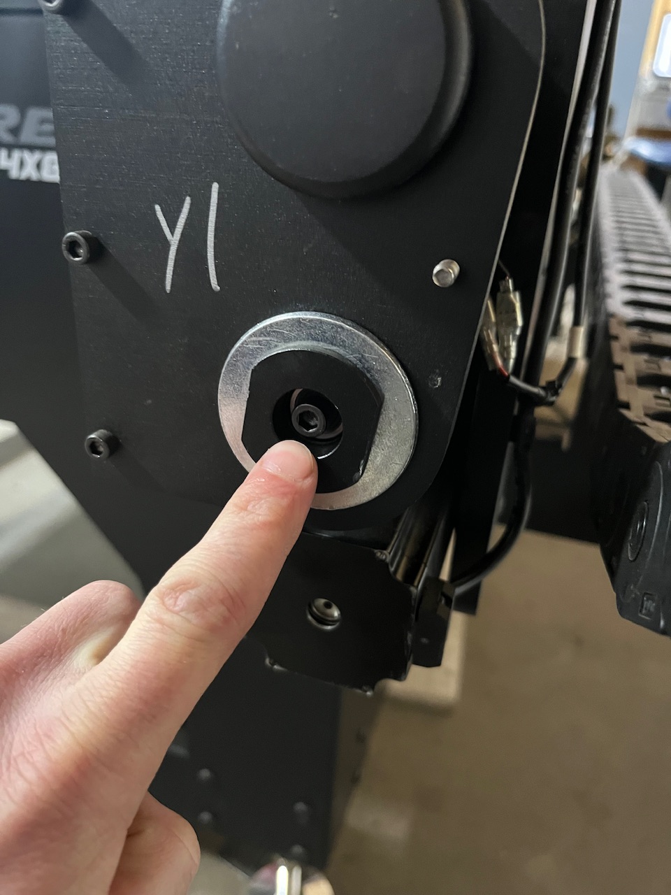

I did what you recommended and loosened the rod end bearing and bearing mount while it was at the home position and had it line up naturally with the rod and tightened everything back up
Awesome. Does it home now without binding?
No sir it still bound up a few inches past home, I cut the same file for the 22”x12” 3/16” plate tonight with the kerf set at .050 with a 45 amp cartridge and it was a 1/4” out of square diagonally.
I redrew the part in F360, saved as DXF to my computer, uploaded in Sheetcam, went from flash drive to the Langmuir computer, cut another plate and was closer to 3/16” off diagonally from corner to corner.
I have no idea what else to do, I am seriously considering selling this machine since I can’t get it to do what it’s supposed to do.

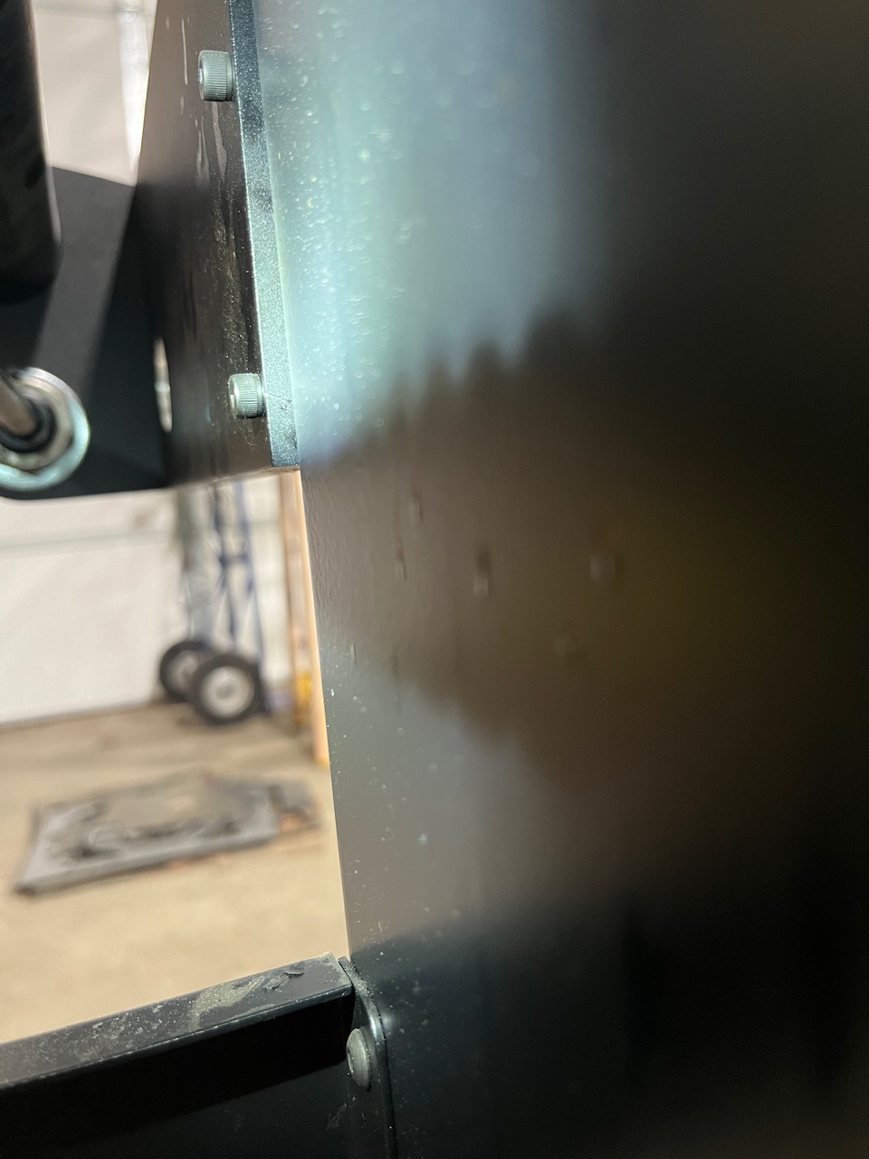

Sam, don’t give up. We learned that the binding is not the relationship between the rails and the screws. Im pretty sure your rails are out of adjustment right at the end. This would also explain why you had to again remove paint and use an abrasive right at the end. My suspicion now is the aluminum bracketry at the end of your table that holds the end of your rails and your screw mounts.
Where they mount on the the body of the table there is some play there. If you tightened all the bolts in the wrong order you could have caused that long bracket to act a a lever and either pushed the rail out or pulled it in. I would move the gantry to the middle of the table and loosen one of those brackets and allow the rail to relax. You could put some reference marks on the body and bracket to see if they move when you loosen the bolts.
When you tighten them down again. Make sure it is not causing any deflection in the rail. The lock ring on the rail should be tightened last.
As far as the square issue goes, there is no solution to that other than partially disassembling your machine and squaring it.
I drew your 22x12 panel out of square by just under 1/4" and it shows in the drawing that its off by 0.7 deg. Which makes your table out of square by 1/2" or so assuming the two long sides are parallel.

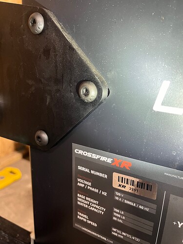

But now that you say the tube mount bracket, I remember when I did the opposite end of home position on both sides when I loosened those 3 bolts it moved quite a bit and with tightening I noticed it would move as well, I think I will go back and look at this this week depending on snowfall……

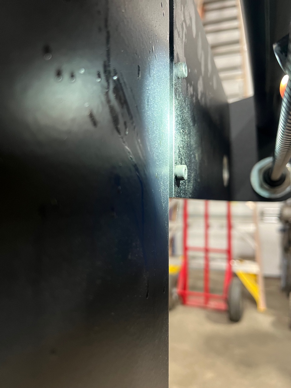

I noticed that both of the tube mounts were not equal, not sure if this is part of the problem or not.
2nd set of pics is the opposite end with computer

I have a potential idea for checking squareness… what if you were to wrap string very tightly around the entire perimeter of the legs just below the upper rails and then use the “3x4x5” measurement were you would use a sharpie and mark 3’ from the corner leg onto the string on the width of the frame and 4’ mark on the long part of the frame and string, then measure the distance from dot to dot of the marks and it should be 5’. Hope that makes sense and if not I could mock it up on my machine and take a picture to show you.
That’s actually a really smart idea but I was looking at my table and the side panels drop down so far that what you are actually checking is the average squareness between the top and bottom of the frame. It might reveal a problem but I don’t think it would be very conclusive.

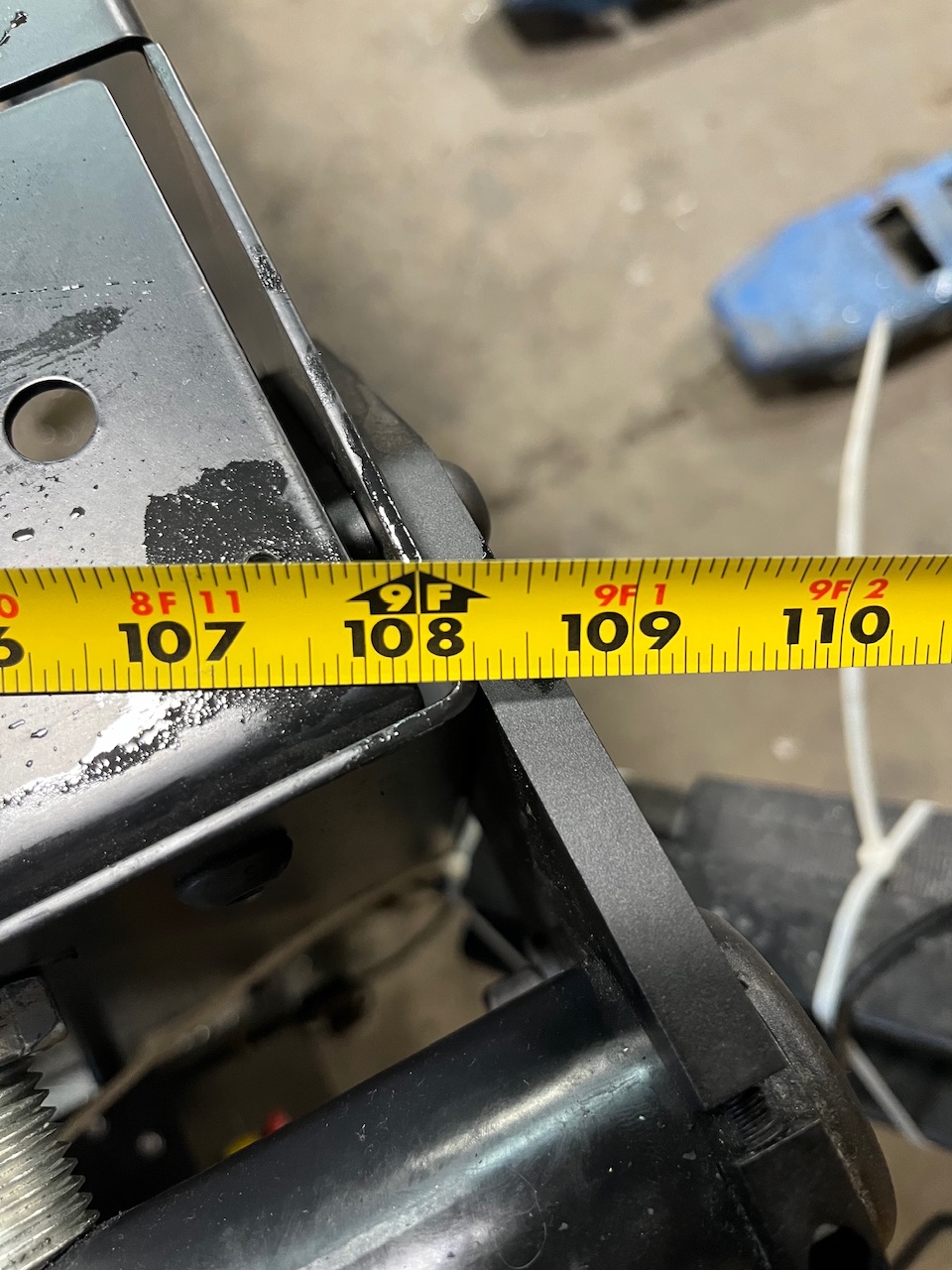

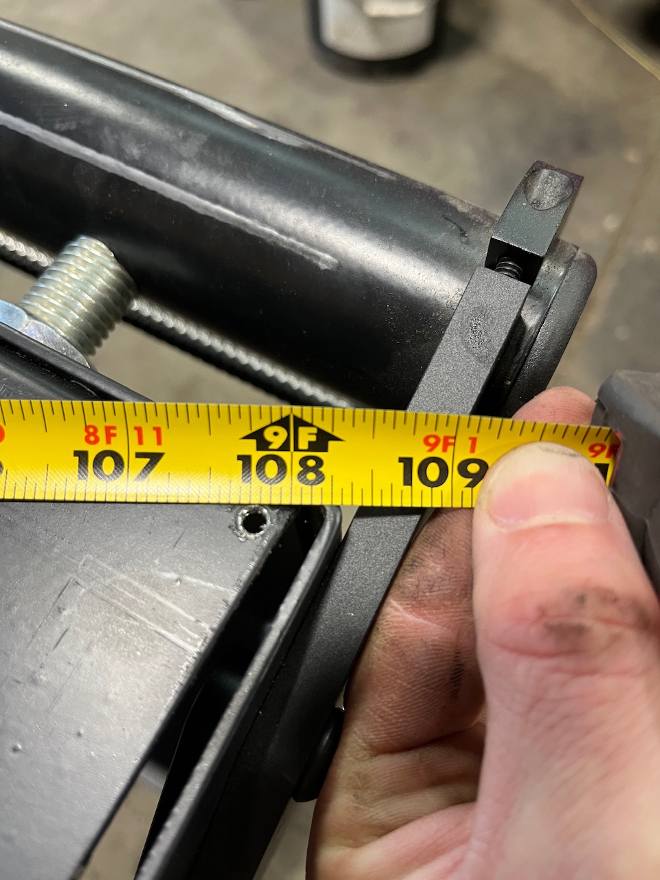

Finally got around to taking the bed apart
After taking all the screws out, 1 at the computer end got stuck as if the frame sprung some, after pulling the entire bed off in 1 piece, I took a measurement, and this is what I I came up with……
As I stated before I was 1/32 or so within the measurement, it seems it was still there. But I can rack the frame now with the bed off, I’m thinking of clamping some bars across and see if it will hold the measurements this time.
What do you guys think?
Do you think it got out of square when you installed the water pan?
I can’t remember all the info in this post, but I would try and get your problem taken care of before reinstalling the water pan.

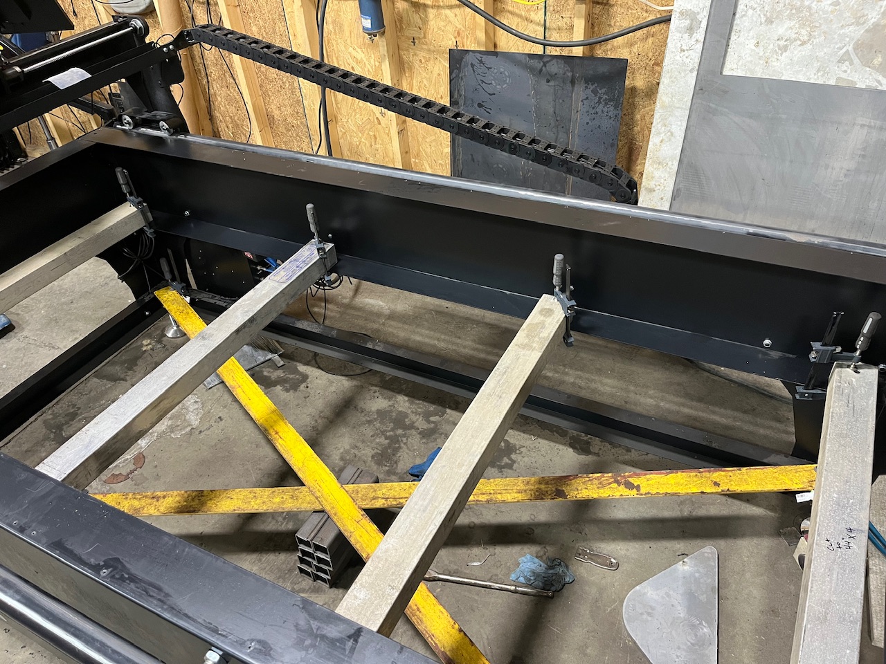

Are you talking about clamping bars to hold it square while checking it with the water pans off? If so I think that will work as long as it’s stiff enough to hold things from racking
Man I have no idea, I was thinking that with the weight of the water in the bed it may have moved stuff around but I really don’t know.

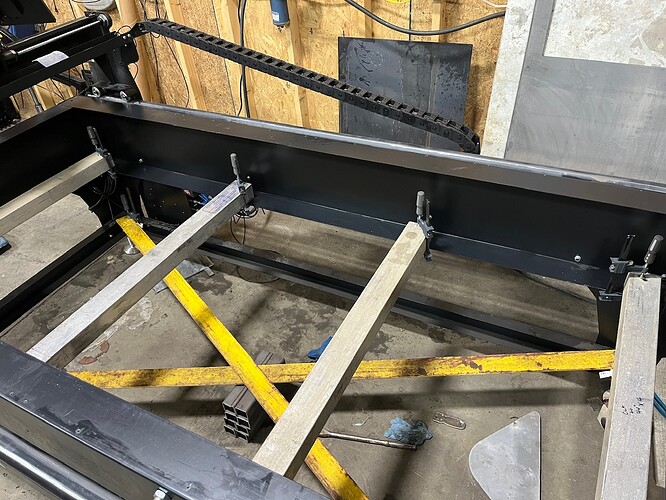

What I want to do is clamp bars across to keep everything tight then reinstall the bed but I’m checking some other things before I put that back on.

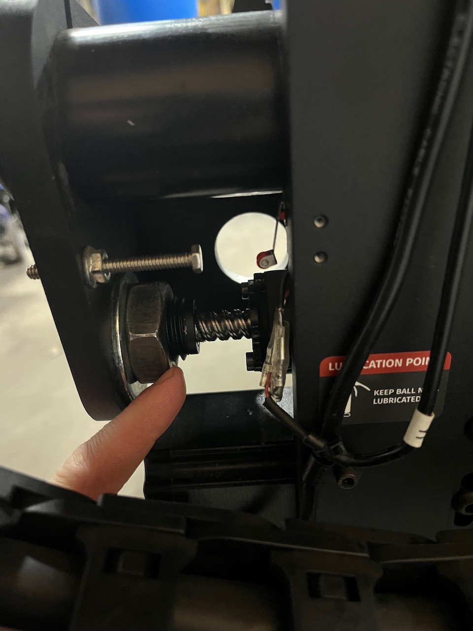

I took the ball screw bearings off the drive motors and the gantry rolls a good distance before it stops also I scrapped all the paint off where the rollers touch the tube to make it smooth , other than the inner line on the bottom side of tube, I can’t really get that one.
I checked checked squareness at least 5 times last night and clamped 4 pieces of square tubing and the bottom of the top channel of frame and 2 pieces of 3/8” flat bar in a “X” on the lowest frame rail, I am currently 1/32” out of square for over a 9 foot span. I am realigning the Y tubes getting the 1.25” measurements going the opposite side and using the DIM A measurement adding the 1.75” and am within 1/32” of that measurement as well after that I retightened the tube braces on each end, next up is reinstalling the bed, starting at one corner then going across to opposite corner then so on and so forth the rest of the length. After this we will readjust the rod bearings and mounts.

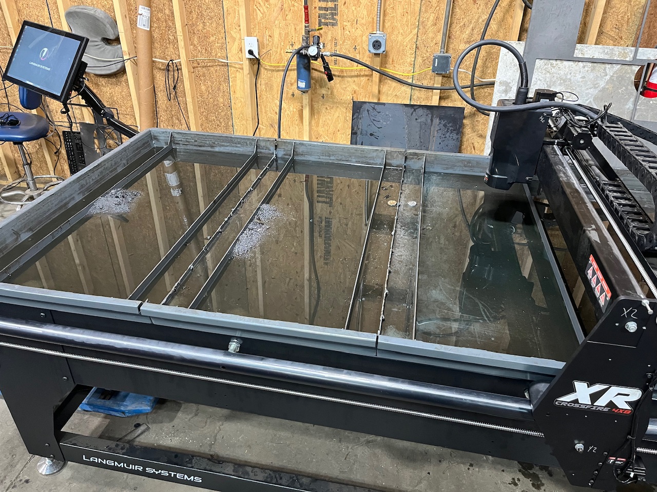

We got the bed back on and is much more square than it was I ended up using #12 screws this time, I reinstalled the bearings and tensioned the rods, moved the gantry back and forth at different speeds and finally 400 ipm. Ran the break in program twice and at this current time there was no binding, here is a video.
