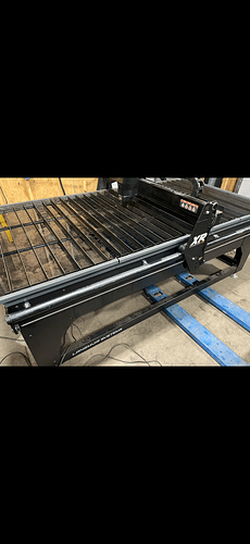

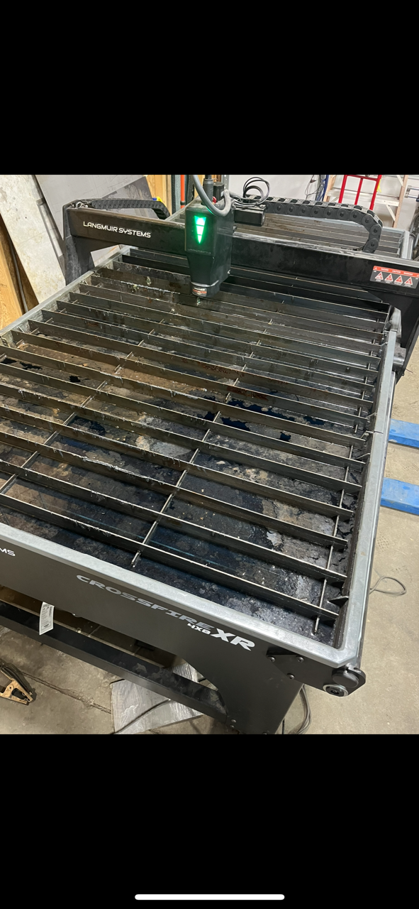

Hey everyone, i started my machine up last evening and has not been turned on since my last post, i homed the torch from last position when i cut the test squares, as i jogged at 400 IPM from home it immediately bound up about 2-3 inches from home. the machine was cold and maybe 50 degrees in the shop and has not been turned on.
Could this happen if the drive motors are cold? This has happened more than once before from when it was off. Also as stated previously we had everything adjusted right and didnt have any issues at the time.

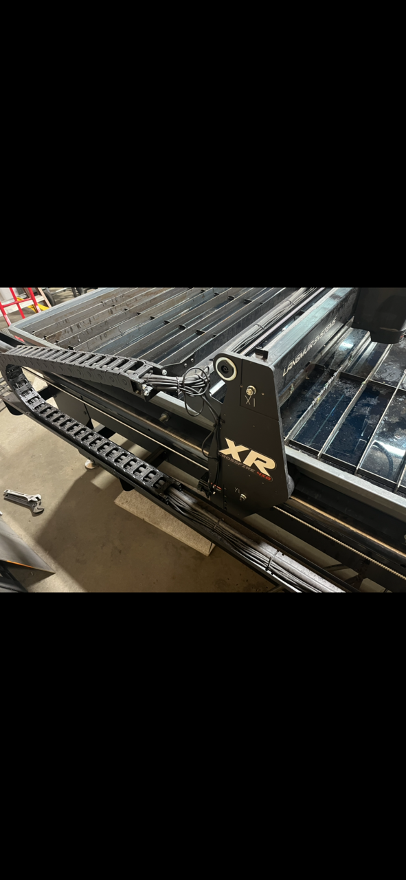

I did……I think. So I left the machine on so the motors were warm before I started, I honed the machine and the same thing happened. It bound up about 2-3” on the Y2 and the Y1 was about 4 or so inches when I stopped it.
I moved the gantry around several times and rehomed it again and did the same. At this point I moved the limit switch out or forwarded to see if this would help, I would say that it did because after than it didn’t bind up, however I did notice that powder cost was chipping where it was binding also so I scraped off what was loose and sanded with Emory cloth to smooth it out, that seemed to have fixed it , or at least it didn’t bind up anymore last night.

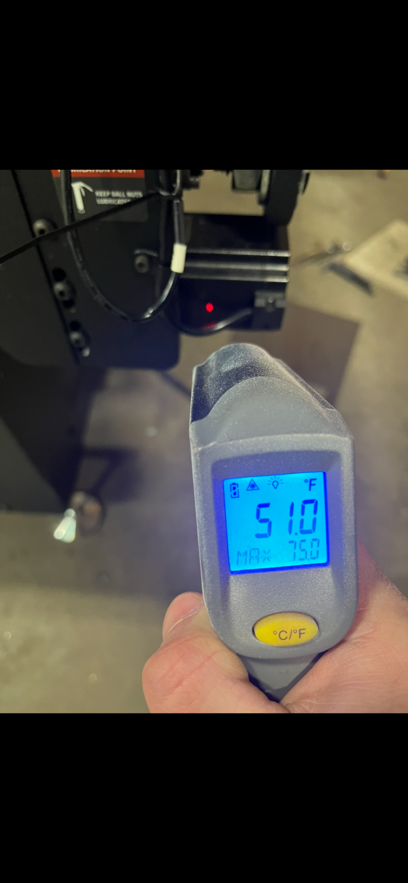

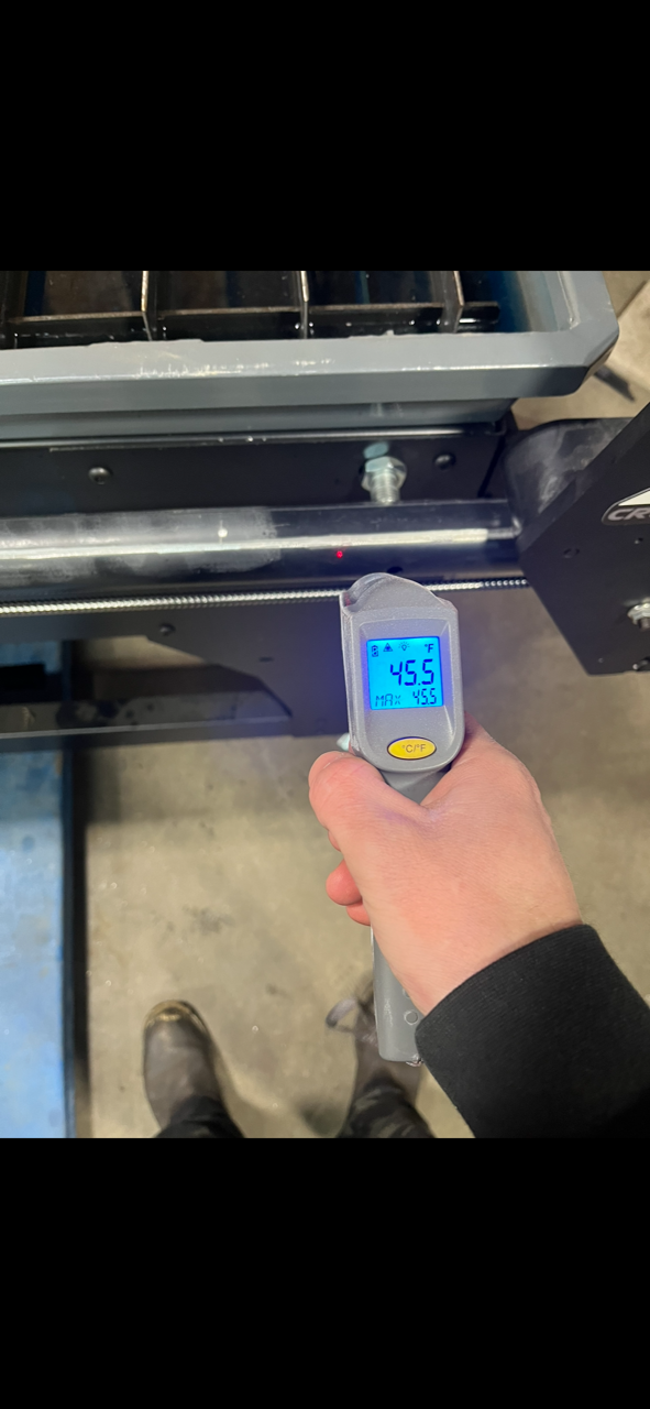

Reason I asked about the motors being warm is the Trumpf Trupunch 5000 and our Trumpf CO2 laser do not like being cold, as well as our Mazak machines. They have to warm up some before we use them in our sheet metal shop.
