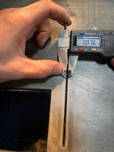

do a 4 " straight line cut and measure width of kerf to find what actual kerf width is. As far as bevel make sure torch is square to material surface you are cutting. Torch height will affect bevel as well and bad consumables.

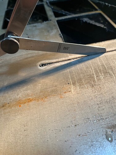

I did a 4” straight cut just now and roughly measured with calipers @ .076” and checked the bottom side with feeler gauges and a .040 would fit tightly.
So seems the kerf is correct.
Also I changed my setting to 75 ipm, .120 pierce height, .040 for cut and 110psi for the 3”x3” square and all sides measured close to 3.030. Plus or minus a few thousandths but seems closer than yesterday. Thoughts? Btw I appreciate the responses and help, as with several other owner/operators this has been a headache.
