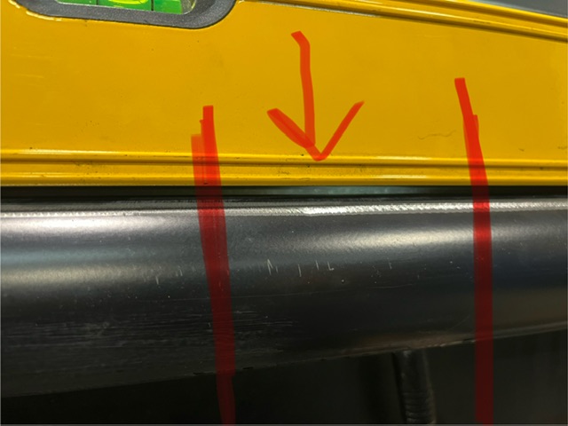

Update as of today.
My Y2 rail has a bow in the middle (see pic). I put my 6’ level in it and noticed there was a decent gap, about .065-.070”, I used feeler gauges to check this , the other side was much much less of a gap. So I decided to recheck the parallel for the Y axis’s. Low and behold they were not the recommended gap of 1.25” in between the rail and bed…… so I will be adjusting this and will get these numbers where they need to be.
Not sure how but obviously I did not measure correctly when I installed the rails….
So for now this is where I am at.

When I installed my Y access rails I used a string to make sure they were straight from one end to the other. Pictures show how I did it with string.
Clamp string at each end, get 3 shims all the same thickness put one at each end and use the third to measure with. Adjust the nuts in and out until your shim just touches the string.
you should be able to get them with in .015".

So my wife and I spent from 1:30-7:30 yesterday working on my machine. We started with checking the 1.25” gap on the Y axis. I had that measurement on one side and not the other from when I previously put the machine together. So we worked on that and this time got the numbers right, then we checked the distance in between the rollers, added the 1.75 and made both ends parallel within 1/32” on both ends, we ended up having to loosen the rail and rod mount plate because it was putting the rail in a bind. Once we got that right we went to the back to check the rod tension and completely readjusted those. Took both ends loose and started from the beginning. Once we had the tension correct (best we feel was correct) with about 3/8” of “play”. We then went to the X axis and did the same. We readjusted the rod tension as well and then we re-trammed the Z, we took the torch off and the clamping brackets. From how I initially set my Z up I do believe I have a bad bearing from being misaligned and to tight and or not set correctly. We spent some time getting that square to the slats and then redid the adjustment for the bearings. I will say this, the groove/line that the bearing had cut into the gantry tube that I showed in a previous post was NOT in the same position as before, now the bearing rides in the middle of that cut/groove. So yes, from I what I had thought I had gotten everything right from initial install was not done correctly……… hence the trouble I’ve been having with binding and not cutting square.
Once we put everything back together and double/triple checked things I went ahead and tested the X,Y and Z movement manually first, once that seemed fine I ran the Break in program, that was a success, no binding and loud chattering, then we went for a test square. Same material at the same spot with the same program. The square was still .030”-.040” big than the 3” I programmed in F360. Still leads me to believe that’s a programming issue. I then moved the plate to a different spot on the bed where I have t cut anything and recut a square, this time the measurement was more consistent on all sides within maybe .005-.007”. I can live with that to an extent.
