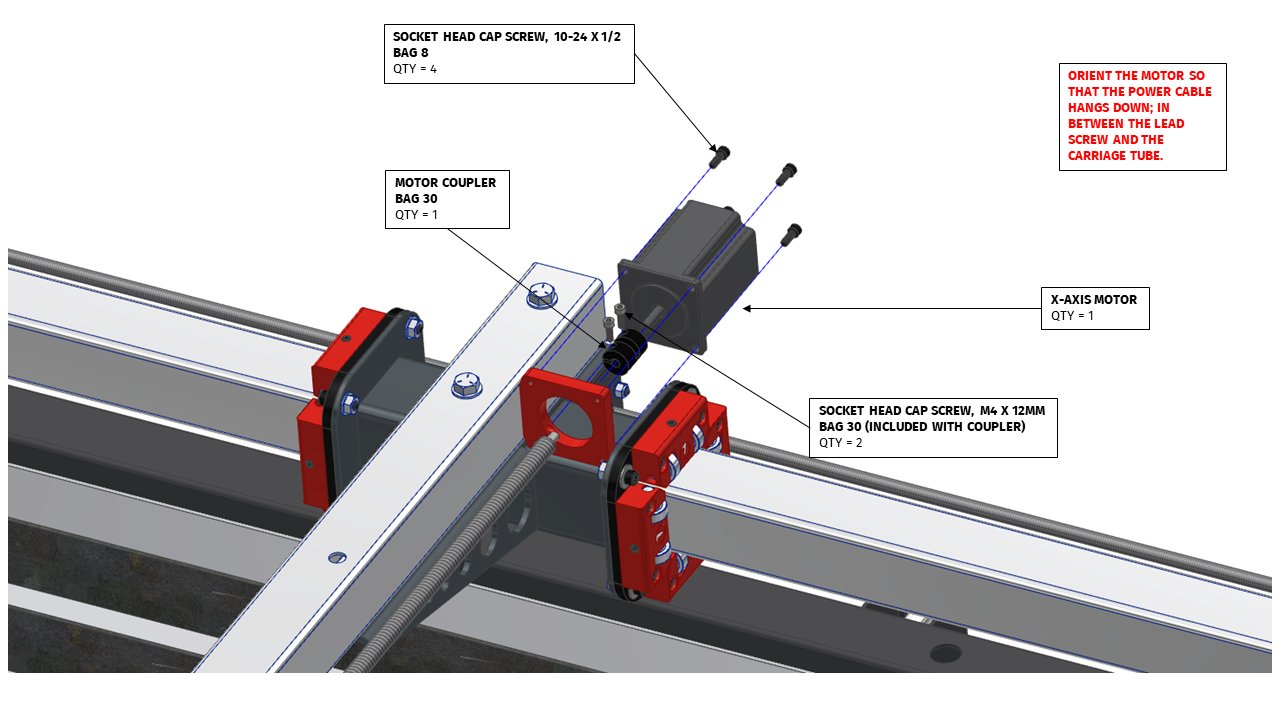

How did you route/attach your X-axis stepper motor cable ? there is no strain relief where the wires enter motor housing, and in instructions it was not obvious how to route and attach it (if at all) and keep it from catching, binding, etc.
I am sure I am just blind and not seeing a photo or something…

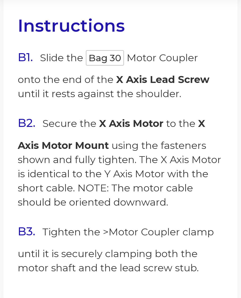

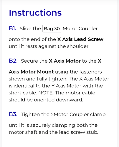

There is no strain relief or attachment points for the x-axis cable.
The only point that the manual makes is that the cable should be facing down.
Picsart_22-05-19_05-11-31-849
Myself I extended this cable and mounted it to the frame at the point that I extended the cable from.
My electronics enclosure is mounted up on the wall near my table.
Mine just hangs down between the weldment and the lead screw. Haven’t had any problems or concerns with it.
