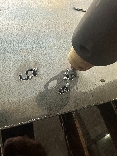

I have had my crossfire running for a while now without issues. In the past week, I started have intermittent issues with the X-axis motor. It will sporadically stop moving (loosing position) or invert the direction of travel. I was trying to cut a part this morning with several holes, and you can see the failure resulting in the machine instead cutting an “S” shape when the x-axis motor inverted the direction. I have had the same issue occur when manually moving the gantry from the user interface. The first time this happened, I left the machine off overnight and rebooted my computer and it went back to working without issue the next day. I haven’t been able to get it resolved this morning, so I am worried there is a deeper issue. I don’t seen any obvious issues, the machine hasn’t moved, and the connections are all solid. Any troubleshooting suggestions would be great!

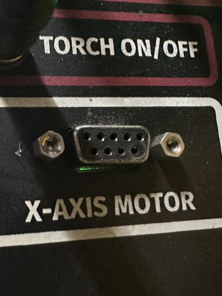

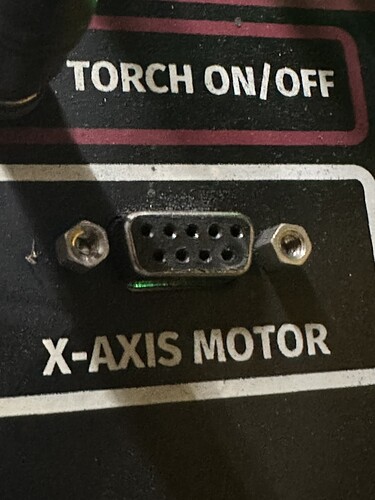

I did notice what appears to be some corrosion on the back of that DB9 connector that wasn’t present on any others. Nothing else appeared odd internally. I also checked that the electronics enclosure was isolated (it was) and that the power supply was outputting adequate voltage (it was at 36.28V).
I did re-clean and cycle the connector a few times. The screws do appear long, but I attempted to carefully adjust them without over-tightening. After reassemblying the machine worked briefly before the issues restarted. It does seem like manipulating the connector while jogging the machine can trigger the issue. This would suggest either an issue on the motor and cable side, or something inside the connector that is more subtle?
Any suggestions on something I missed or on next steps? Replace the panel mount DB9 connector? Thanks!

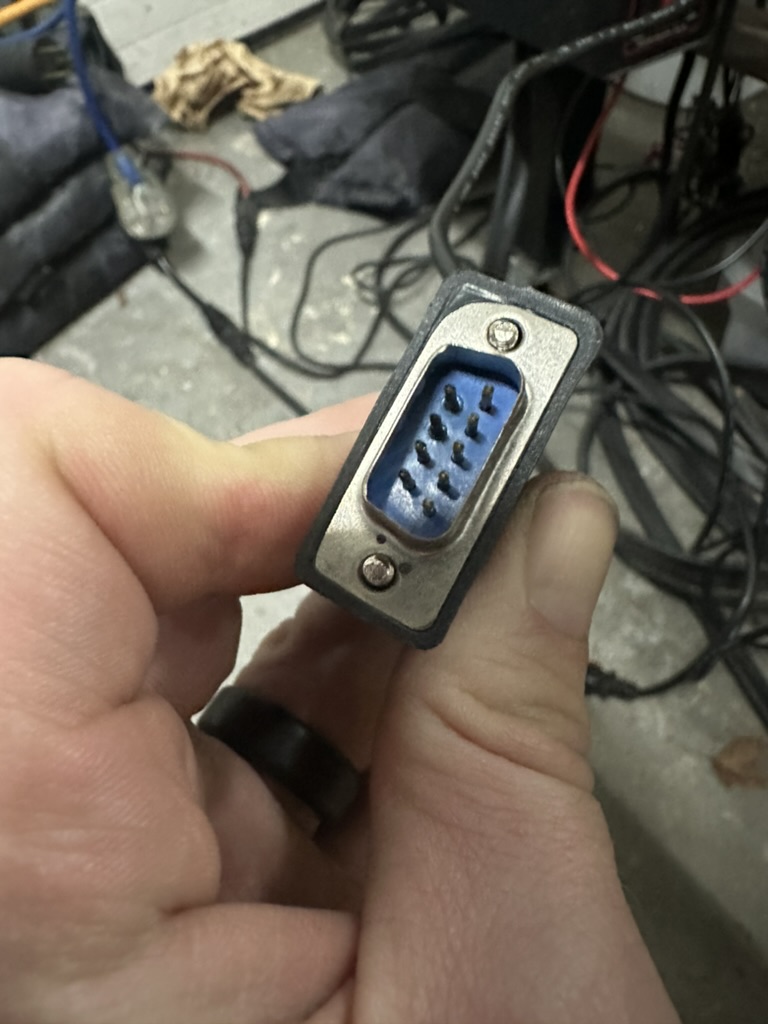

It appears as if two of the pins have some residue on them and that would cause your failure mode.
Personally, I would replace both sides of that connector. There must have been some spill on it to rust like that. If you don’t have replacement connectors, then use an emery board to scuff the pin on all sides and use a twist drill, the same diameter as the pin, to clean the socket.
I agree several of those pins don’t look so good.
It does look like the control box took a bath at one point.

That USB connection has a nasty build-up on it.
It has gotten wet more than once.

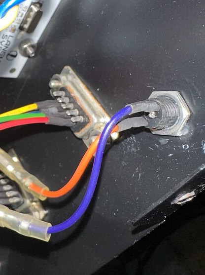

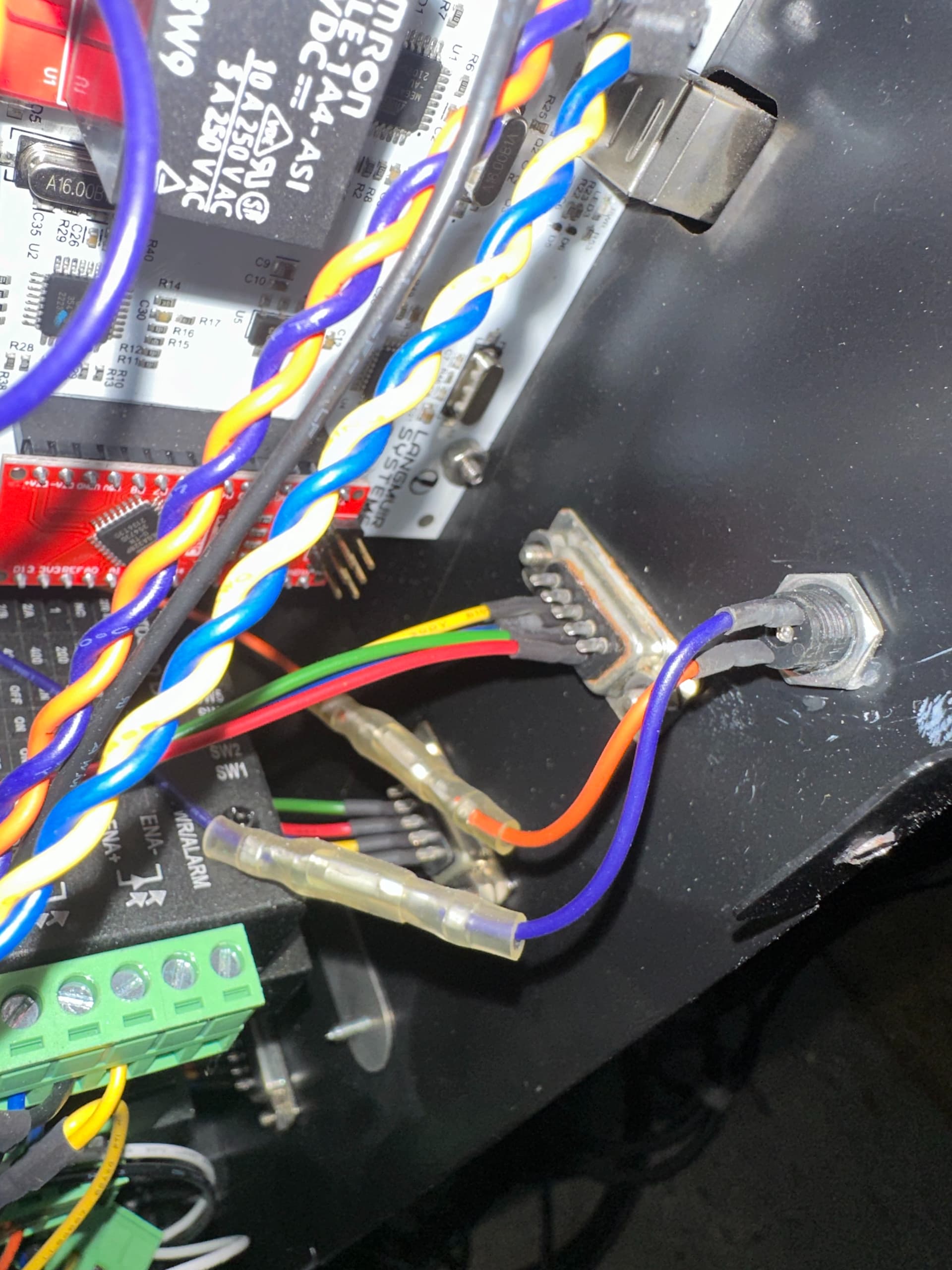

Replacing the panel mount connector should be easy enough. How would you recommend replacing the motor side of the connector?
Any suggestions on how to better protect the enclosure when there is a water table?
It should be a simple wiring issue. Just match the colors to the correct pins. I would love to know if it is the problem first. Maybe a small wire brush and some contact cleaner.
Or if you are going to replace it, just cut the wires and butt use connectors till the connector gets there.
