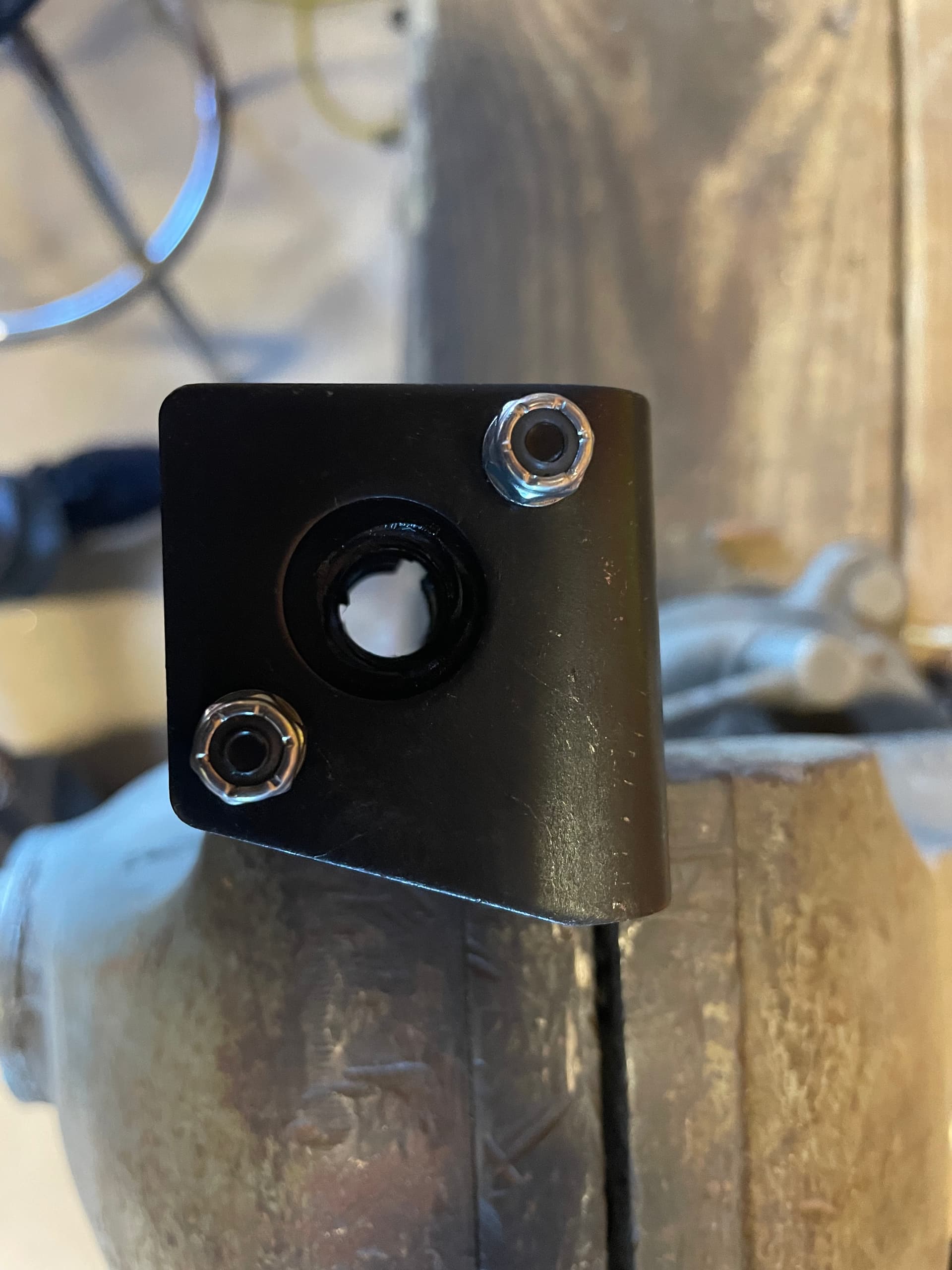

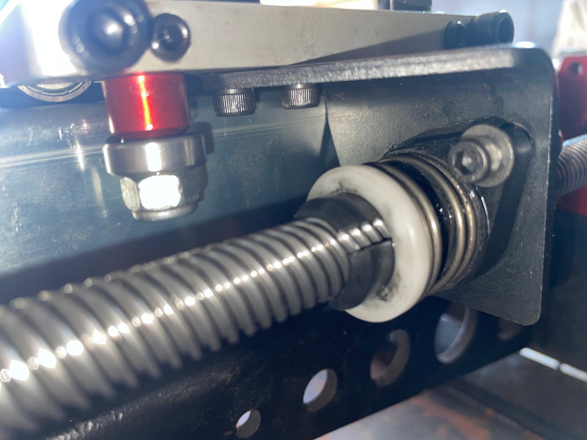

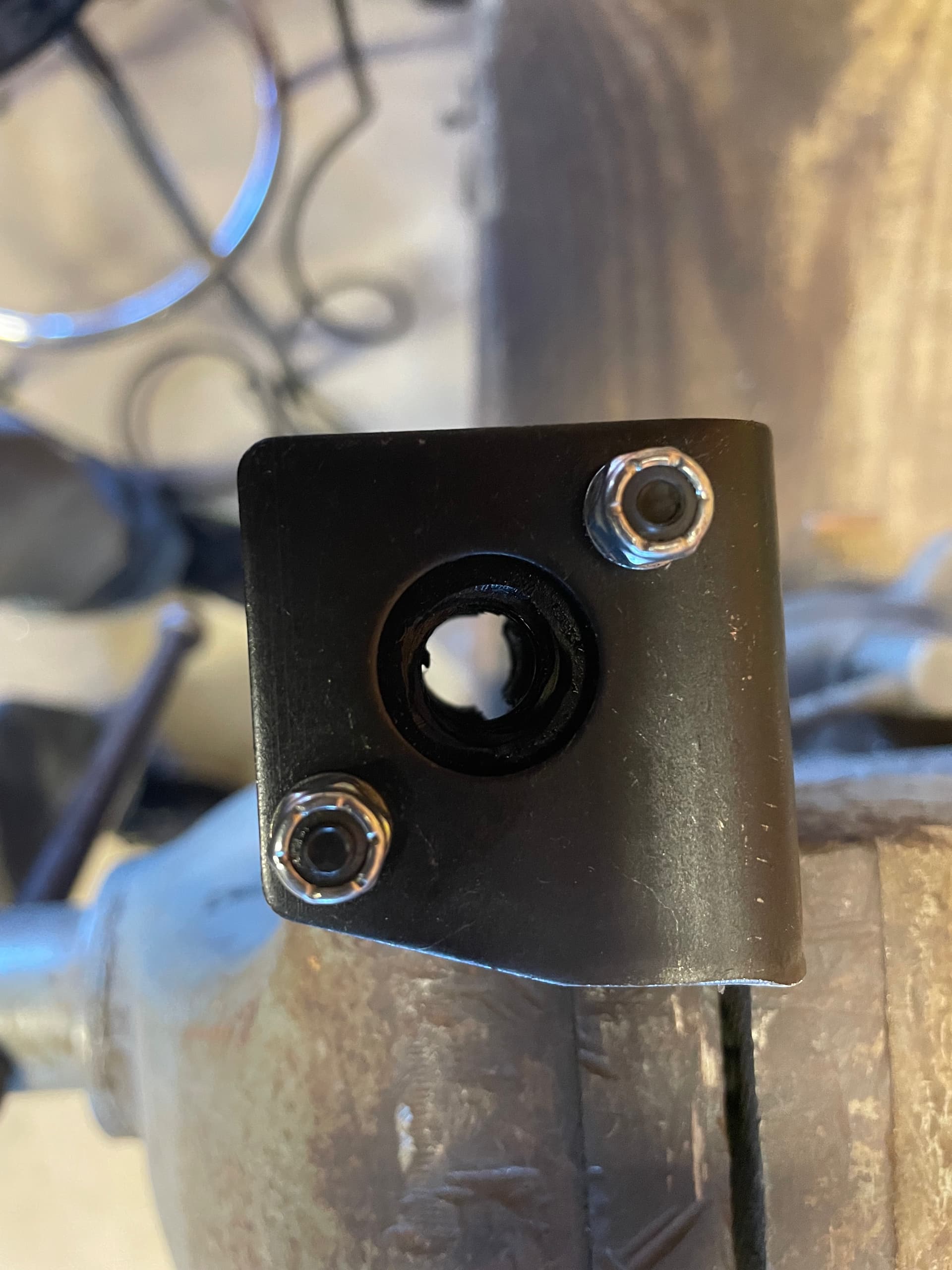

Hey, I feel I should add an update to this incase anyone has the problem in the future and comes across this thread. There were actually two problems that I had, and here is how both were corrected
  1. Problem: Wobble in Carriage
Fix: properly tram carriage so it doesn’t bump the nut underneath the 2x2 tubing (thanks ds690)
  1. Problem: Constant sticking of carriage randomly throughout X-Axis.
Fix: Remove lead nut bracket and grind away where the metal was making direct contact with 2x2 tubing (not an issue when carriage is loose, but does touch and drag down the motor when carriage is trammed). After grinding down the piece, I painted it with some black and Rustoleum paint).
thanks to all who helped solve the issue! It’s cutting better than ever now :slight_smile:
pics show 1) Bracket making contact on tubing 2) Bracket removed 3) bracket after grinding it down using a flap disc. No more issues and carriage moves easily
