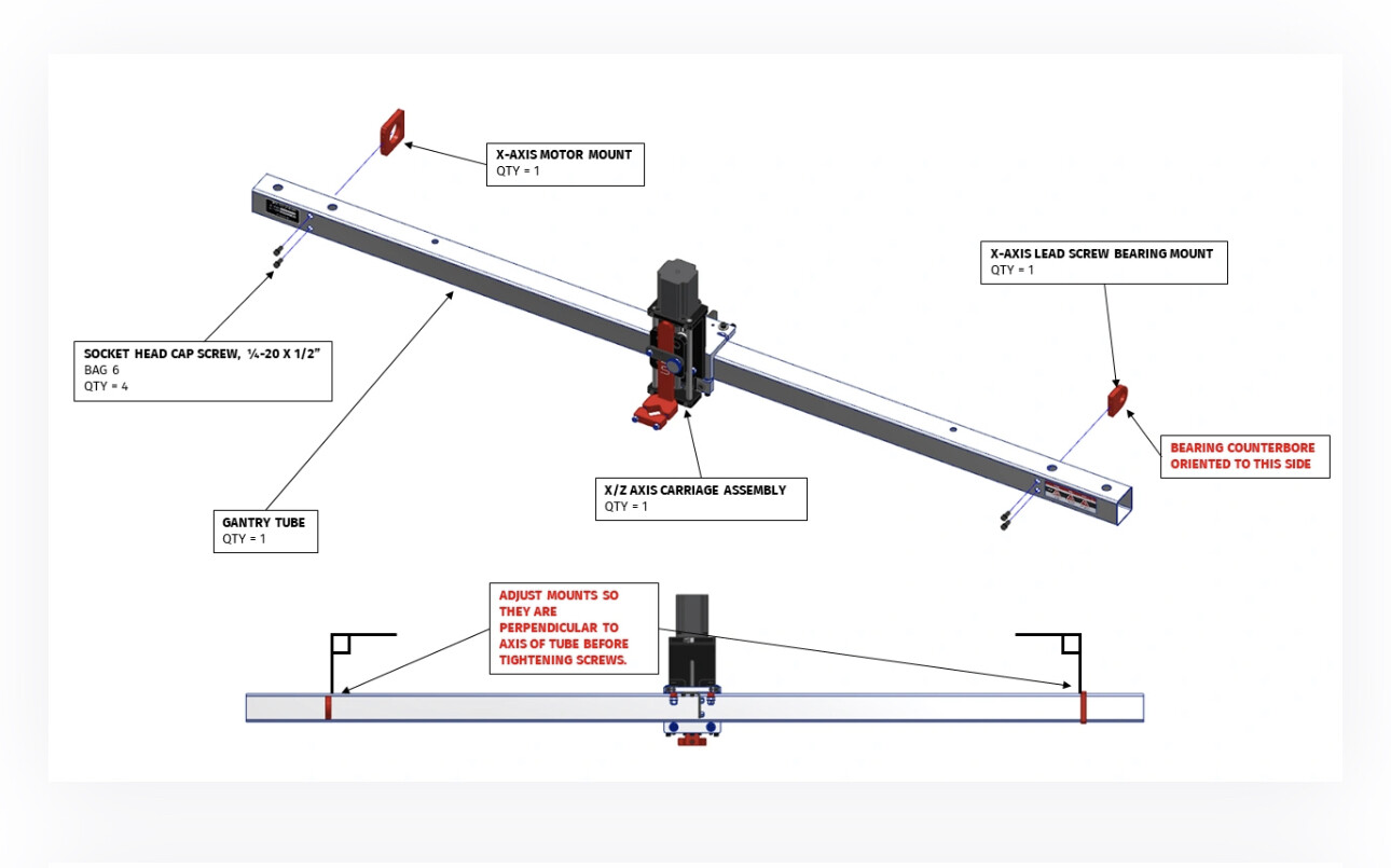

X-axis bearing mount holes are off
I am assembling my pro and when I went to screw in the bolts to mount the x-axis bearing mount. The holes on the x-axis tube seem to be farther apart than they are meant to be. The holes do not line up with the x-axis bearing mount holes. Am I missing something or is this a defect?
Are you sure you are using the correct ones? There are two different bearing blocks.
They state the the x-axis should be the shorter ones. That’s the one that I used

Please send us an email at [email protected] and ask for Jeff. I will make sure you get the parts you need.
Thank you, placed an order and already received and installed.
