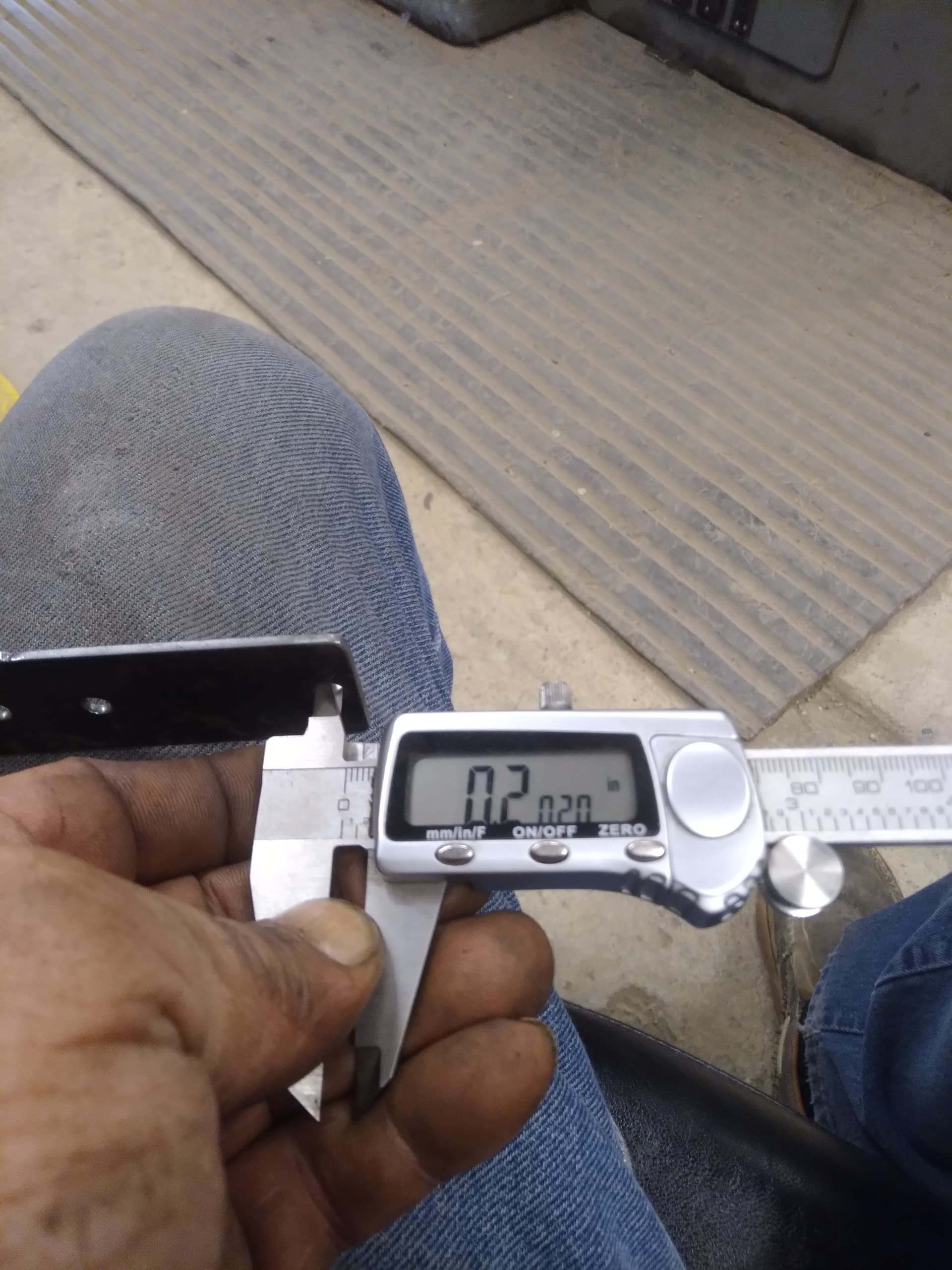

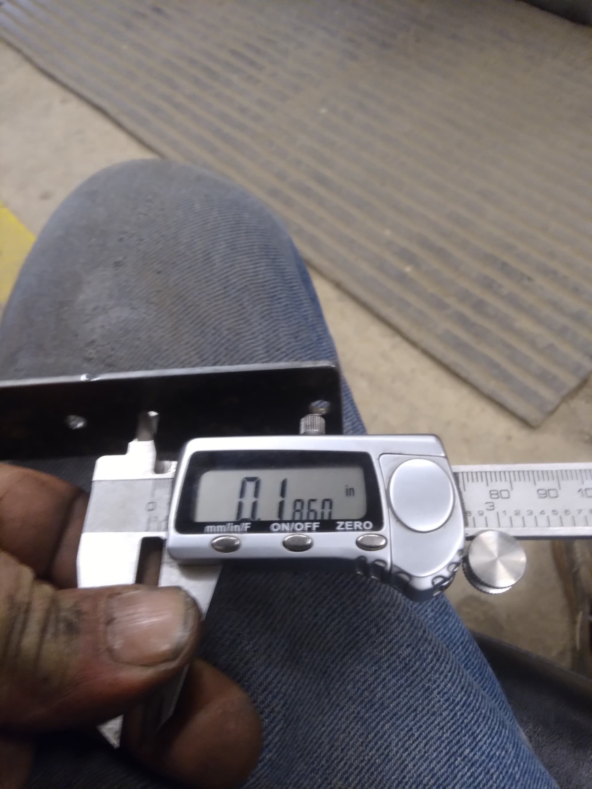

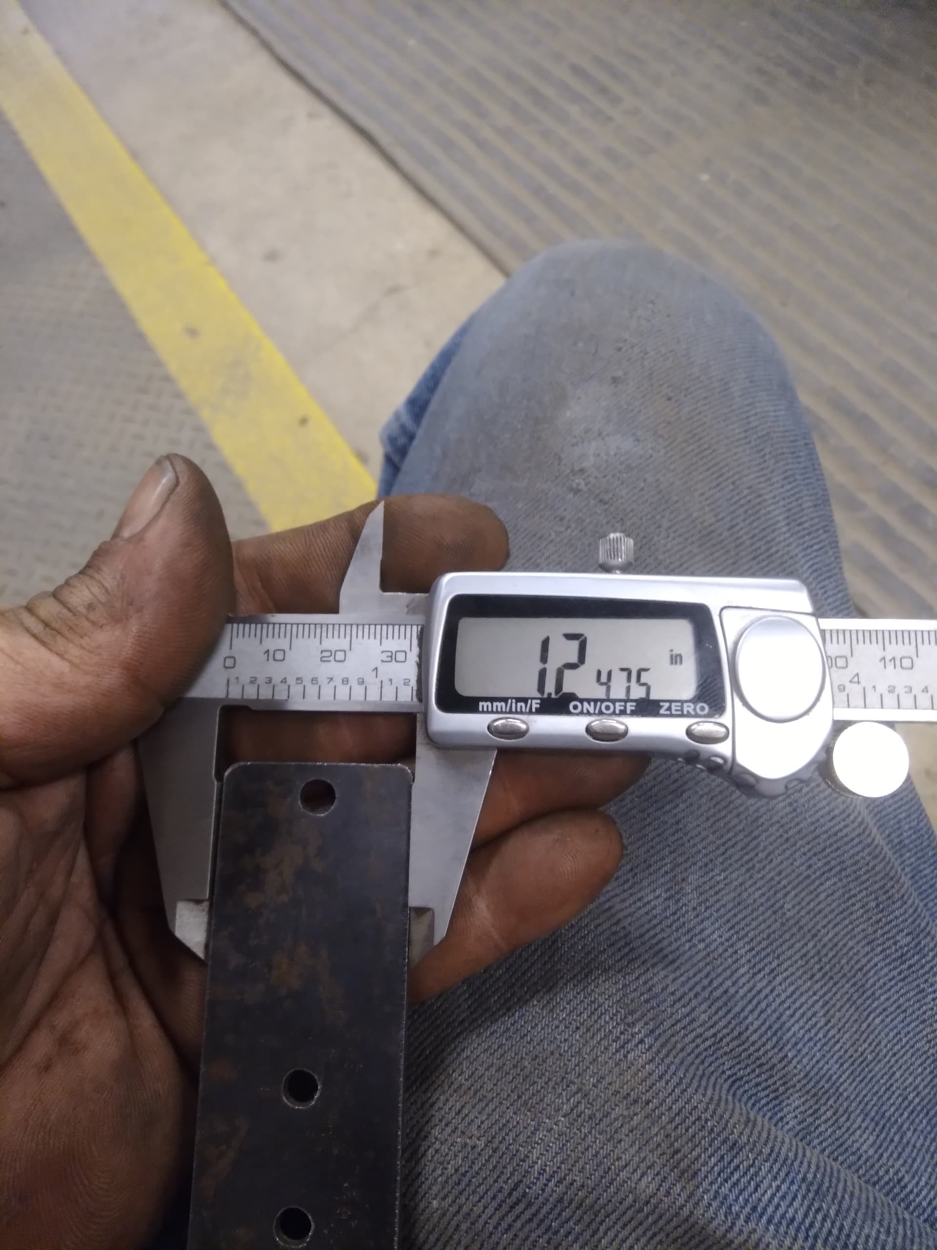

Well, I’m close. Take a look…
Should have been .1875
Should have been .203
Should have been 1.25
Not too bad in my book! :slight_smile:

Tweak your kerf to 0.042 and you’ve got it! Great!
EDIT: Change 0.047 to 0.042. Went the wrong direction… :flushed:

@TomWS If I need to move .001, wouldn’t I tweak it .0005? :slight_smile:
Whoops, I got thrown off by your caliper readout with the larger size numbers thinking the first digit was units, not tenths. Scratch my suggestion, these are very good results.
