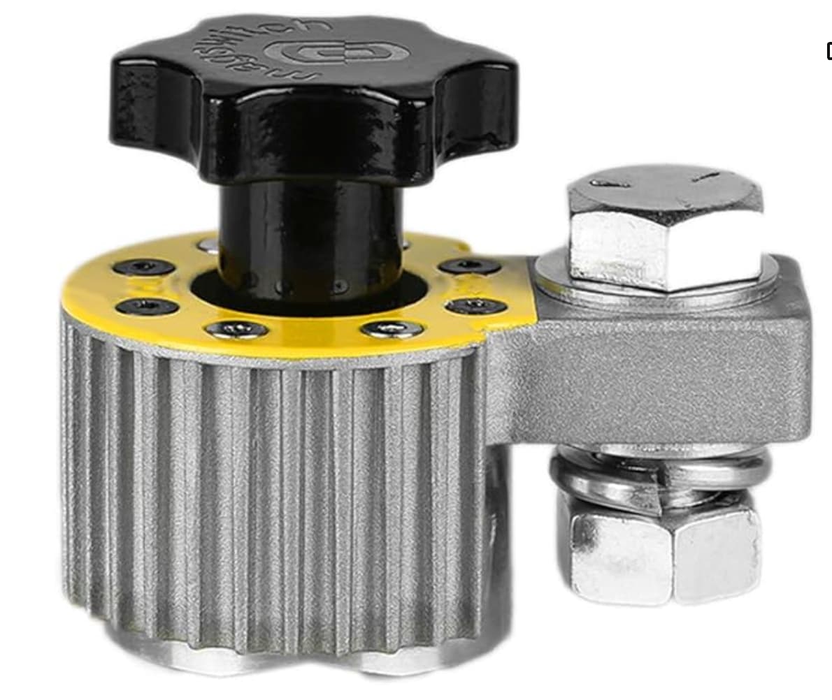

I use one of these.
Really simplifies attaching to steel, of course stainless and aluminum are less effective.

Doesn’t work so well on stainless, but yea, for ferrous materials, a GREAT addition

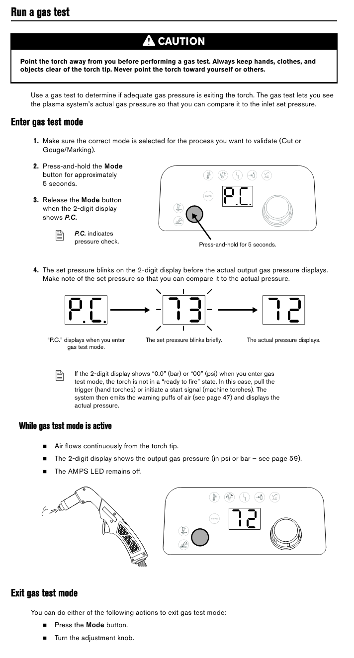

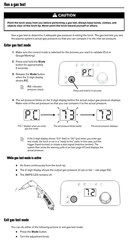

You might check the actual air pressure that is getting to the torch by following these instructions:
If you need to, this is how you would adjust that internal air pressure:
You can always clamp a pair of vise grips to your sheet then attach to that with magnet
I also like @mechanic416 suggestion
I like that idea Knick!

My question was related to the plasma cutter: Did you check the internal pressure reading?
