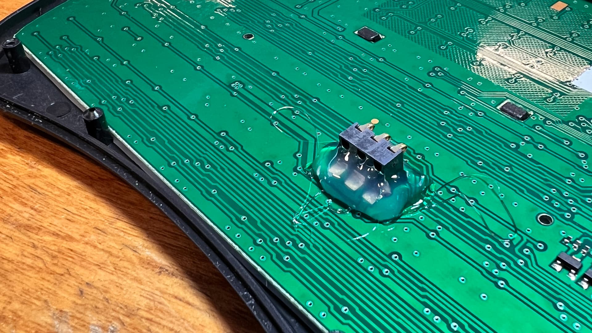

anyhow first jogs around setting the limit stops the pendant failed and found this thread.
Re-soldered the failed joints and it works again.
I would just add that u might want to add hotmelt glue around the battery contact part to reinforce it. Ideally before you put the battery in. I’ve done quite a lot of cad work on electronics enclosures and pcb and plastics and it is absolutely totally not ethical to use solder joints as a structural element in the assembly. The force from the battery contact springs pops the module off of the board. There should have been a little plastic rib or something in the enclosure to support the plastic pcb component.

Same issue, mine had very little solder and what was there was cold jointed. Embarrassing, even for China.

That being said I absolutely disagree with the decision they made to use the spindles they had made with the incorrect threads. I don’t know how many units they had made and I don’t know what their backend looked like at the time but it would have been the right thing to do to scrap the spindle shafts and had them remade, correctly. The other thing they did I absolutely disagree with is they left all the markings on their nuts indicating they were standard nuts, which they clearly aren’t. It bugs me so much that I’m going to make a new one myself with the industry standard threads and fix what they should have. But I also have the tooling and materials to do it, all it will cost me is time. I most certainly understand not everyone has that capability. I also understand that I can’t rely on Langmuir to fix my machine for me. For what I paid, they did their part. If I have a warranty issue all I expect is that they honor what they offer, as long as its covered. A loose solder joint on the pendant took me all of 10 min to fix while I was waiting for something else to finish. I consider the MR-1 the HFT CNC in my garage. Its a hell of a lot better than what Amazon had for sale :stuck_out_tongue_closed_eyes:

Send it back. They will send you a new one. They are not all defective. Maybe 1 in 20. I realize its a pain in the butt. I’m sure they will upgrade when the 500 they own are gone. I personally have two of the original ones. Though I don’t like it feel or operation, they both still work.
