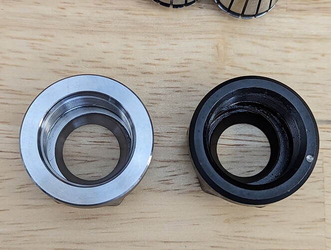

I received a technics ER20 nut and 1/2" ER20 collet a few days ago but haven’t yet tested it for runout.

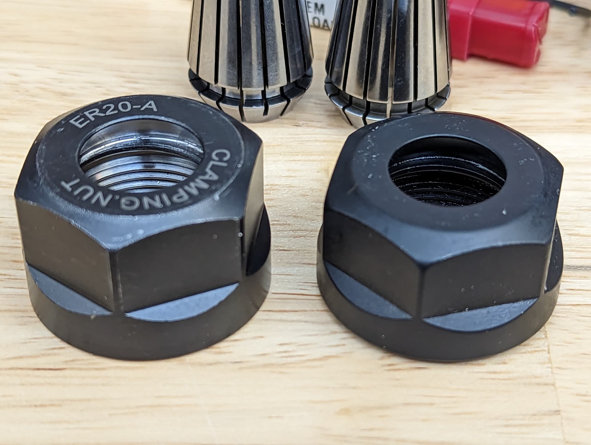

Techniks and Langmuir ER20 1/2" collets and collet nuts. I haven’t yet checked the runout on either.

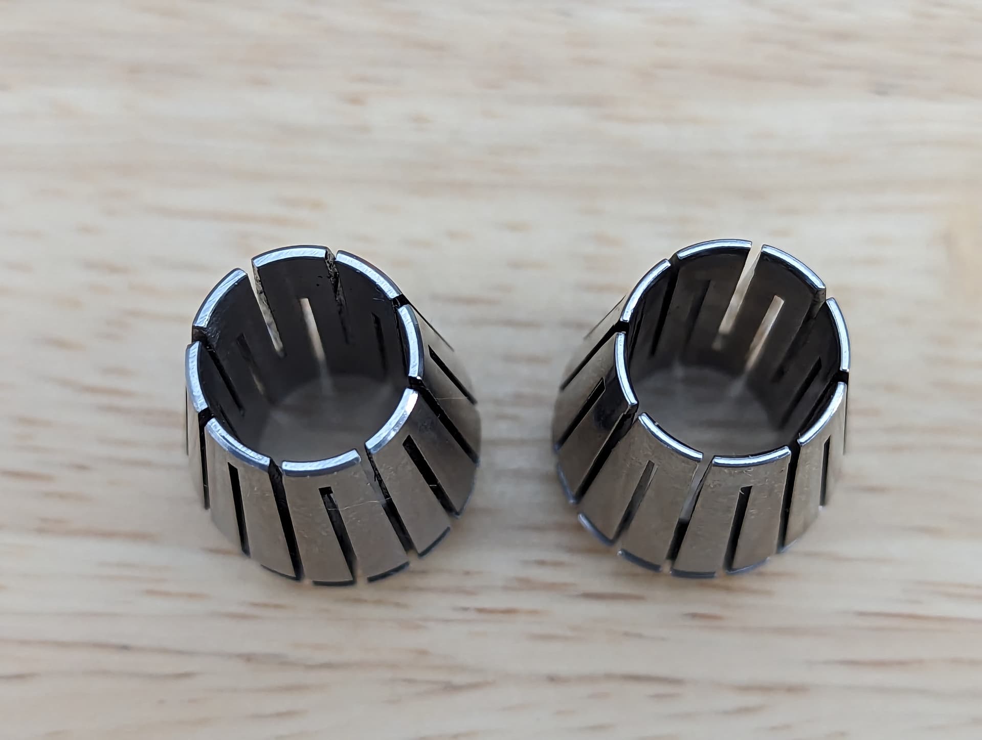

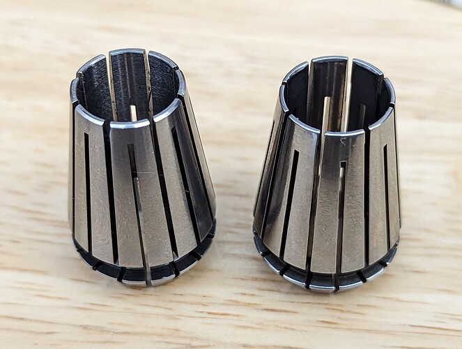

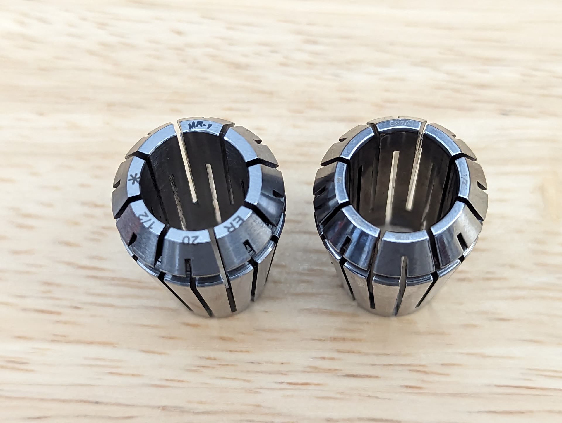

Having only looked at the technik ER20 I can say a few things.
The markings in the techniks are difficult to see, as I expected from their ER32s.
The metal gauge is obviously thinner and they seem more compliant when squeezed by hand. I don’t know if that is good or bad. I suspect the technik would have more clamping range.
The interior surface finish, purely by eye, seems to be a lower RA on the technik but this is comparing a slightly used collet to one fresh out of the box.
I was able to clamp .031" shank with my .062" technik collet without issue, and without too much effort (likely due to the thinner steel), it ran true and it seemed to spring back to size afterward…don’t know what it would do over time.
