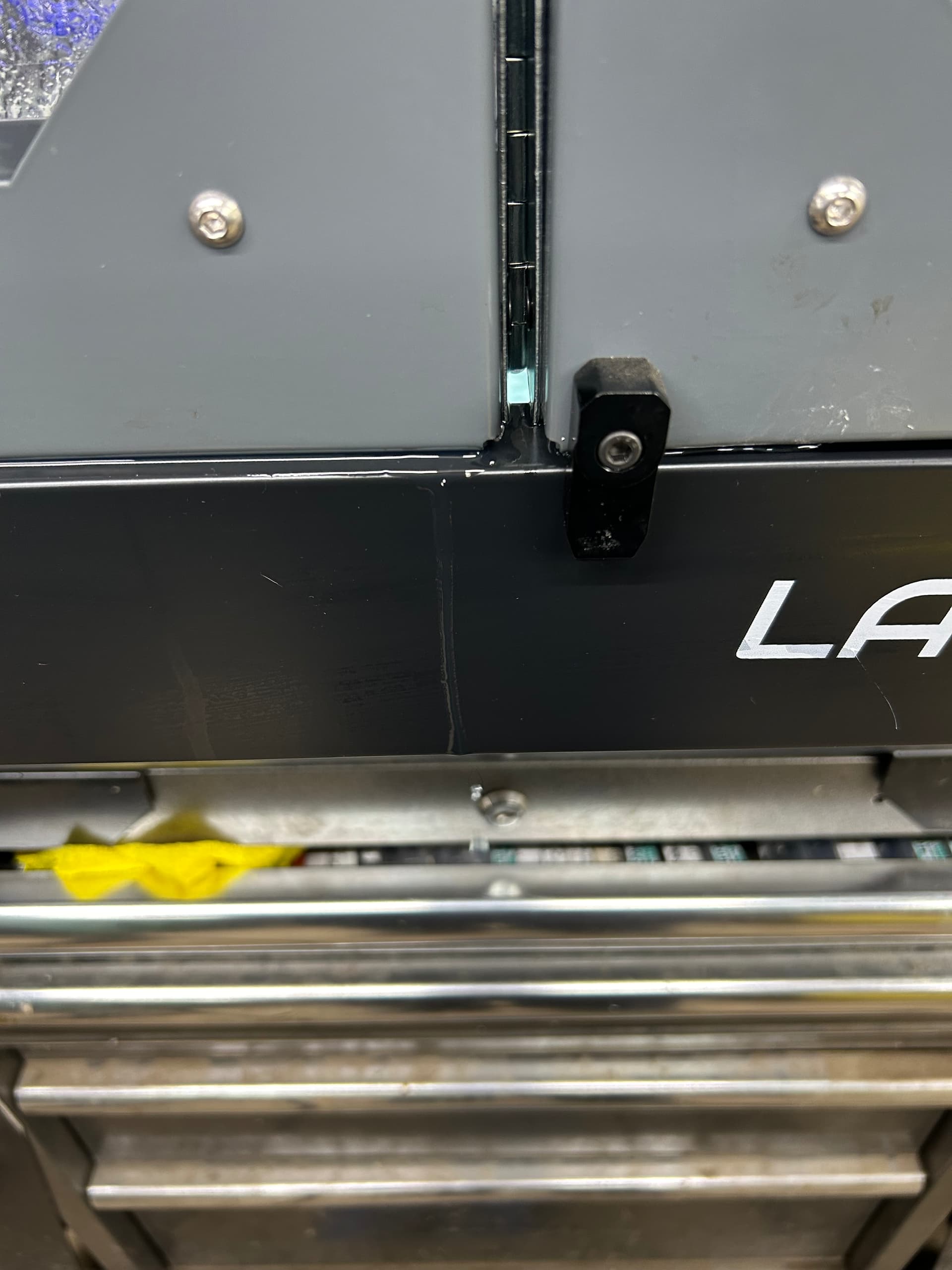

Whats everyone doing for leaking coolant by the door

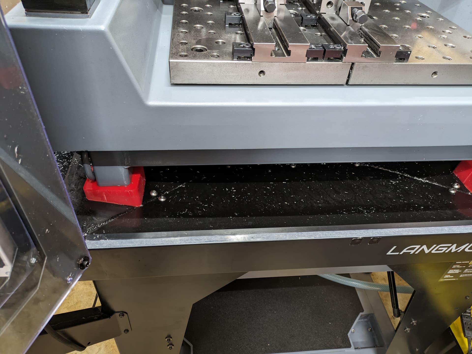

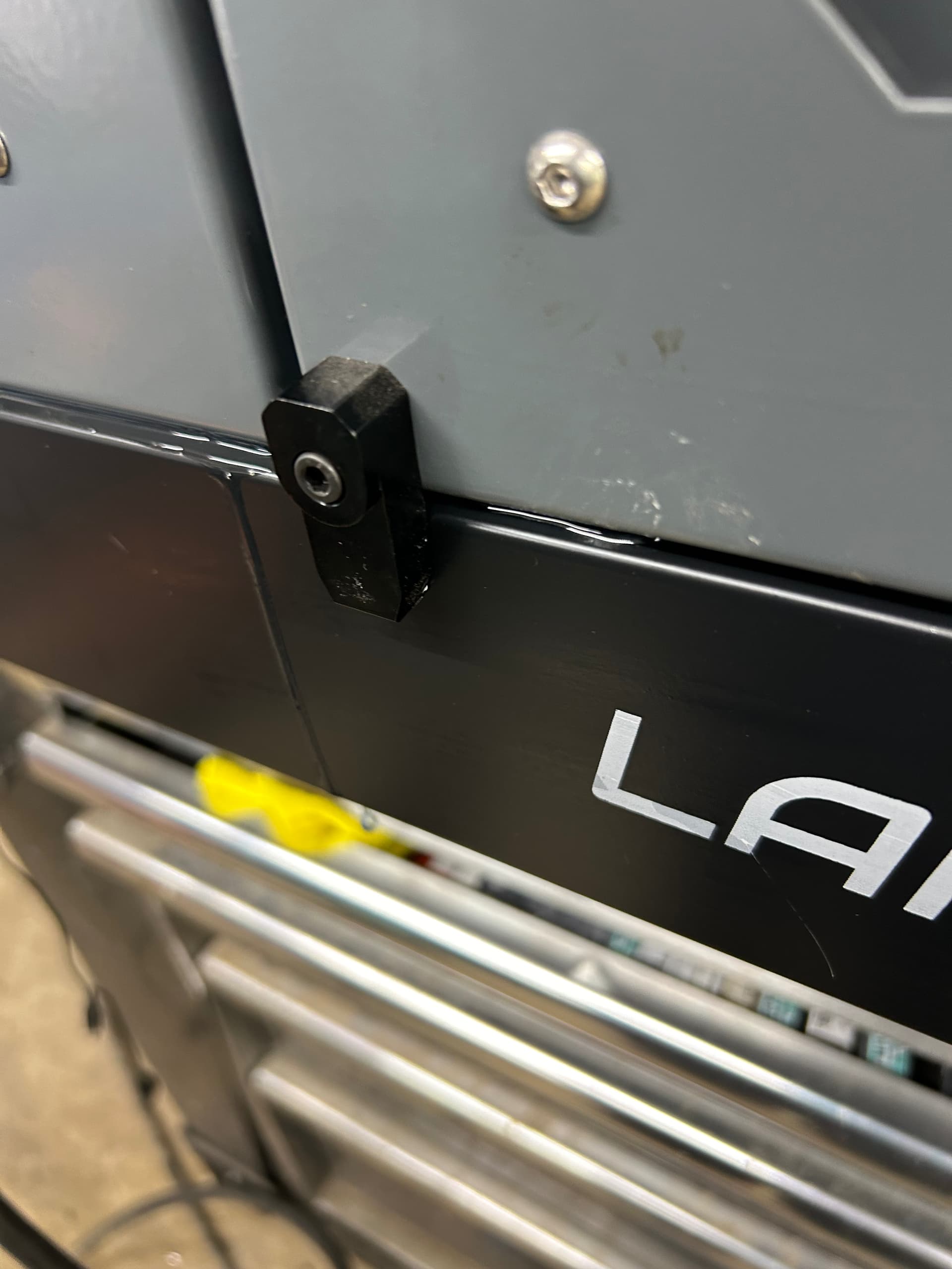

Already added the 2nd set of interior windows in the door, and switched to the bifold door mod. still getting a bunch of coolant between the door and enclosed. Just curious if anyone has come up with a better seal.

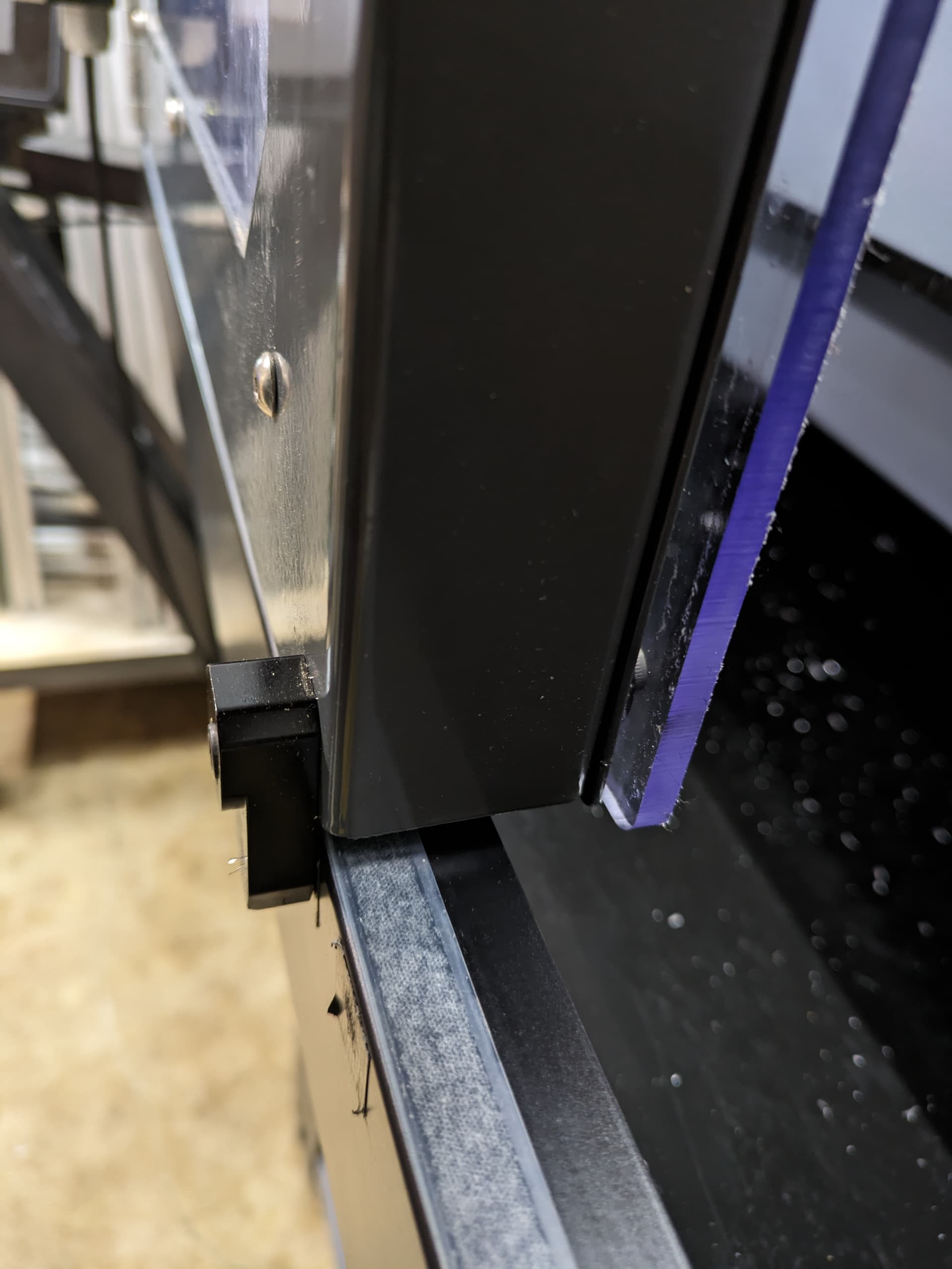

I put a piece of adhesive silicone sealing strip on the lip. Plus the overlapping door mod (covering the back side of the doors with polycarbonate sheet) to reject splashing coming through the gap.
It doesn’t form an actual seal with the door - it’s just tall enough to guide coolant to the sides of that flange.
