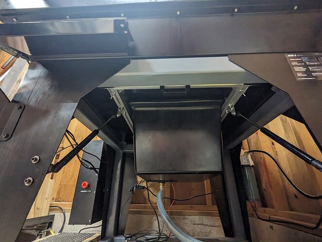

A hose. I don’t have water in my shop and wouldn’t want to rust the machine anyway, so I have a small auxiliary diaphragm pump wired to a foot pedal. Plumbed into my coolant sump.
yah but how do you get the chips out? With the enclosure on its next to impossible to get the chips from the back left and right.
In my machine, chips and coolant flow into an intermediate catch bin, before the coolant siphons into the sump.
I just dump out the catch bin every once in a while.
