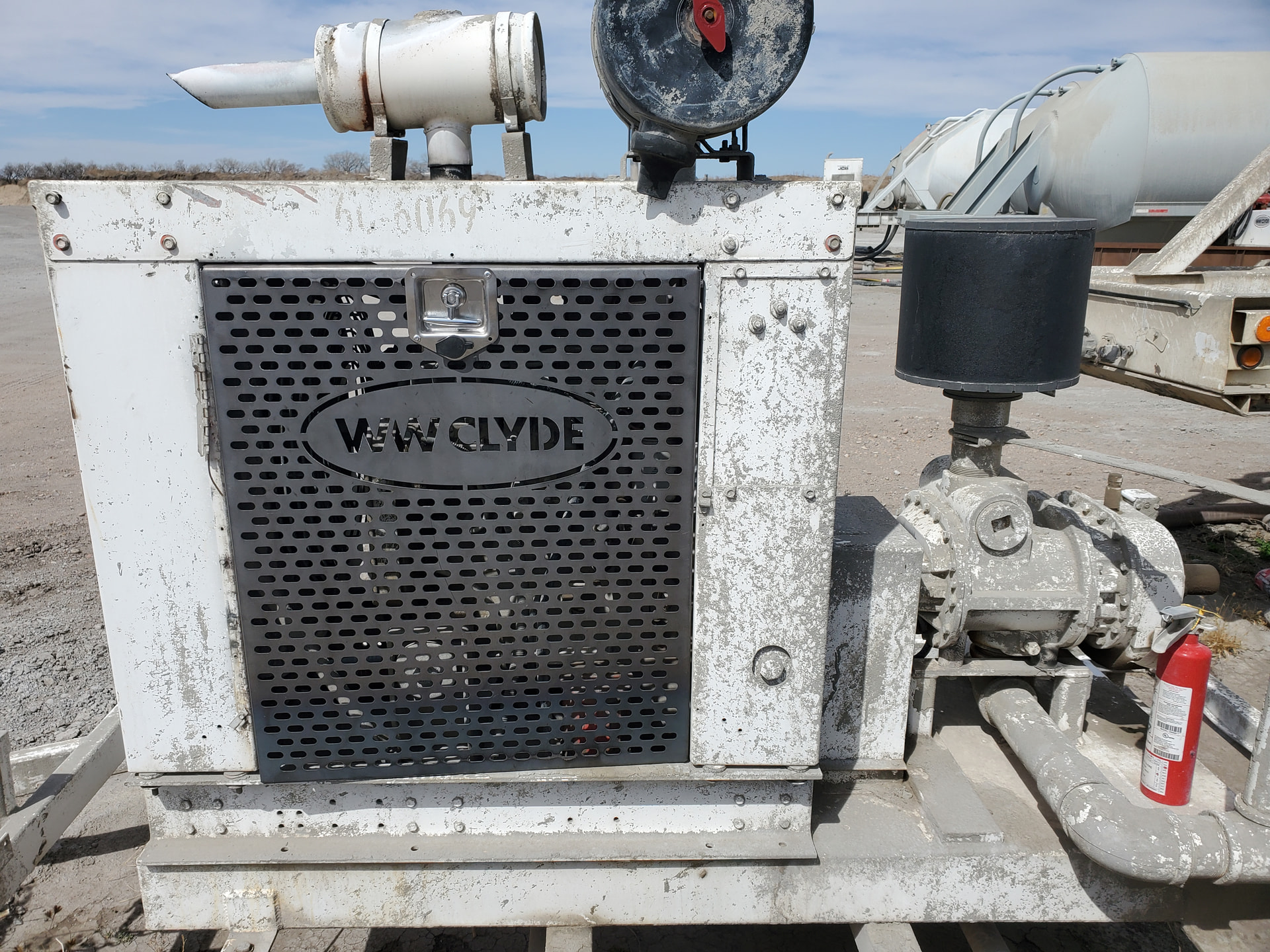

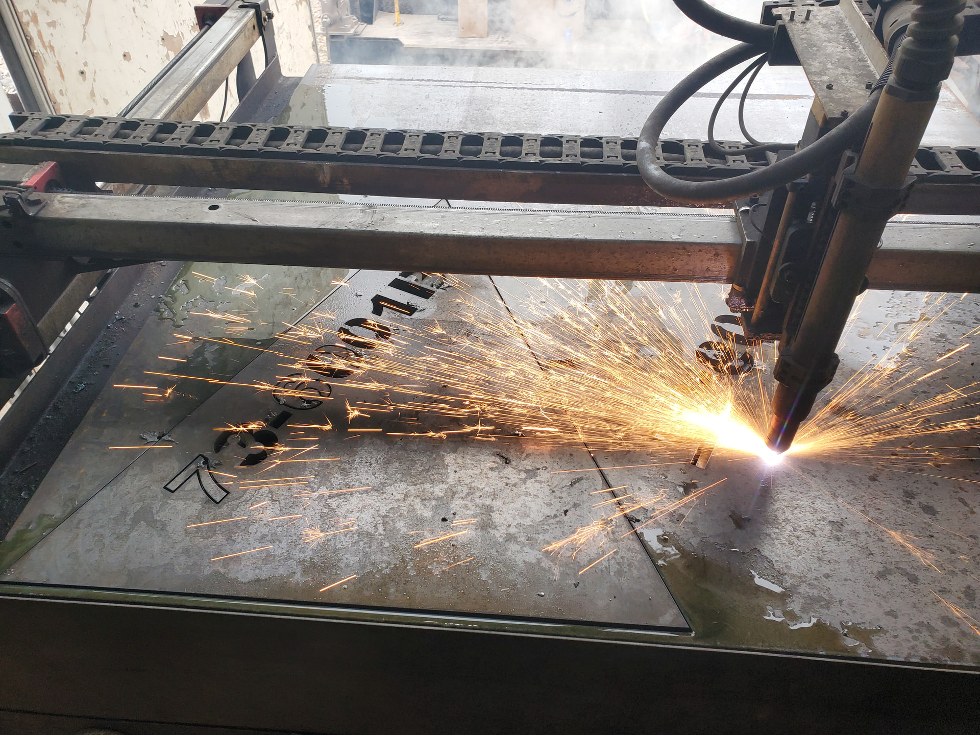

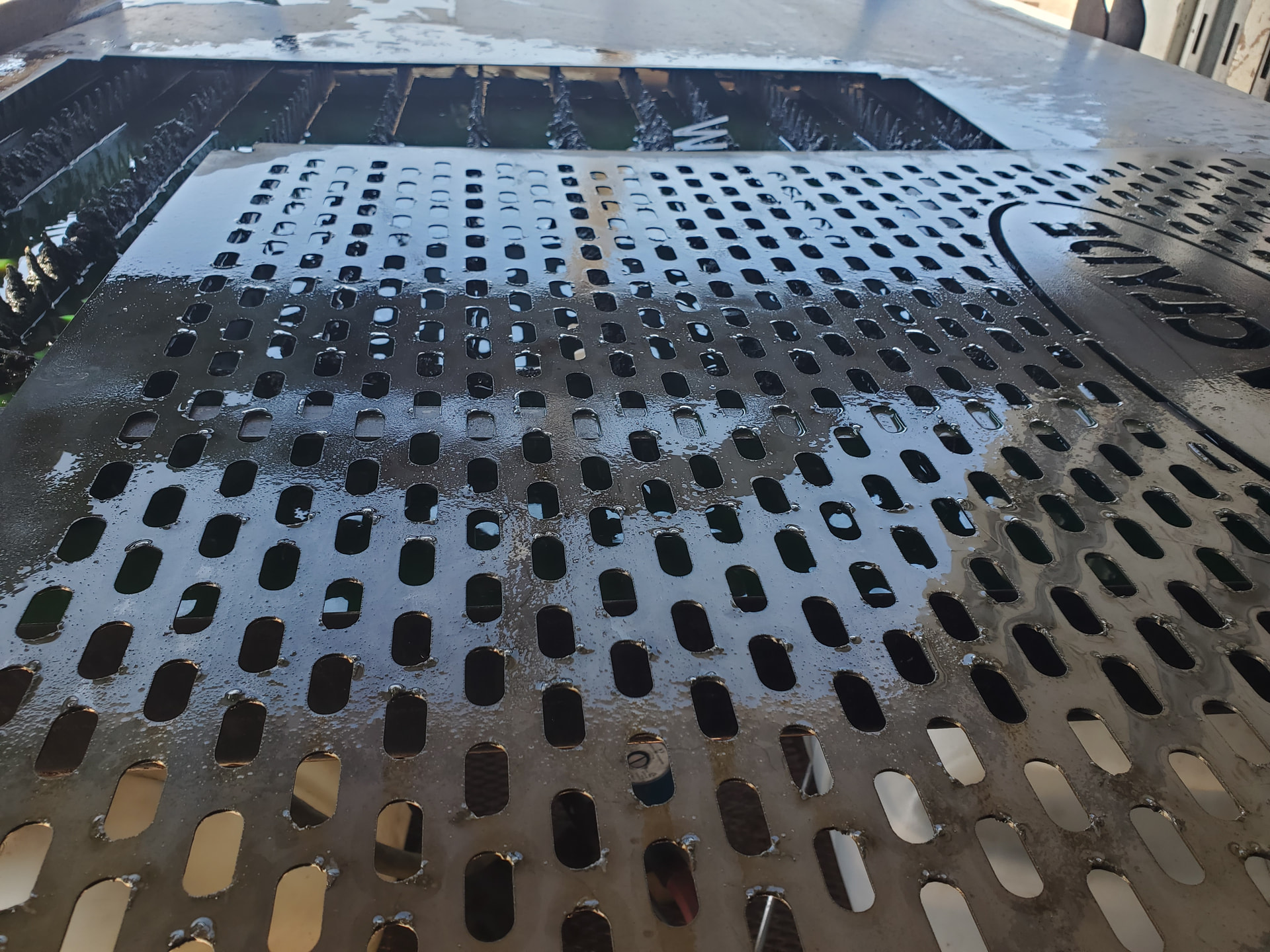

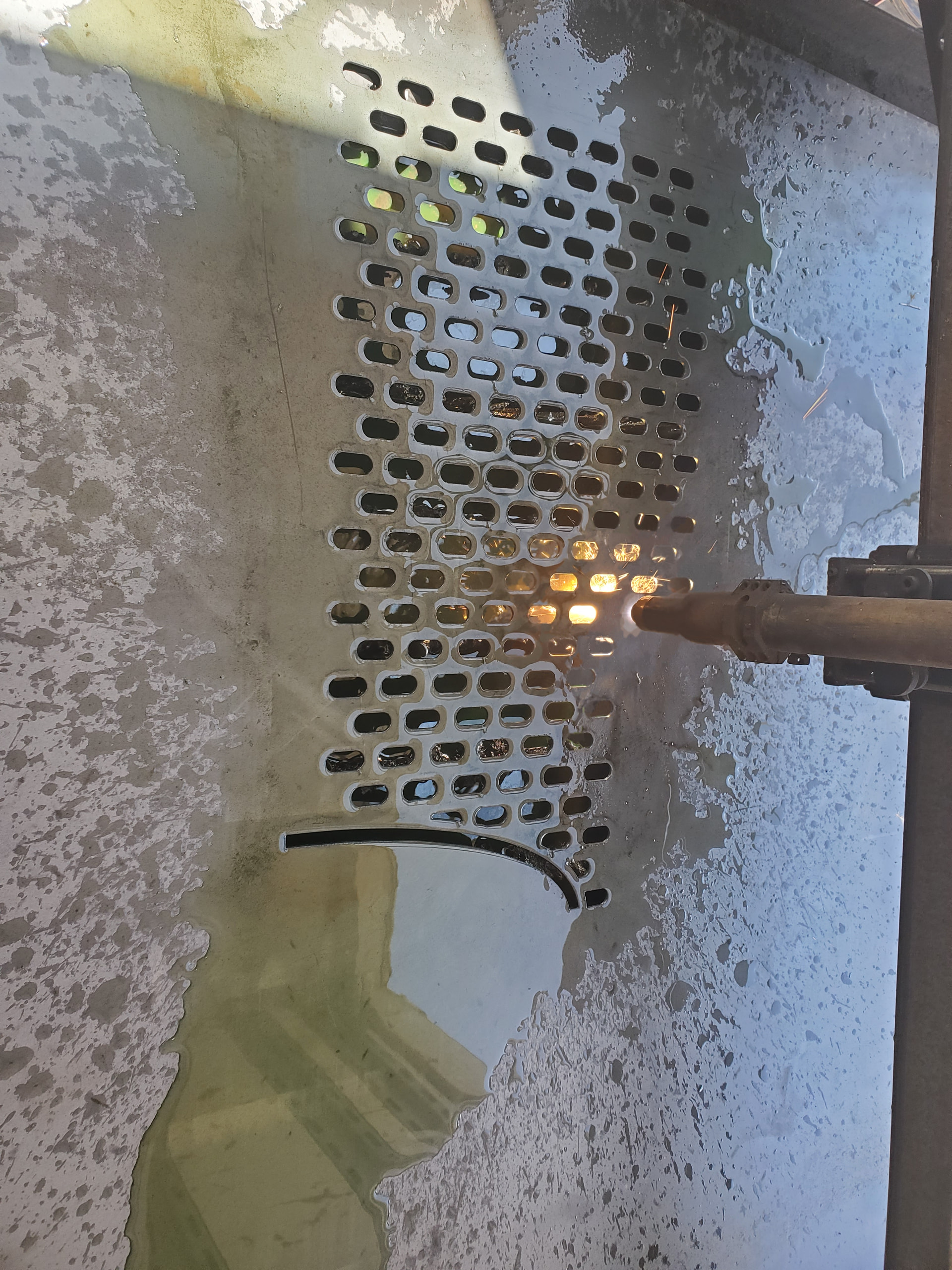

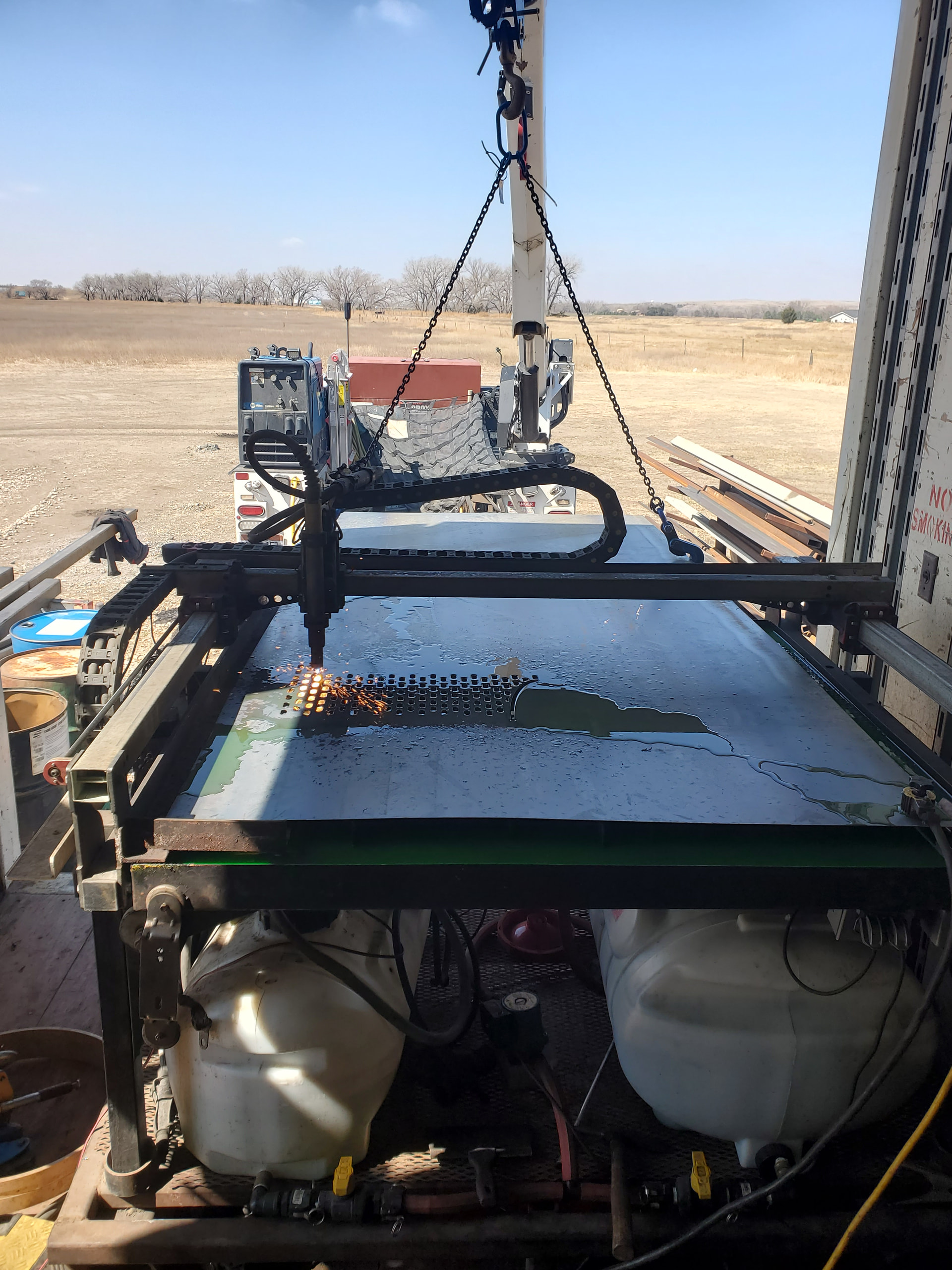

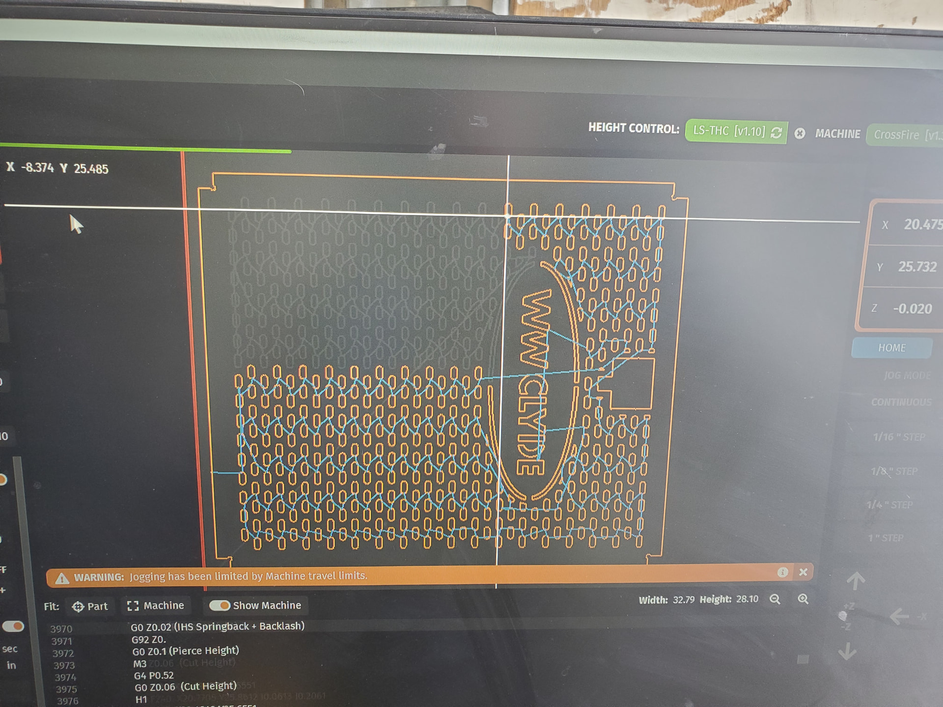

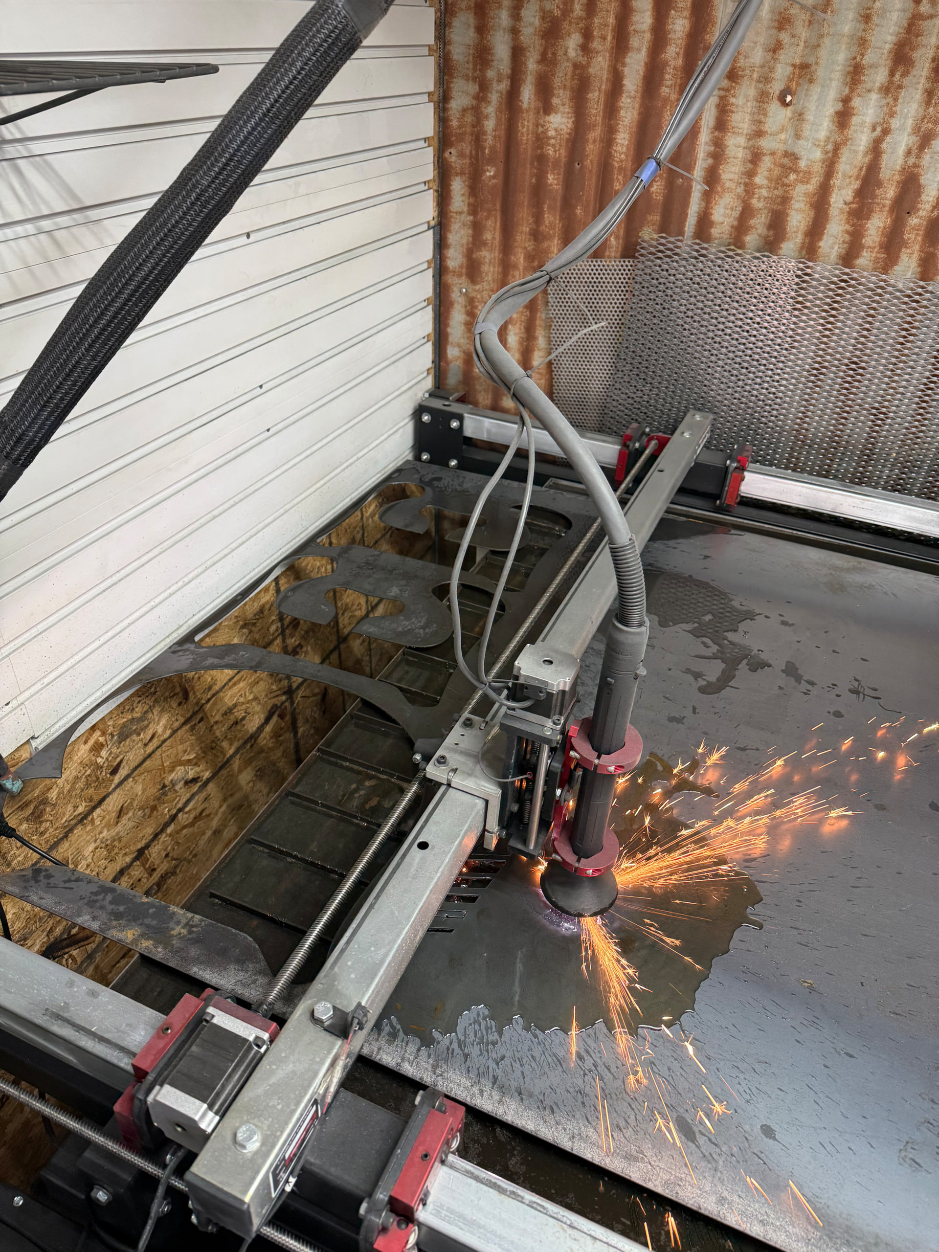

The first of 4 compartment doors for a cement blower.
I will try to get a count on the number of holes.
Next to nothing for dross on the back.
Hypertherm PowerMax 1650 g3. 48 amps. Fine cut consumables. 240 ipm. Air pressure somewhere around 75
Finally got one most of the way finished and test fit. Four different units, eight total doors not six. On the way over to one of our guys that’s doing the painting.
Little bit of a delay while trying to find somebody in the area that had a Bend break big enough to do 38 in of 16 gauge. No luck. So I had to make one.

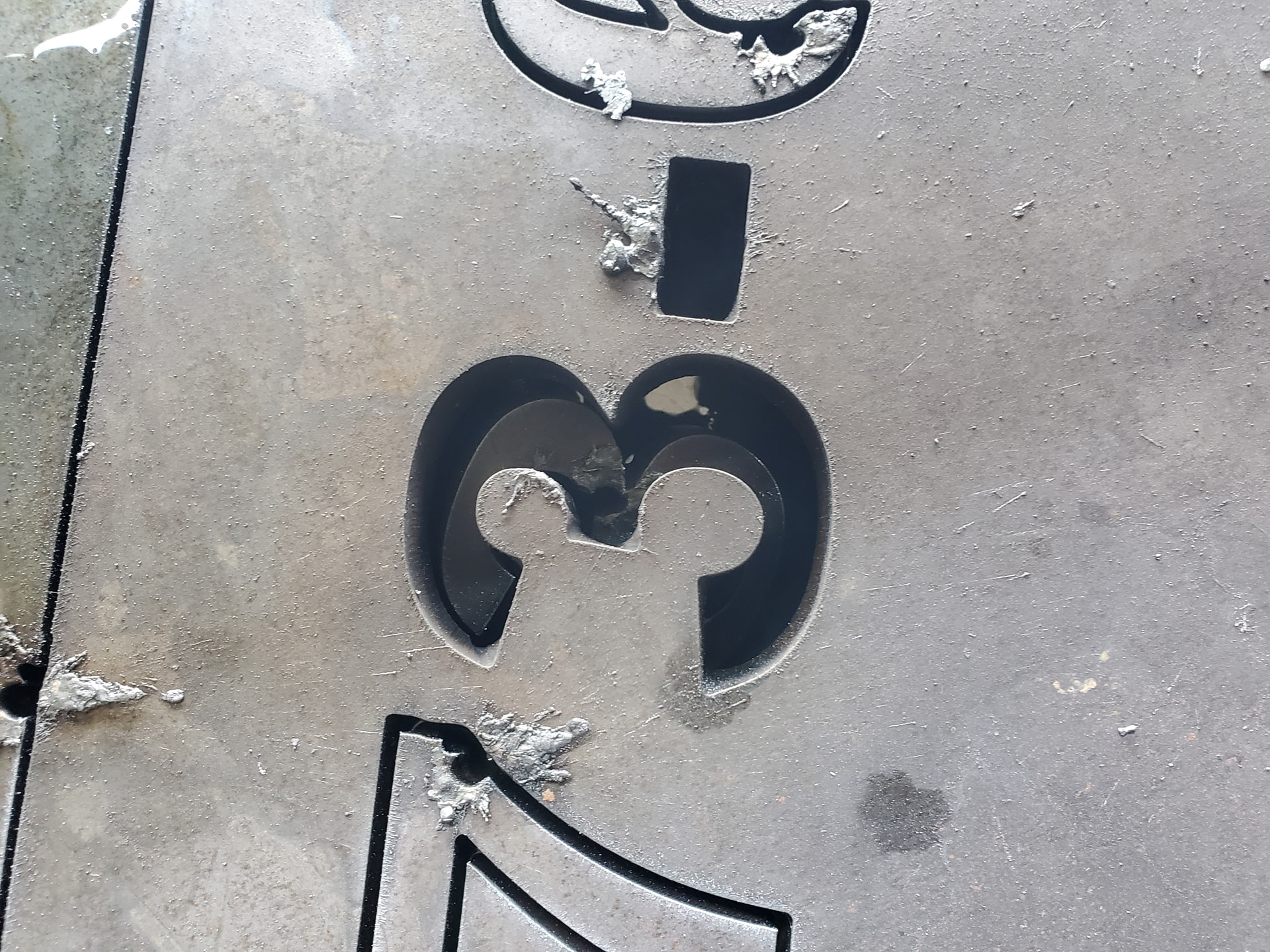

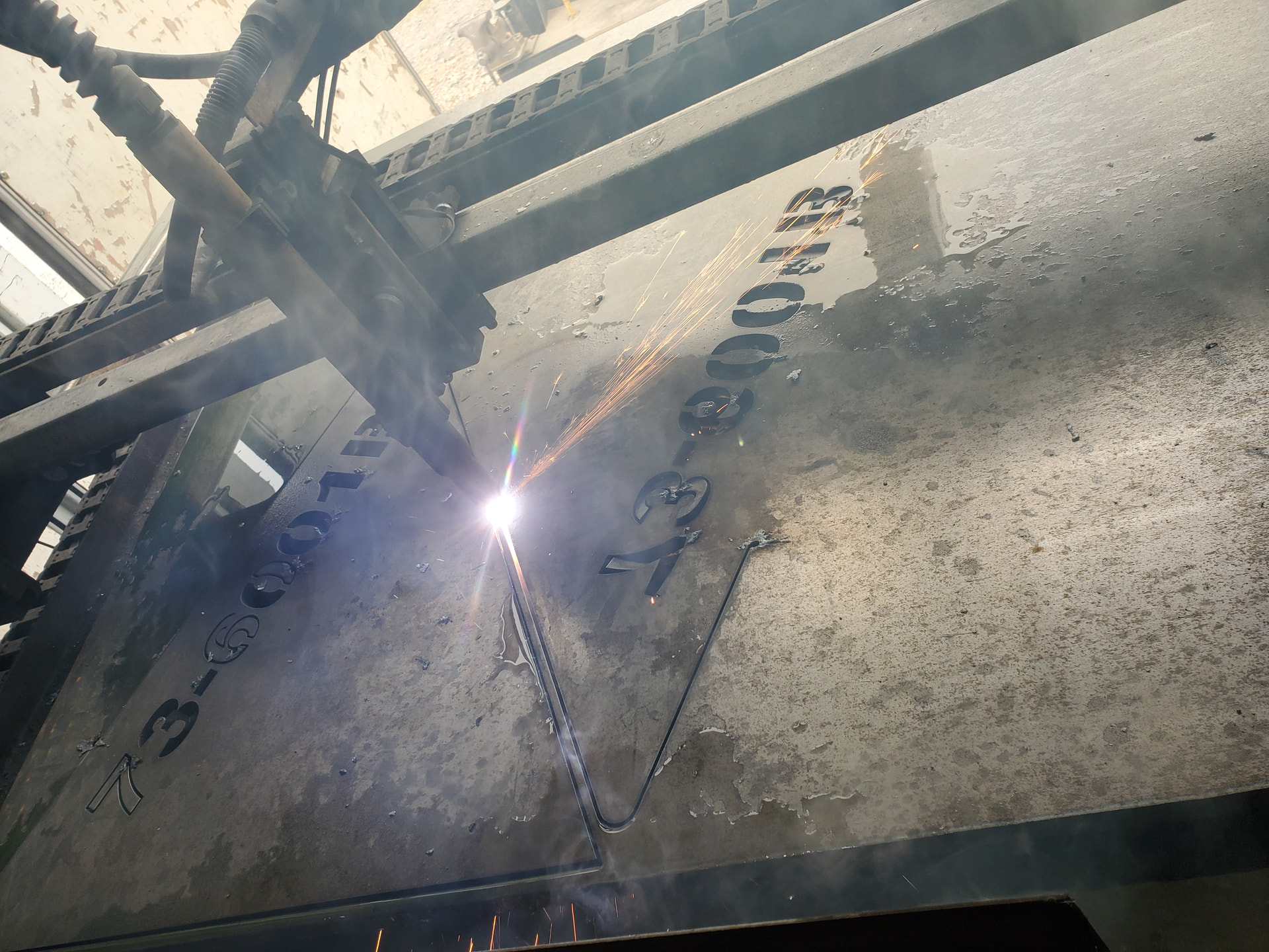

Then further down the line, batch plant operator needed some gussets made out of half inch steel. Decided to personalize a little bit and put the unit number in.
Every now and then a blind squirrel finds a nut. Hardly any taper on those cuts, came out 99% dross free on the back side and all the numbers fell right out. Numbers are two and a half inches tall with a aerial font that I hand put in the brakes for the closed loops. 100 amps, 145 volts, 50 inches per minute

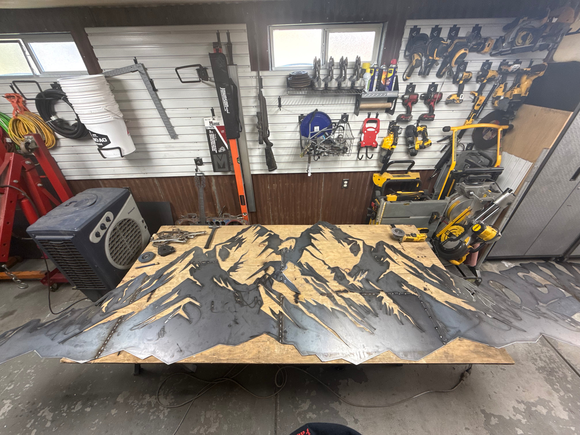

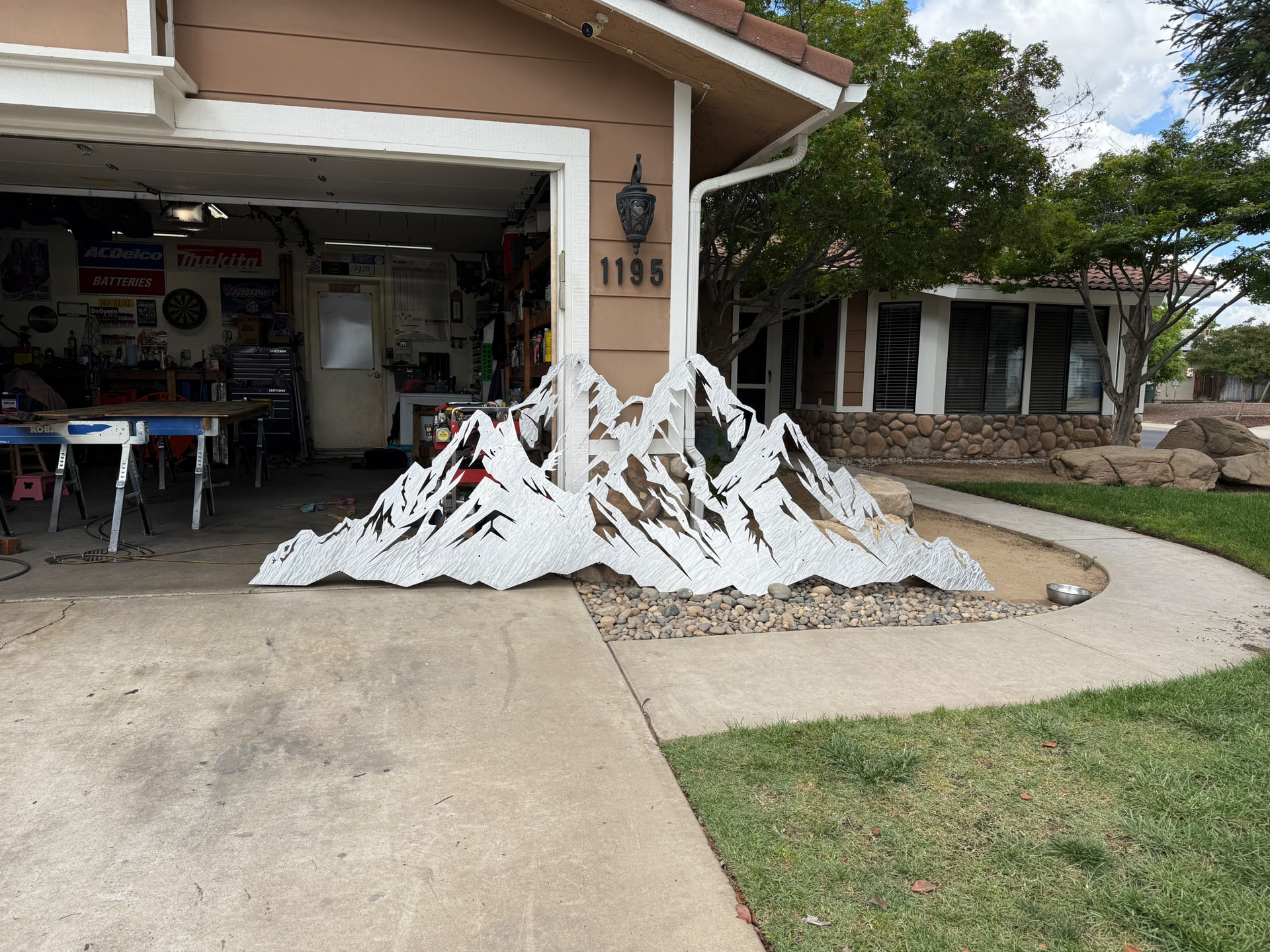

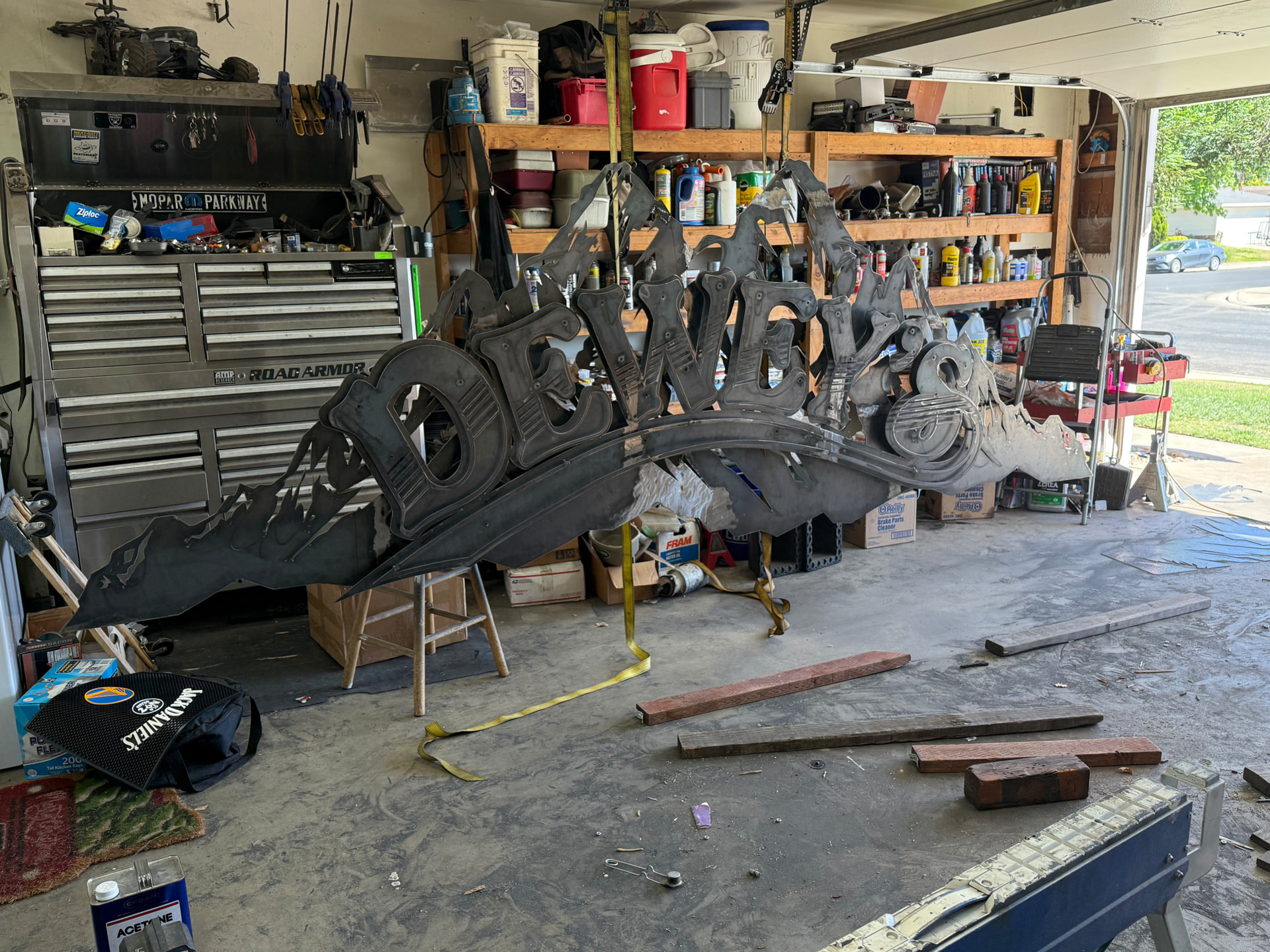

Got asked to do a sign. My buddy and I came up with this….. pictures are not in order. But it’s a 3 layered 12.5ft wide and 55” tall. Ended up being 20 pieces. Welded together to make one. And did this all on the PRO. I’ll share the final product once we get the lighting completed.
