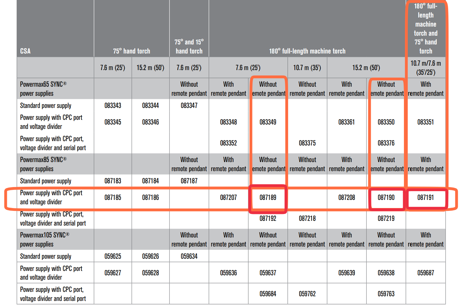

I looked at razorweld, it looks like we the CPC port isnt on the 80 AMP machine though. Right now we are running a cutmaster 42 lol
Do the only the new SYNC versions have the CPC port?
Absolutely.
https://www.hypertherm.com/Download?fileId=HYP252362&zip=False
At the bottom of this brochure you’ll see the model numbers for both the unit with and without the CPC port.
Normally any hypertherm that’s packaged with a machine torch is also packaged with a power supply that has a CPC port.
If your looking for a 80 amp plasma cutter then the Hypertherm 85 SYNC with the CPC and machine torch $4000 or the Everlast 82i CNC package $1300

Here’s the brochure that actually shows the machine torches.
https://www.hypertherm.com/Download?fileId=HYP252359&zip=False
If it was me I would start looking at these three model numbers.
