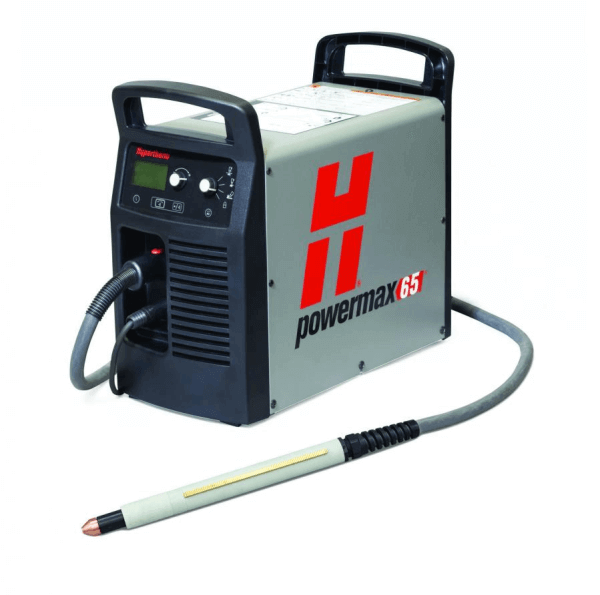

Hypertherm powermax 85 CNC 4451.99
Everlast 82i CNC 1319.00
So $ 3132 difference.
But this might be an unpopular opinion but they’re not comparable. you’d be way better off comparing the everlast 82i to the hypertherm powermax 65.
Hypertherm powermax 65 CNC 3450
So $ 2131 difference.
If we’re comparing inches per minute from the everlast 82 I to the hypertherm 85.
The everlast you’re running at 100 inches per minute at 75 amps.
Depending on whether you’re doing production speeds or best quality speeds on the hypertherm you’d be running 130 to 160 in per minute but that’s at 85 amps.
So 13% more amps but 30 to 60% more speed.
If you decided to run that same machine at 65 amps it would do quarter inch at 90 IPM to 116IPM.
So at 13% less amps it will do pretty well at the same speed.
This kind of affirms that it’s more comparable to the PowerMax 65.
For the money you’re not going to get better than that everlast 82 I but saying it’s 5% difference to the hypertherm 85 is a big stretch. It’s more like 40% faster if you take into account the amperage difference but it is triple the money.
