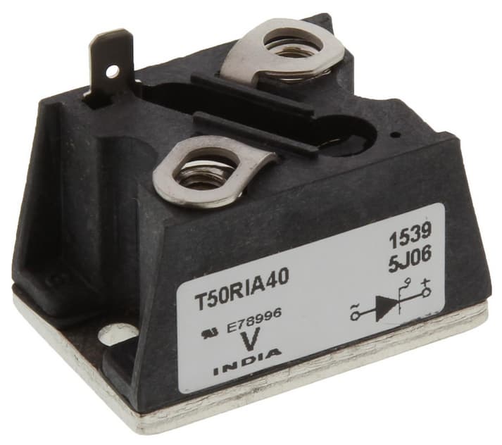

Guys I know this is the Plasma Forum. I have been on the Miller forum with no help, but can anyone explain to me why this thyristor (T50RIA40) is so hard to get? I am going to throw one part at it before I bring it to a Miller service center. Look at the disclosure on the bottom of the email reply I received from one company. I have searched the web for the part and every website that says they have it, I cant just buy it, they are saying they will reply to my inquire. Plus the wording from this company is a little weird.
It looks like the problem is more getting one of them instead of having to buy 10 or more and waiting 10 weeks.
Here’s a place you can buy one of but you’re still going to have to wait
VS-T50RIA40 VISHAY - Module: thyristor | single thyristor; 400V; 50A; Ifmax: 80A; screw | Transfer Multisort Elektronik VS-T50RIA40 VISHAY - Module: thyristor | single thyristor; 400V; 50A; Ifmax: 80A; screw | Transfer Multisort Elektronik
@TinWhisperer
Thanks Tin
I thought I was doing something wrong. What is with these things? are will still in the COVID chip shortage era?
Is this the one your looking for
This is what I am looking for 9 week lead time :face_with_symbols_on_mouth:
