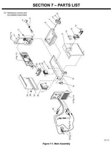

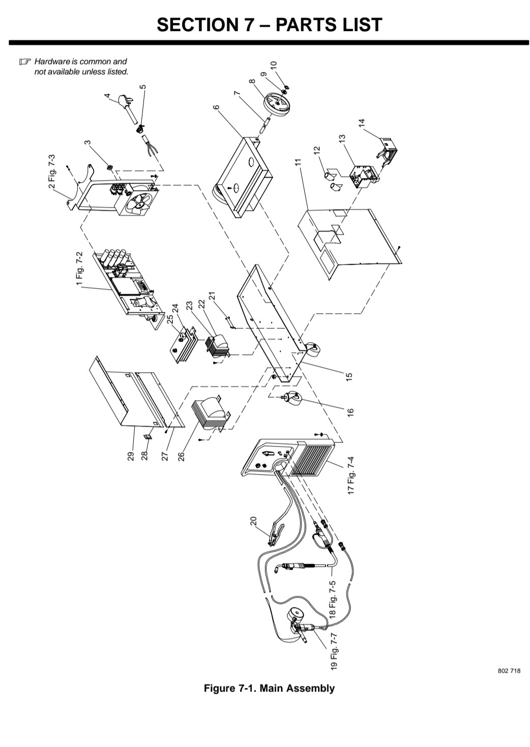

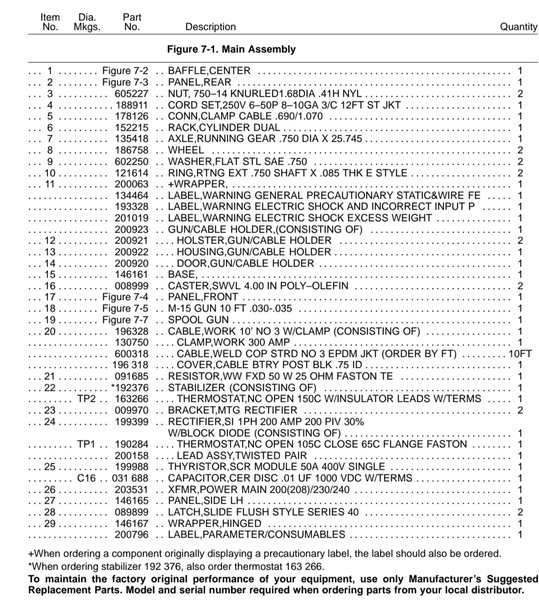

LA281632 Millermatic Pulser I spoke with a tech from our local welder supply store and he had me check a few things with no luck. He told me if it was the board there is no replacement. I would love to be able to fix this machine. I may look for another company to look at it, but at $175hr and 20 years old I am a little hesitant. I have a little knowledge and understanding about electronics so I can look at some easier things that may be wrong. I am leaning toward the main transformer 220 volts are going in but nothing coming out. The mother board looks good to me no burns or hot spots and all the electronics look good. The machine turns on the trigger works the wire feed but no power at wire on either gun.
O1322B_MIL.pdf https://share.google/7pR7R9kHJPxP9mlwP
Here’s the manual for your unit it has exploded diagrams of the internals.

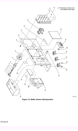

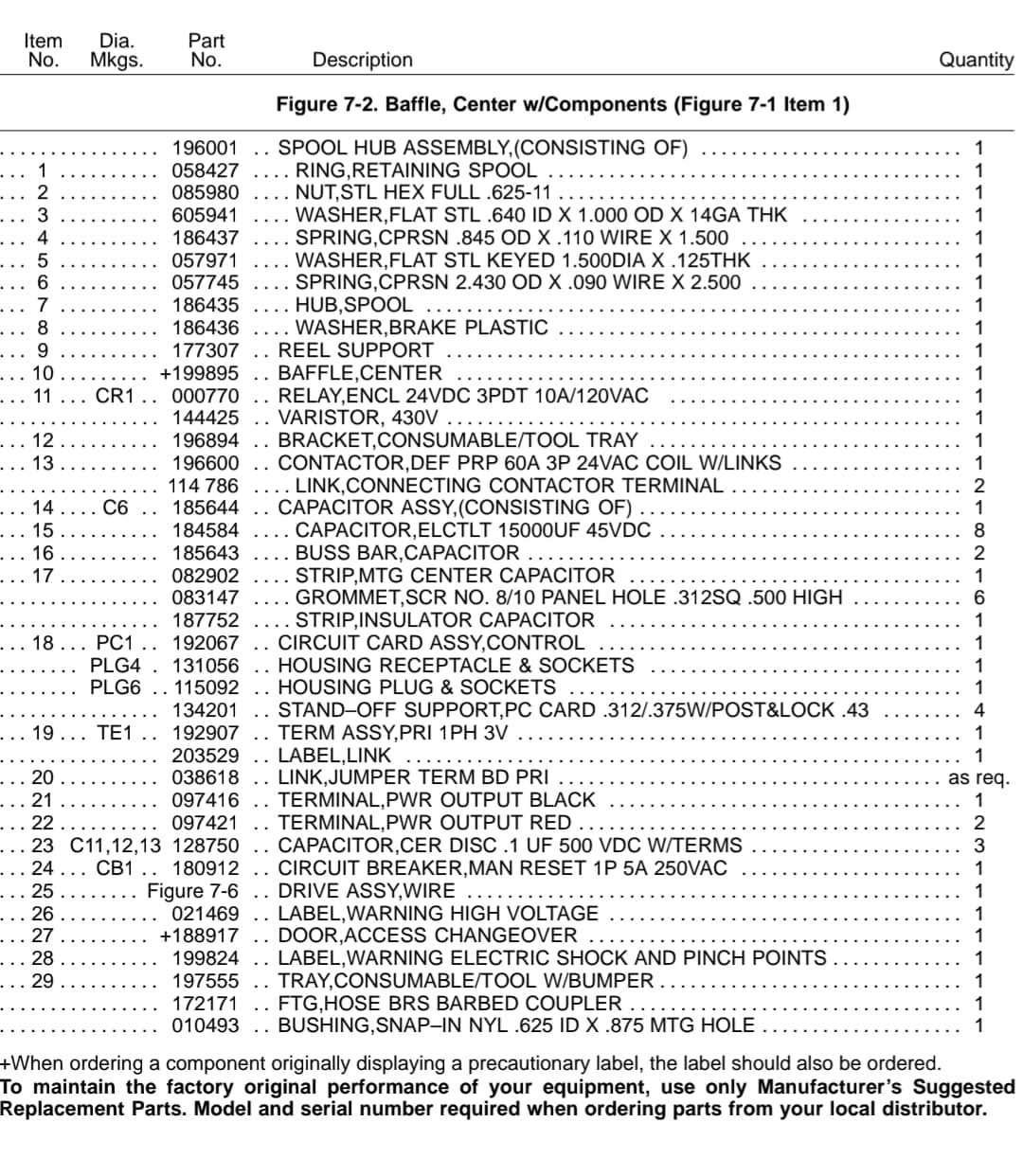

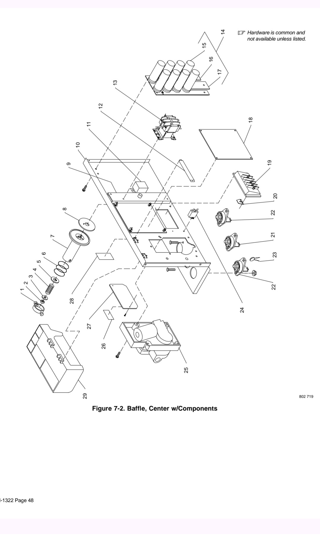

Did he happen to give you the part number of the board?

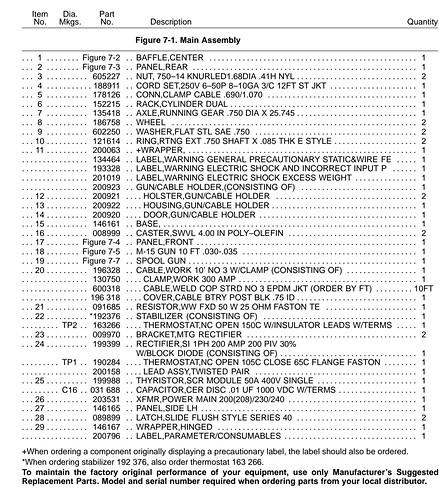

Is it part 14 in the back of the book?
Maybe it’s the main contactor?
Your leaning towards part 26?
Maybe it’s also the rectifier part 24 if you’re not getting power out?
Rectifier is available.
Miller 199399 Rectifier, Si 1Ph 200 Amp 200 Piv 30 w/Block Diode Miller 199399 Rectifier, Si 1Ph 200 Amp 200 Piv 30 w/Block Diode
Contactor works. yes leaning toward 26 I did see that the Rectifier was available I hate to gamble that much. I will do a little more research to find someone to look at it. My first guy did not seem to interested in it so I will find another. I do believe putting money in the machine is worth it. I guess anything less than $1000.00 is worth it for how good the machine has been for me.
Thank you for your help
I guess even a diode could be bad. There are lots of them in there.
