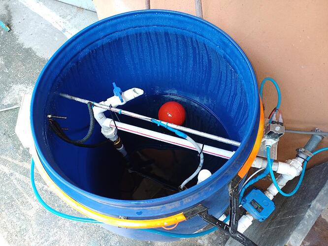

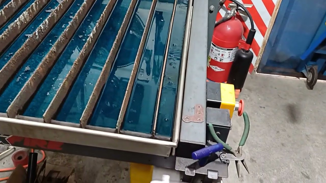

here is my video on my table water system
I didn’t provide complete information, however. I enclose the magnets in small plastic bags so, even though the filings are ‘captured’ by the magnets, they are easy to clean by simply pulling the plastic away from the magnet over a dustbin. No muss or fuss.

I use the homebrew formula with Sodium Nitrite as the active + a fungicide. I flood the table before each use and drain after use (1.75 minutes each way). Usually, I pull out the chunky bits as I see them and toss in the bin, My storage tank (55 gal Plastic Drum) allows the fine crud in suspension to sink to the bottom (there’s also a bunch of magnets in a zip-lock bag at the bottom of the tank), the pump (Rule Bilge Pump) pickup line is midway in the tank. The tank has much more capacity than the table, so there’s always clean coolant available to the pump.
Also, at the bottom of my water table, sits a 1mm stainless steel sheet on 1/4" thick SS spacers (5/16" SS Nuts). This acts as a primary blast-shield for the plasma jet, and a baffle for the water flowing in and out of the center drain fitting.
