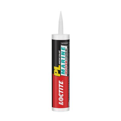

i know in the past with other LS tables many people ran into issues with leaks coming from where the 2 water trays bolted together. Has something changed in the design of the XR compared to the other tables that the leaks aren’t as much of an issue anymore for example clamping design, sealant type, procedure, etc… is welding still the go to fix all?? is the marine grade sealant provided the best option?? @langmuir-daniel @langmuirsystems
Yes so far we have not had any reports of water table leaks on XR. The joint design is similar, but the marine sealant is a much better adhesive for the application. We are working on getting the same adhesive for CrossFire PRO water tables.
do you think the marine grade sealant is the best option? i work in the aircraft industry and was thinking about substituting if for some 890 fuel tank sealant they use one aircrafts…
Im not familiar with 890, but marine grade sealant we feel is the best adhesive for this application. The bond strength is very high, it remains flexible, and its rated for constant underwater environment.

We haven’t receive any reports of any leaks using PL Marine. You can of course make your own decision, but we have never tested that adhesive for continuous underwater application and therefore can’t say if it would hold up over time the way that PL Marine will.

The calk that Langmuir supplies with the xr will work just fine, I have used it on my center console boat when supplier was out of the 3m marine calks.
This is essentially what we supply with the XR, just the loctite version of it. Works great.

I thought about using Permatex RTV Ultra Black to seal my XR but I used what Langmuir supplied. I let it cure for 2 full days before filling the table up and I’ve not had a single drop of leakage. The marine grade sealant they supply is high quality stuff.
So unfortunately we don’t supply marine sealant with PRO currently but we are working on it. It’s been a struggle just to source enough for XR. Once global supply chains free up our plan is to change over to marine sealant for PRO. If you can find some 3m 4/5200 or loctite pl marine I’d recommend it.
Thanks. FYI for others - both Home Depot and Lowes carry the Locktite in stores.
