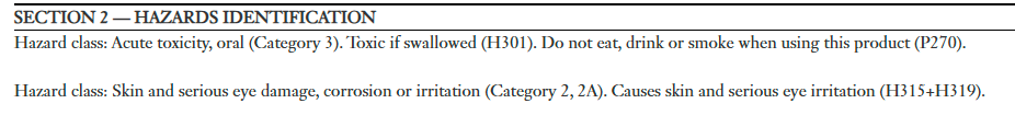

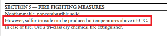

I’m a bit late to this thread but I was about to cook up a batch of this to try it out and was wondering if anyone has replaced the dye with copper sulfate pentahydrate? it should turn the fluid a deep blue and control bacteria. Copper Sulfate is a biocide that kills algae and plants. May not be as effective on iron loving bacteria, but I haven’t researched it.
Are you sure you want to do that? Here is the SDS sheet:
And here are a few excerpts from it:
Sulfur trioxide will combine with H2O to form sulfuric acid.
no, I am not sure at all. in fact, that’s a big reason for my post.
at the concentrations I’m thinking of it seems very unlikely to form SO3 in an aqueous solution. there’s a few other cupric compounds that i might try if I end up with H2SO4. I’ll give it a shot an report back. if it does form H2SO4 if might save me a bit of money on buying it for my electroplating bath.
Sterling Cool. Just buy some and be done with the science experiment. @ChelanJim is correct. It will make sulfuric acid gas during the cutting.
^^^^^^^^^^^^^^THIS!^^^^^^^^^^^^^^
Can’t stress that enough.
Just buy the proper additive - not worth risking your health to save a few dollars, especially after spending thousands on equipment.
