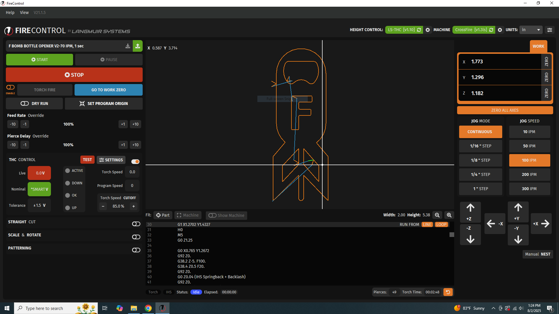

I attached the cable to the other port on the plasma cutter and got 292 v reading in the software.

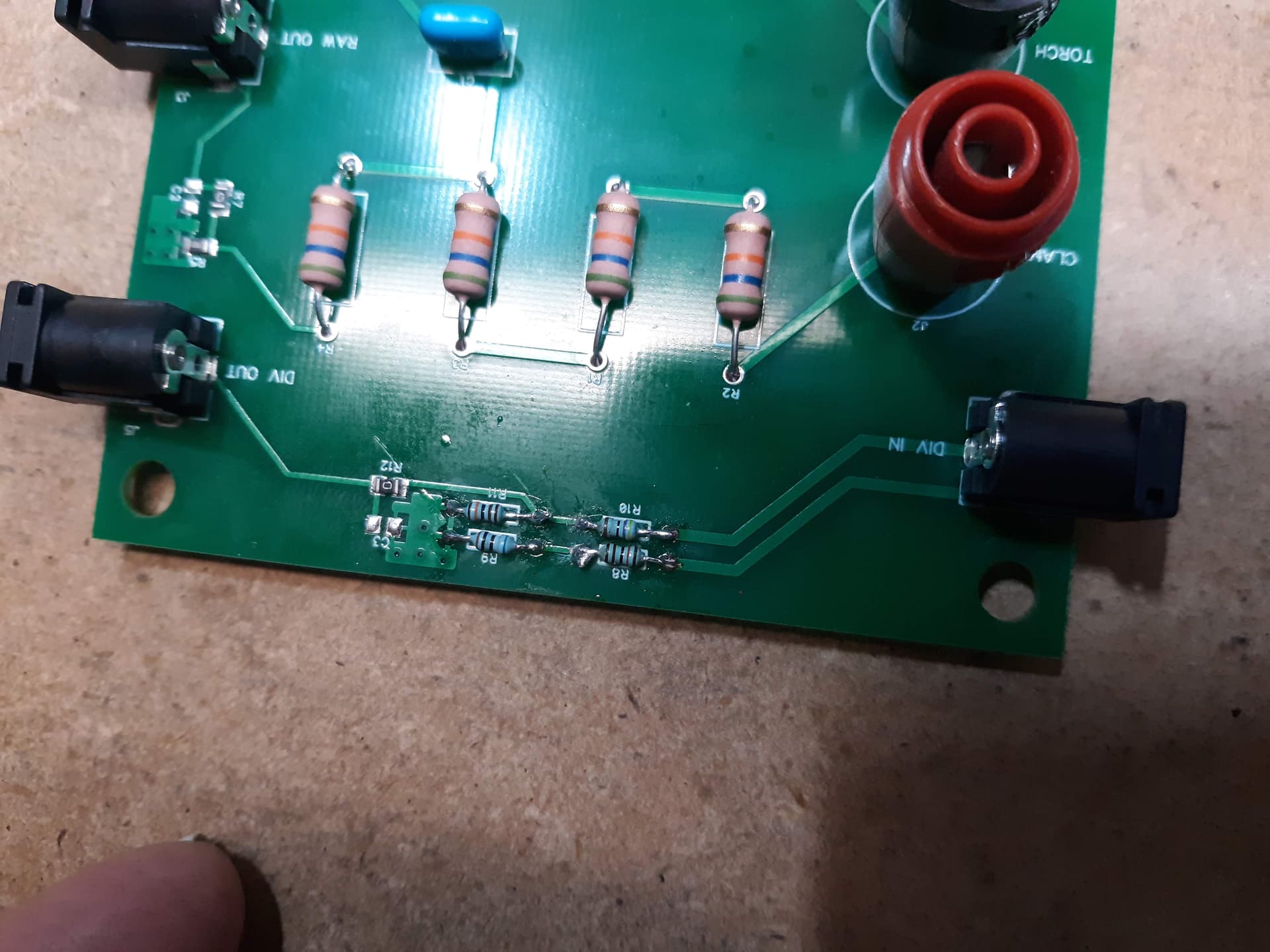

@ChelanJim - he has the best description with pics

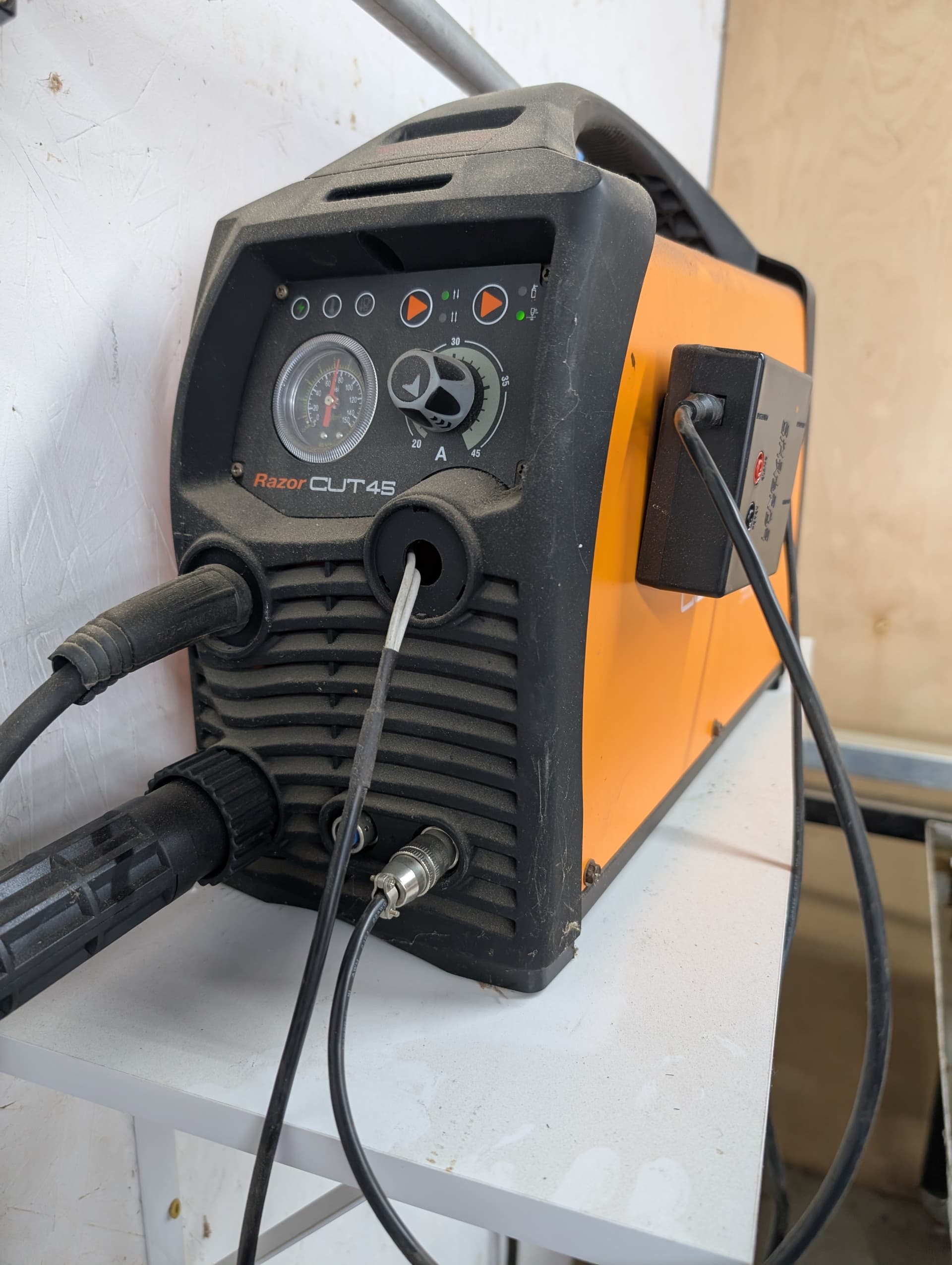

I can’t really tell the ports for “output” that you are using on the VIM box. Make sure you are staying on the “voltage divided” side for both input and output (green outline).

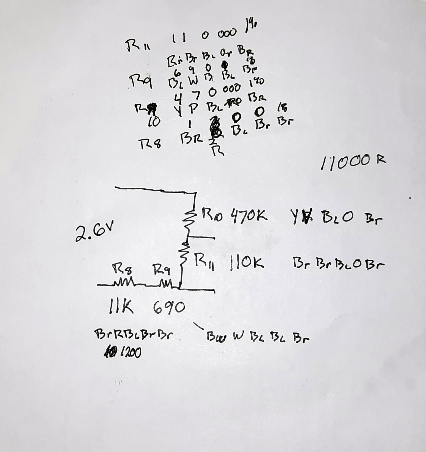

Here are a couple of photos I took four years ago when my divider stopped working. I can’t say whether this matches your situation or offer specifics on the repair, but it looks like I replaced some resistors and got it working again. Hopefully, this helps someone.
Hey ChelanJim, I am definitely staying on the voltage divided side of the box. It’s hard to see in the picture, but the cable is plugged into the div output port.
Hey Holla, love your videos. I don’t think the issue is with the divider box, I think it’s before that, as the cable from the plasma cutter isn’t reading any voltage when I hook up a multimeter to it. I’ll open the box on the divider box and take a look there at least. My last update wasn’t very clear, when I said port isn’t giving any voltage, I meant the port off the plasma cutter.
