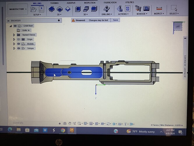

Here is a 3D model. I can’t get it to do anything but open in Fusion. I also attached a pic of the only 2 pockets that need to be milled out. The XYZ is wrong in the pic. Thank you for your help and patience.
AR15_Lower_Receiver.IGS (4.1 MB)
When you say “Can’t get it to do anything…” what have you tried? I was able to open the .IGS file and save as a Fusion project. If I were taking on the machining, I’d then move to the Manufacture tab, establish a Setup with an origin point (based on how you intend to hold the work.) Set Z0 to the top of the receiver (or another point you can easily touch off). Then it’s not too hard. 2D Contour with multiple depths, choose an appropriate tool, ramp for lead in, leave (Stock to Leave) .005" on sides and floor. Run a 2nd 2D Contour with similar settings leaving 0.000" on the sides and floor. (I’d change to a finishing tool personally.)

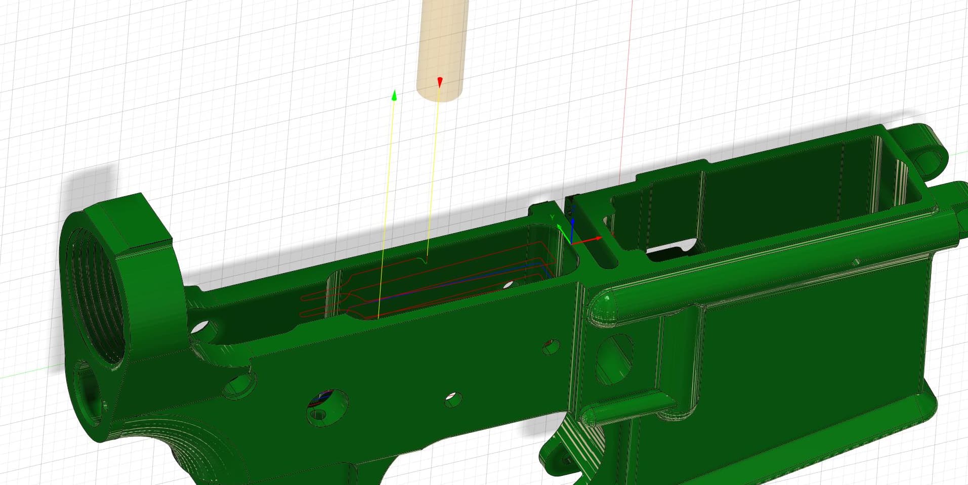

Edit - Something like this …
