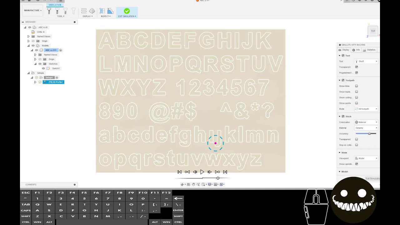

I have a lettering set I want to draft and cut for a customer. I’ll be live streaming the CAD CAM workflow in about 15 minutes

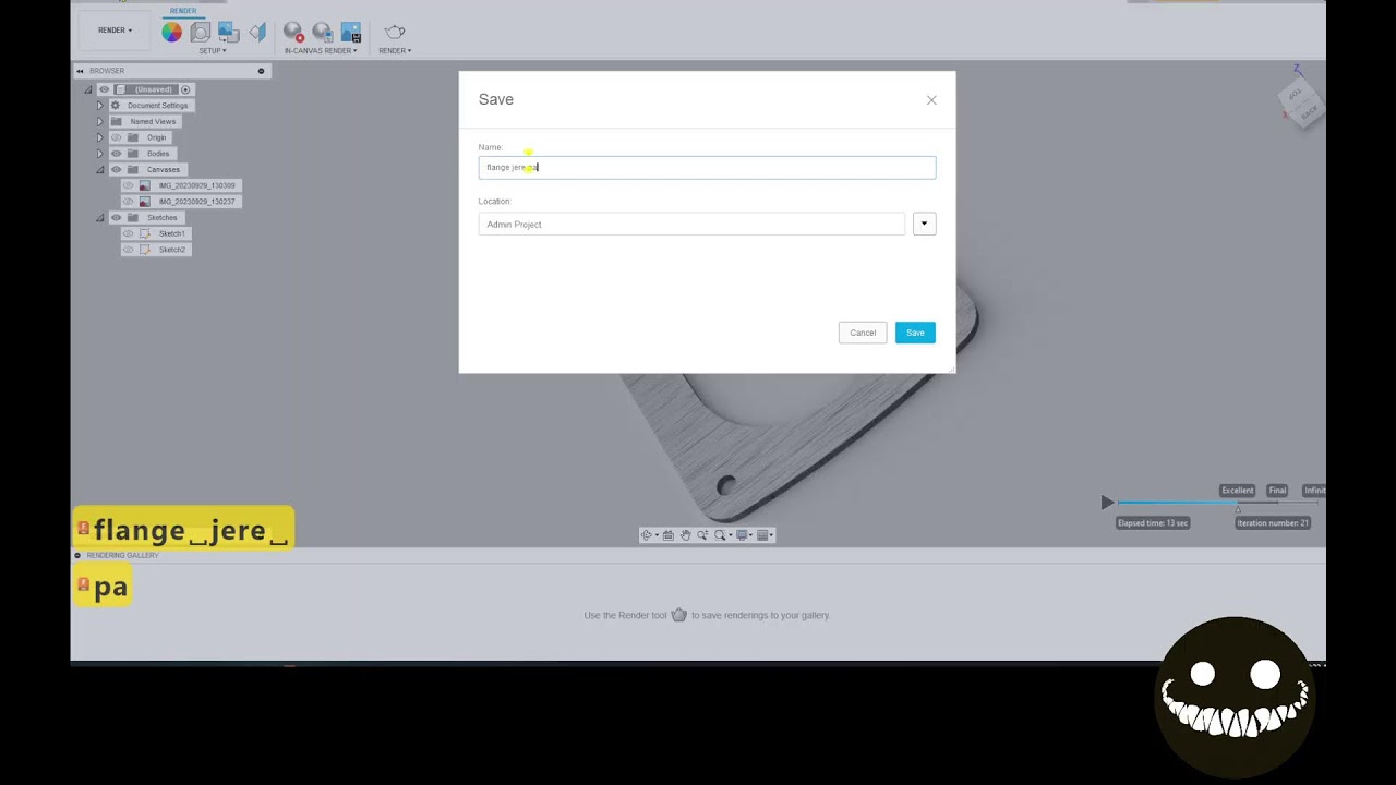

Langmuir Forum CAD of flange from pictures. No talking just music. Quick morning stream starting shortly
Live Stream Channels
IMG_20230929_130237IMG_20230929_130309
inside of one and outside of another.
the tangent constraints were key to making this project work correctly.
They managed to cut those flanges between some chores. Thin, only 14ga ss
I used hypertherm fine cut consumables, low speed, book settings. No clean in these pictures
There about three and a half by two and a half in size the holes are 5/32 (at least that’s what I drew them I’ll have to check what they’re actually at)

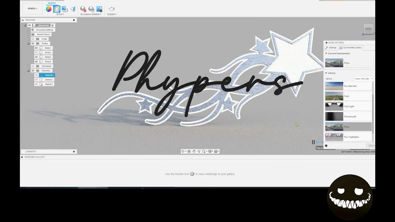

I have another multilayer sign to design so Ill start another stream soon 415pm ish pst
still a work in progress
I must admit I was not really into the design and thought you picked the wrong font but at the 30 minute mark I told myself “That Tin is a genius!” Very Cool.
