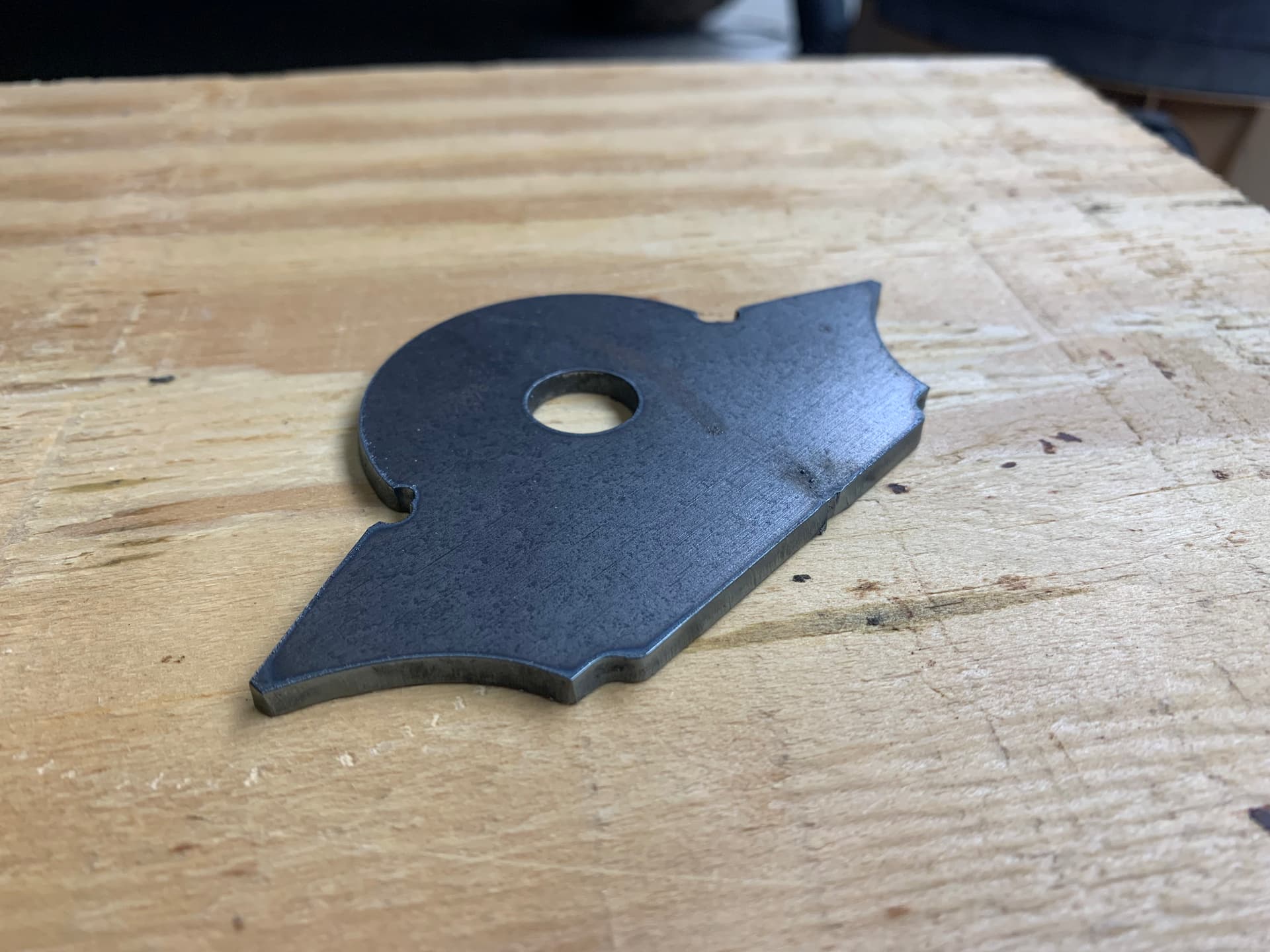

I did a little bit of cutting with the Everlast yesterday. I still have a lot of work to do trying to figure out cut settings on it, but I feel like it maybe produces a slightly cleaner cut line. Perhaps the torch is working better, as the Primeweld “real Italian Tecmo” (which looks IDENTICAL to the Chinese Everlast torch, and nothing like the torches George sells) always felt a little bit sticky and didn’t feel like it was flowing full air pressure. As a side note, I need to learn how to disassemble and lubricate a Tecmo-style machine torch. But to answer your question, so far I like the Everlast machine.

I hope to give the machine a bit of a workout today, and will hopefully have some pictures of parts worth sharing soon.
