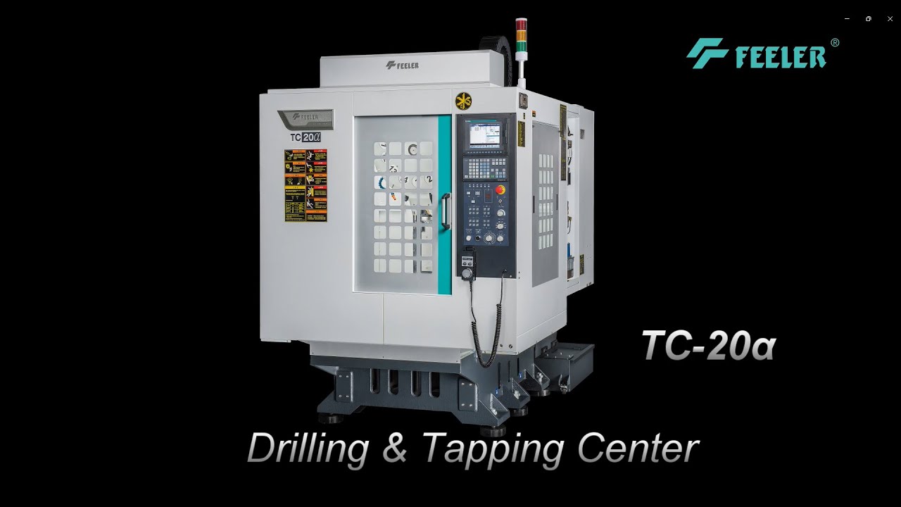

make sure your lead screw bearings at the bottom of the assembly are not allowing extra motion. Then you could replace all the rails X, Y, and Z with roller style rails. (very extensive mod) I would go with the Hiwin RG series with medium preload. I considered this but I just don’t think it’s worth it. Just run the MR-1 till you’ve made enough money to buy this machine for $50k.
This is my current plan…
