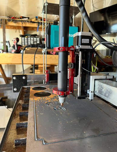

So I got everything set up yesterday with the THC and a IPTM60 machine torch. I made some nice test cuts last night and it worked great. Without making any changes, I went to use it today and it just blows air. I’m using a Bestarc BTC500XP. Any ideas?
Torch mounted picture please.
The electrode must move up with your finger and snap down.
Make sure you have 75 psi to the torch while it’s cutting. Not 60 or 50, 75…
This torch is mounted correctly.
I’m guessing this is incorrect?
Yes, you are squeezing the pilot arc plunger inside. Loosen the bottom clamp and make sure the electrode moves like the video
Electrode was fine, I repositioned the torch and increased psi to torch to 75. Same issue. It just blows air. Does the same when manually firing the torch from fire control.

Sorry to say his plasma cutter has bit the dirt. He has a new one on the way. Hope he has better luck with the new one.
