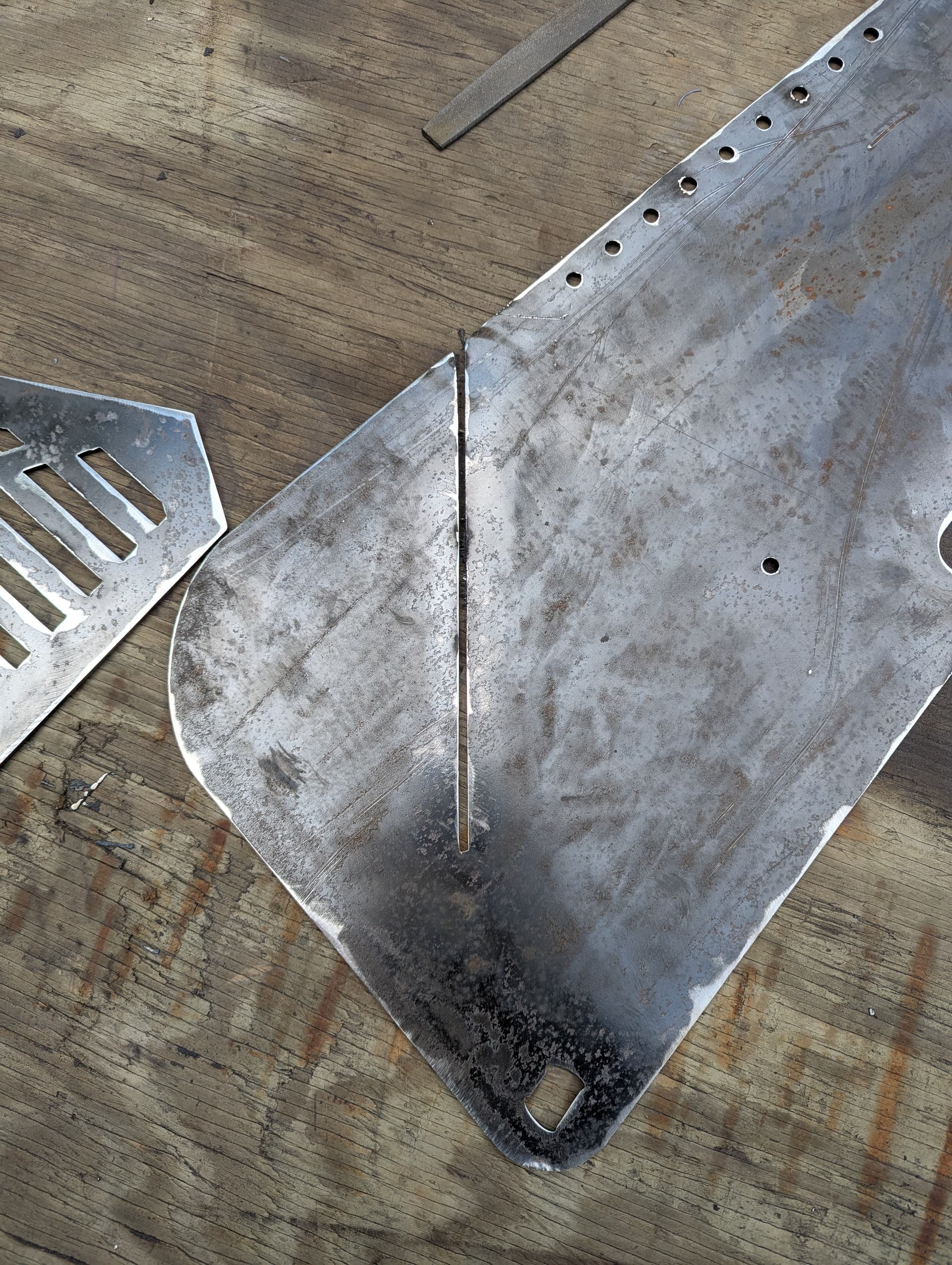

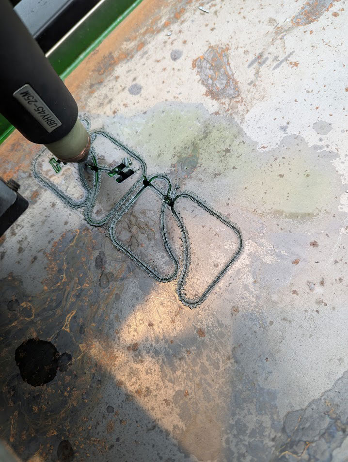

Hi everyone, thank you guys again for all of your help with my sign project. A while back I posted, and you all helped me through my first project. In that thread I showed my final result had this issue where the arc seemed to not stop and like “trailed” along to the next cut path leaving a gouge (not through cut) between the “F” & “K” character paths. I ended up filling and painting that one, so no big deal. I thought maybe it was bad luck since it only happened once near the end of the job.
I haven’t really used the machine since then. Today I started cutting some test pieces on some 8ga. While I was testing my feeds/speeds (which are better than the picture at this point, but still need some tuning) I noticed the same issue. It’s like the torch doesn’t completely stop firing when travelling between cut paths. Does anyone know what I’m doing wrong here? Thank you in advance for all the help. It’s HUGELY appreciated.

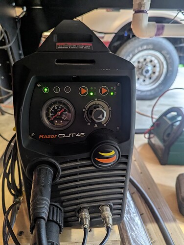

There are lots of Cut 45 models out there, but if yours has a 2T/4T switch on the top of the front panel then it’s probably in 4T mode. It must be in 2T mode for the torch to shutoff after each cut.
Thank you. I will take another crack at my fire pit project tomorrow. I’m hopeful that you might have found my mistake! I just went out and powered up to check… Thank you! :sweat_smile:
… Though I’m not sure how that would have toggled, especially mid cut on that last project.
Yeah, definitely not in the correct position. You might have touched it while changing the amperage setting.
