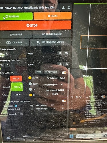

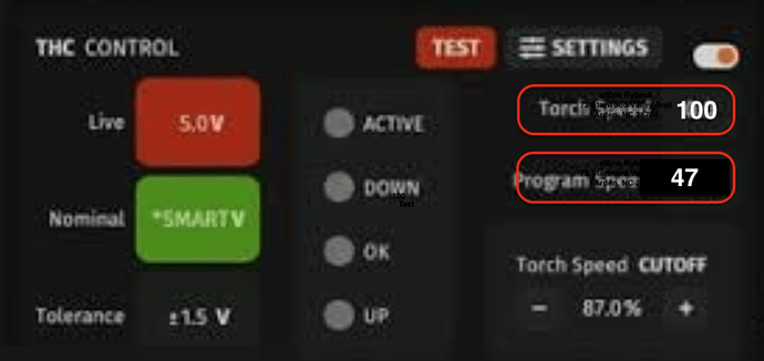

I am cutting a bunch of 1/4 steel. Today it started the holes and was not cutting good so I replaced the nozzle and started where I left off. It completed the holes but then when starting the outside it would start cutting but then stop cutting through even though the torch was running the whole time spraying sparks all over from the top. I tried the cut by turning on the torch manually on the software and then running the XY by hand with arrows at 50 speed. My cut speed for the program is set to 47. Running by hand with < > arrows at 50 works great but it will not cut with the program. Running the program shows torch speed 100 and program speed 47 but it really looks like it is moving too fast but I could be wrong. It is the same example program in Sheetcam that I have used on many previous cuts, only change out the artwork. Any suggestions what is going on? Is there some way the XY could start running faster?

You’re going to have to post a screenshot showing this 100 torch speed. There is nothing in that code that would cause Firecontrol to report that.

All my holes and internal small slots are set to 45 which works fine. Outside cuts are 47 which is just my default for 1/4 steel A36. I have never given thought to plunge rate but it’s easy to change, not sure what it will do. I will have to load some material and test it to get the screenshot. It was repeating the same speed on this one part that didnt cut through just reflecting off the surface. It always said 100 torch speed and 47 program under the THC section.

At all times during the long outside cut is says 100 Torch Speed. I can’t run it today but this is what it said during the cuts. I tried for an hour to solve it. Rebooted the box, restarted the Firecontrol. I had to complete the part by selecting a line, generating code from an outside line and hitting start. Then when the nozzle got to the start point I hit stop. Then started the torch manually and used < > buttons to complete the cut with the speed set to 50. Took about an hour but I manually cut it out.
I just did a dry run of that whole program and it never went over 47IPM, except on the rapids between cuts.
That’s what I was conveying to @tchap, that it will only exceed program speed during rapid (non-cutting) movement.

I found the problem. Every time I run cut from line it runs the torch at 100. Program is 47. I am cutting some metal that has holes and sometimes I ru. Over a home and it stops. So I can easily turn on the torch and run it to finish that line. But if I click on the next line past the hole and hit generate it runs the torch at 100.
Maybe something to report to Langmuir as a possible bug with Firecontrol.
If this is the same file, the code is posted earlier in this thread. The program speed is 47. I did a dry run of it, but dry run on 20.6 doesn’t allow the “run from” feature and I wasn’t going to actually cut a part to find out if it does this on 20.6. It looks like this may be a bug in the latest version of Firecontrol.

I updated firmware and THC firmware. Even on dryrun I get 100.2 torch speed while program speed is 47. It is not required to run the torch to see the error. The torch speed shows 100.2 with THC enabled or off while dry running.
I uploaded a file that came from sheetcam and works. I click on a line and press “Line” which generates gcode from that line. I export that file to the computer and you can see that file.
