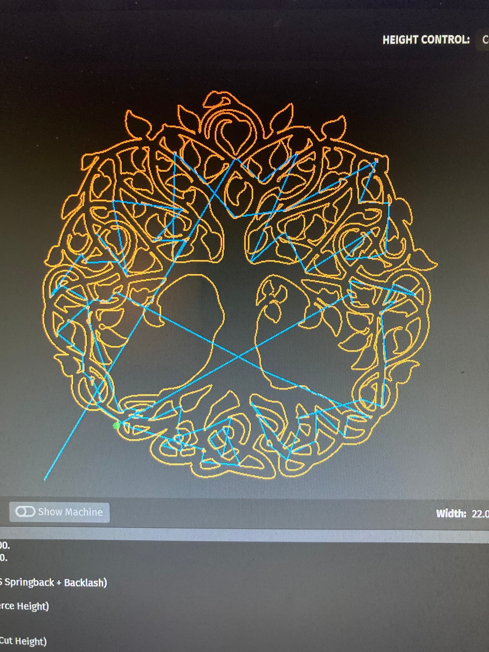

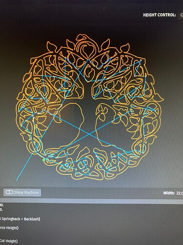

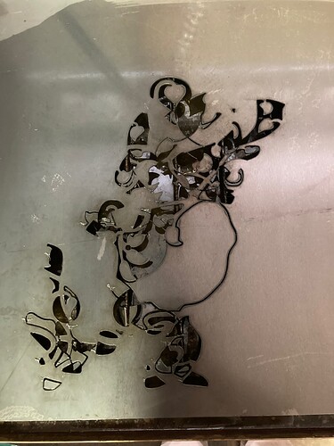

So here is a $50 piece of modern art (aka scrap). Those with close attention to detail might see that the Tree of Life (lovely design Richard!) looks a little different on the FireControl screen than the actual cut.
I gave up on the THC and detached it and was able to start work. Previously I’d get 1 second of arc and then a fail alert.
The first few cuts were good. Then we started loosing arc after several seconds of cutting. Then we lost Z location.
So good news: I’m at least able to make scrap now. That is better than before.

What do you mean by lost Z location?
what errors are you getting? is your air pressure dropping?
are you having to restart firecontrol when this happens? if so you could be having a ground loop problem?
Answering Knick…
The Left/Right location of the cutting head is wildly out of position from where it should be.

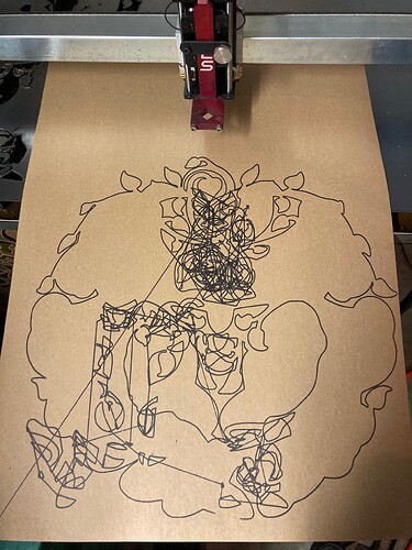

So I did another test with the plasma cutter totally powered down to test to see if Electro Magnetic Interference was an issue.
I mounted a Sharpie pen into the tool head and ran the program on cardboard.
This is GREAT - no I will never need a toddler in my life to make random scribbles…
Again, the Z axis is F’ed up. I’ll check my bearing torque. Without the air on I could hear the motor stalling out.
Looks like motor coupling is slipping bad.
Phillipw - I’m checking the bearings for the X-axis sled/work head.
With the air off I was able to finally ear the step motor having problems.
That being said, the original break in program ran fine.
And that X-Axis would not affect the torch control.
Cheers
If you are not slipping something is binding. New machine have you oiled your lead screws?
It is either a slipping issue or a binding issue causing you to lose steps.
Phillipw - slipping/binding & oil
I’m going to partially dismantle and reassess the work head bearings.
I just reviewed the manual and am not seeing an oil requirement. A nylon bearing surface should be self lubricating . Did I miss something or is this covered in other literature?
Nope no literature just experience. I use 3in1 oil and WD-40. Everything works better with a little oil. I have seen others lose steps before over dry lead screws.
Make sure the red anodized bearing holders are in the correct place. The x and y have different sizes. That can cause binding.

You can also get a sharpie make marks on the motor shafts, couplings, and lead screws. All in a line. Jog the machine around at 300 Ipm the check to make sure they are all still in line. It could also be one of the plugs for the motors not seated good in the control box. Then also could be loose brackets that hold the lead screw nuts but I don’t see that one making that sort of a mess.

it’s not the Z-axis( which controls up/down), it’s either the Y or X axis couplers being loose so you’re loosing steps.
Could also be the lead screws binding. do you hear a harsh noise when it was attempting to draw the design?

I thought same thing with the nylon bearing being self lubricating. Life and learn. Now a shot of oil and I run both the x and y full limits before I start. And even though it’s time consuming I run program with the plasma cutter shut off to Listen if it’s going to screw up.
My system is before they sold the thc so can’t help u there. But I torqued my lead screws, that have no flats on them, down. But when the first time it bound up it slid off the top of the thread. Another lesson learned. And more of your " modern art"!
Learned the torch cable needs to be straight the hard way to. Had it coiled up one day in a hurry. When the torch fired lots of odd interference
