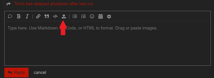

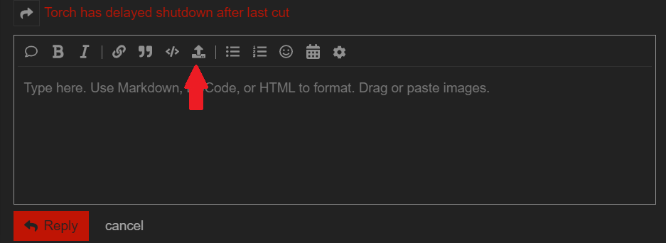

You should be able to upload it here by using the thing that looks like an up arrow in the comment box. Otherwise you could upload it in Fireshare.
