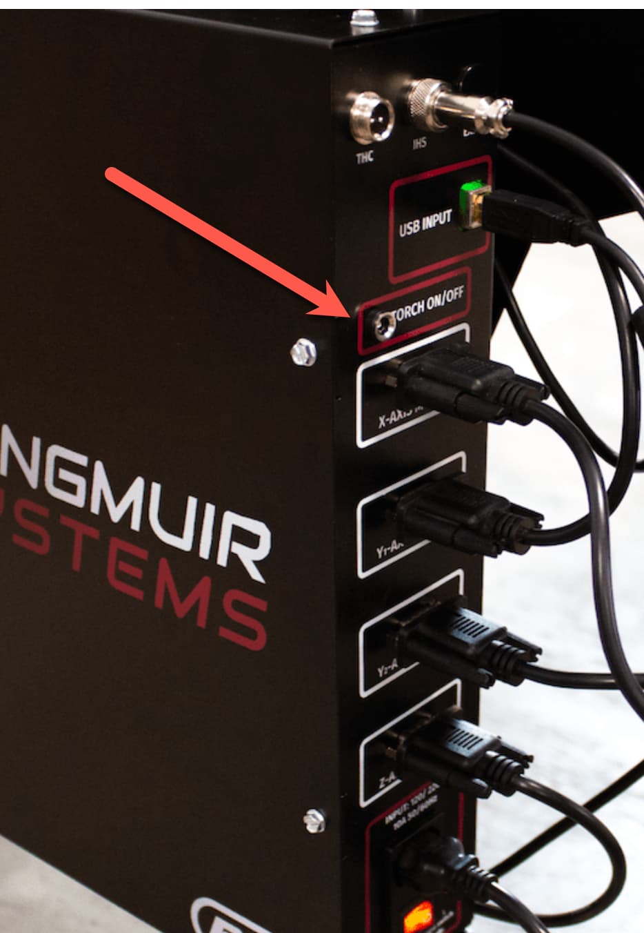

@72Pony @Simsworx Came back to the machine after a while and now there is a yellow light flashing and one of the other red lights flashing on the THC board. If i click the enable torch fire and hit the fire button with the head about 1/4" off a pierce of steel with ground attached i can hear a click but nothing happens. The lights on the plasma show it’s attached and ready to work.

I don’t believe this is a software issue, if you manually fire the torch from Firecontrol and you hear a click the software is telling the board to fire the torch. That tells me the problem is between the control board and the plasma cutter. It has nothing to do with THC.
If I were you I would (with the plasma cutter on) disconnect the torch on/off wire (see graphic) then CAREFULLY jump the ends of that connector. If the torch doesn’t fire then the problem is either the cable or the plasma cutter, if it does fire you know it’s in the langmuir control box. We can troubleshoot from there.

I think I’ve found the problem.
The machine torch lead has pins in holes #1 & #9. Inside the plasma holes #1 & #9 are connected together to the spade terminal, The white 2 pin connector has pins in holes #4 & #5 but there is nothing in the machine torch lead plugging into them. I looked through the plasma wiring section on the website and the handheld torch has all 4 pins. All it says about the machine torch is it’s plug and play. I’m guessing there are some pins missing or in wrong locations as right now they both connect together inside the plasma. A google search hasn’t helped yet looking at images and reading other posts. Does anyone have any info on how this should be?
What makes me scratch my head is how did it know to turn the air on with both pins connected to the same terminal in the plasma. I would think it needs them separated to distinguish the signal changing from the control box unless it just applies more or less voltage to the line through the wires to engage the air. Ooh how I love China.
