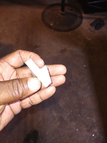

Here is what I am doing to start with

Basic low profile clamps that shouldn’t be difficult to make. Just scale them down a bit.

I am making two like this that is going to act like I stop en

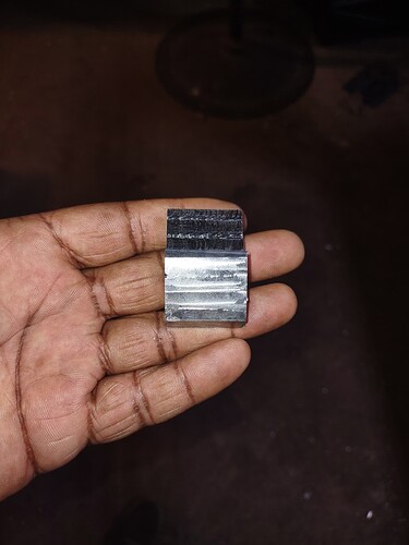

I went down to my local alro metal shop and picked up some 3/4 hex
I faced off one side off The cutting to size before I was going to mill the front
Man you will not believe what I did I’m ashamed all the parts came out wrong total rookie mistake well back down to alro for more metal see if you can see why I did wrong
After trying the part I looked at it for a minute or two and realized I f***** up oh well you live and you learn
