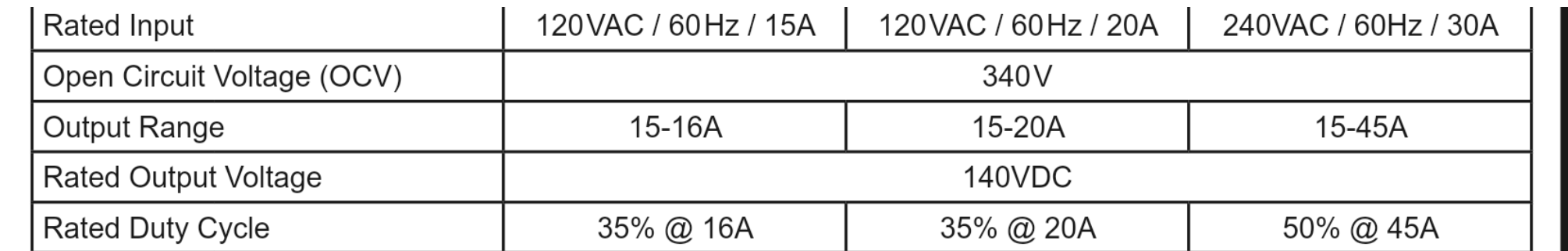

First of all, are you running on 240V or 120V? THAT matters.
If you’re tripping a 30A breaker then you’re probably running on 120V and, as you say, you won’t get 45A out of it. If you wire for 220V, then a 30A breaker will give you 6-7KW of POWER. In that case your PC running at 45A and assuming high efficiency then the POWER drawn will be ~4500W (45A x ~100V at the torch). No problem…

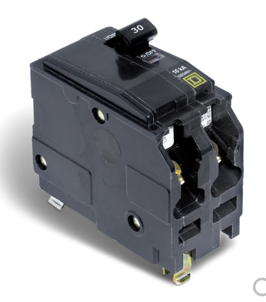

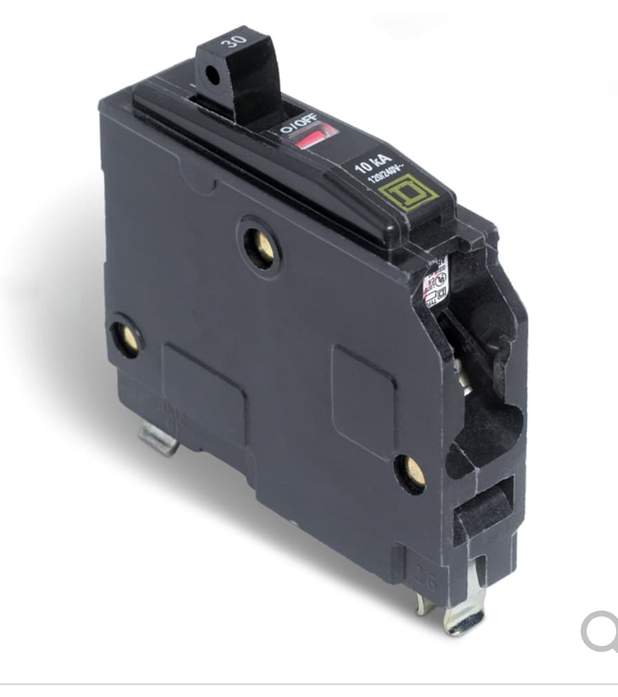

Is your breaker single thick or double thick

Here’s the electrical information for the titanium 45.

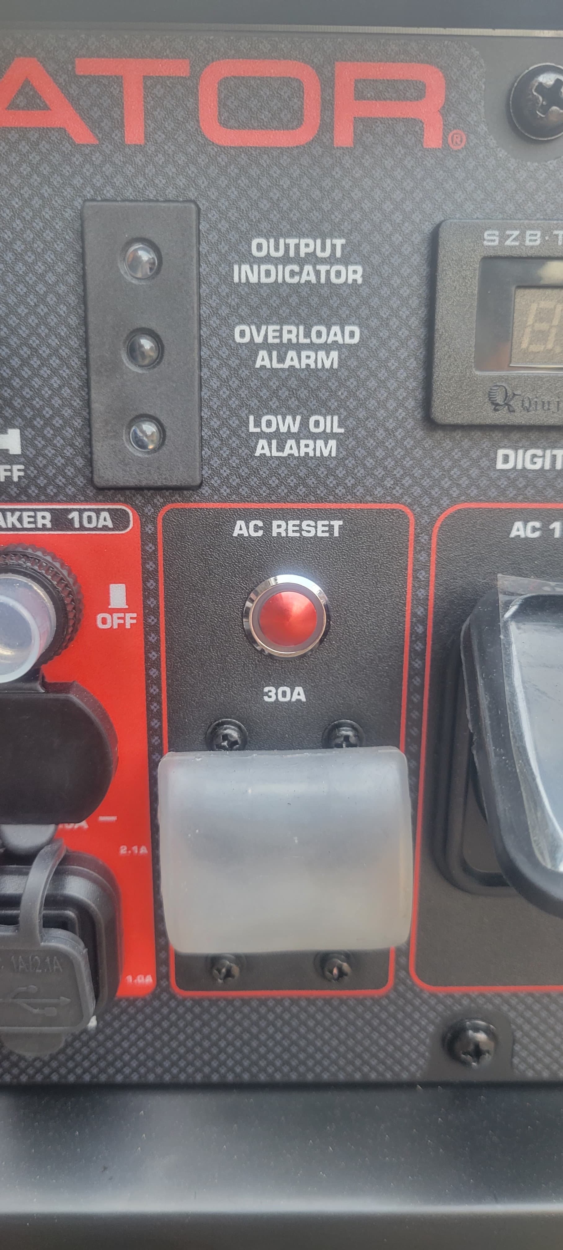

Well Im running an inverter generator. 7000 running watts and 8750 peak (Predator generator). I have the cutter plugged in to the 240v 30amp receptacle. I can use my hypertherm380 turned up to the max, no problem, but that one only pulls 14amps on 240v. The generator has breakers and GFCI protection. I think its the GFCI thats tripping and not the actual breaker.

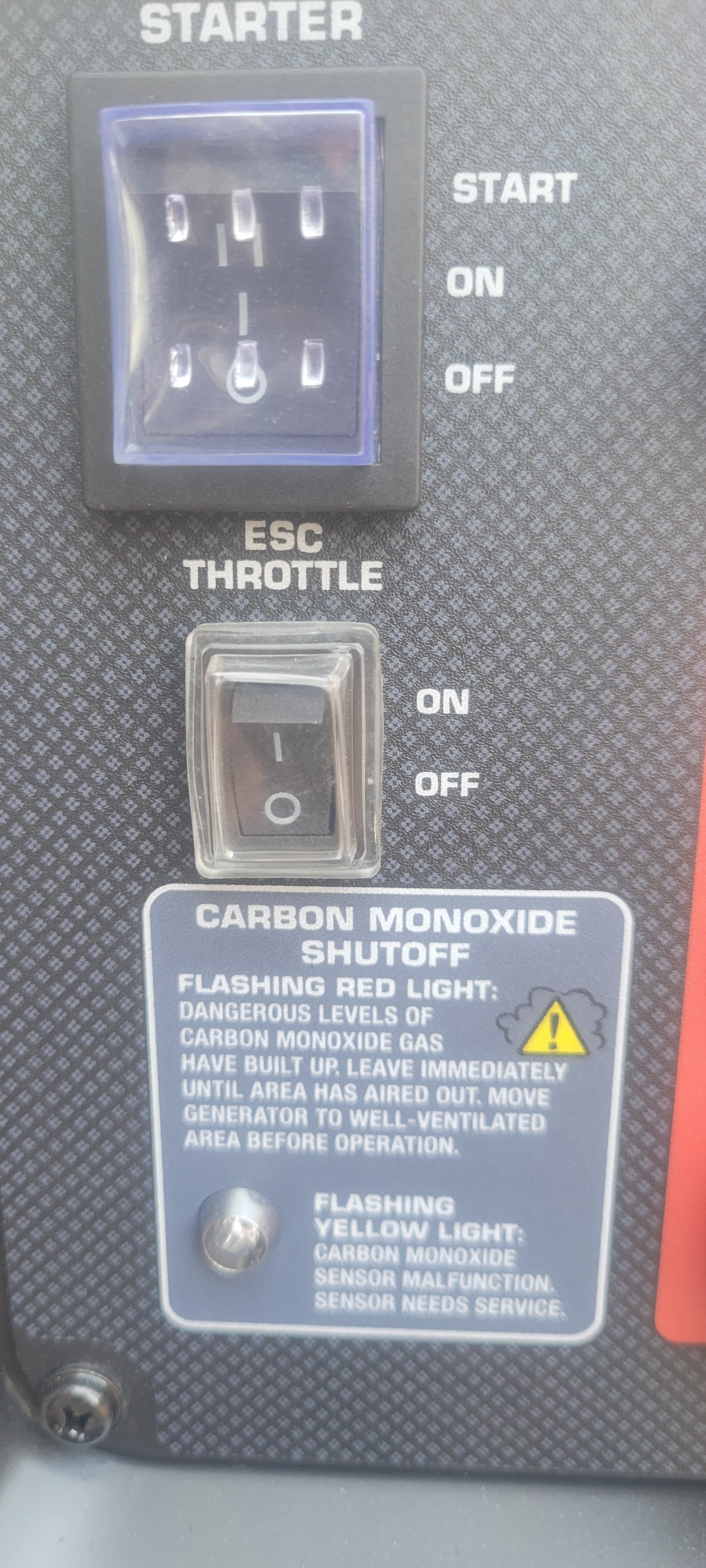

Does your generator have an Eco idle? If so it’s always running on low and then spools up when there’s a load. it should have a switch to run it on a higher throttle so there’s not a lag.
Your resetting the ground fault interrupt at the receptacle not a breaker? just to be clear.

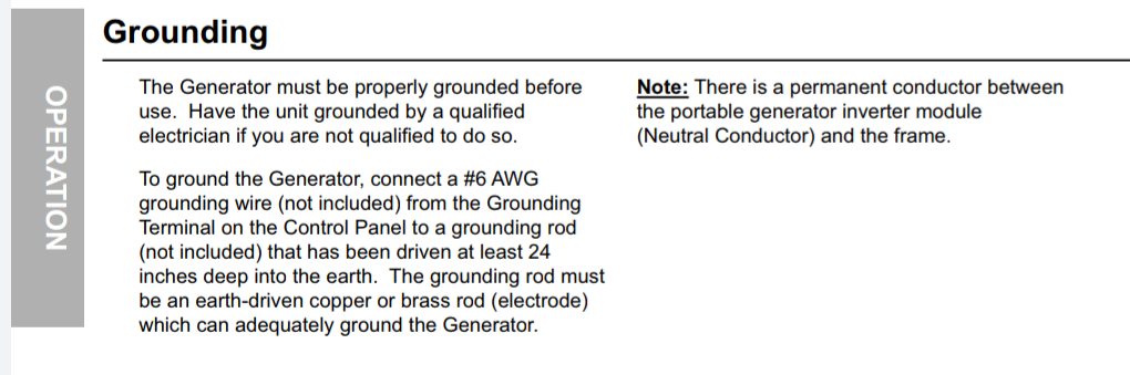

Is the generator properly grounded as described in the manual?
It’s also discussed in the manual that the GFCI tripping issue might be related to the unit not being grounded

Yes it has esc switch.
And yes its just the AC reset switch Im hitting not the actual breaker switch. I grounded to copper water pipe.

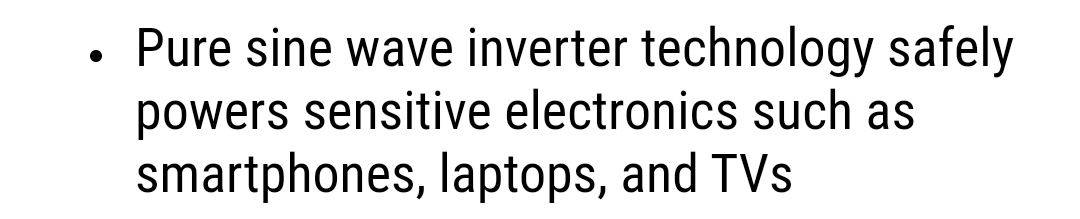

Also I could look it up in the manual but do you know off hand whether it’s a pure sine wave generator or a modified sine wave generator?
If you would have given this information in your first post it would have helped
a lot. That gen will not handle that plasma cutter. If you don’t have 240 volt power from the power company you will never get it to work right. Well unless you want to buy a sane wave gen in about 10K.

I believe my main panel is bonded to that pipe. Ill take another look and check the guage of the wire too. I believe the generator is pure sine wave, but let me check the manual.

Says its pure sine wave.
Well believe me its not. 7000 sane wave gen will cost about a $6000.
