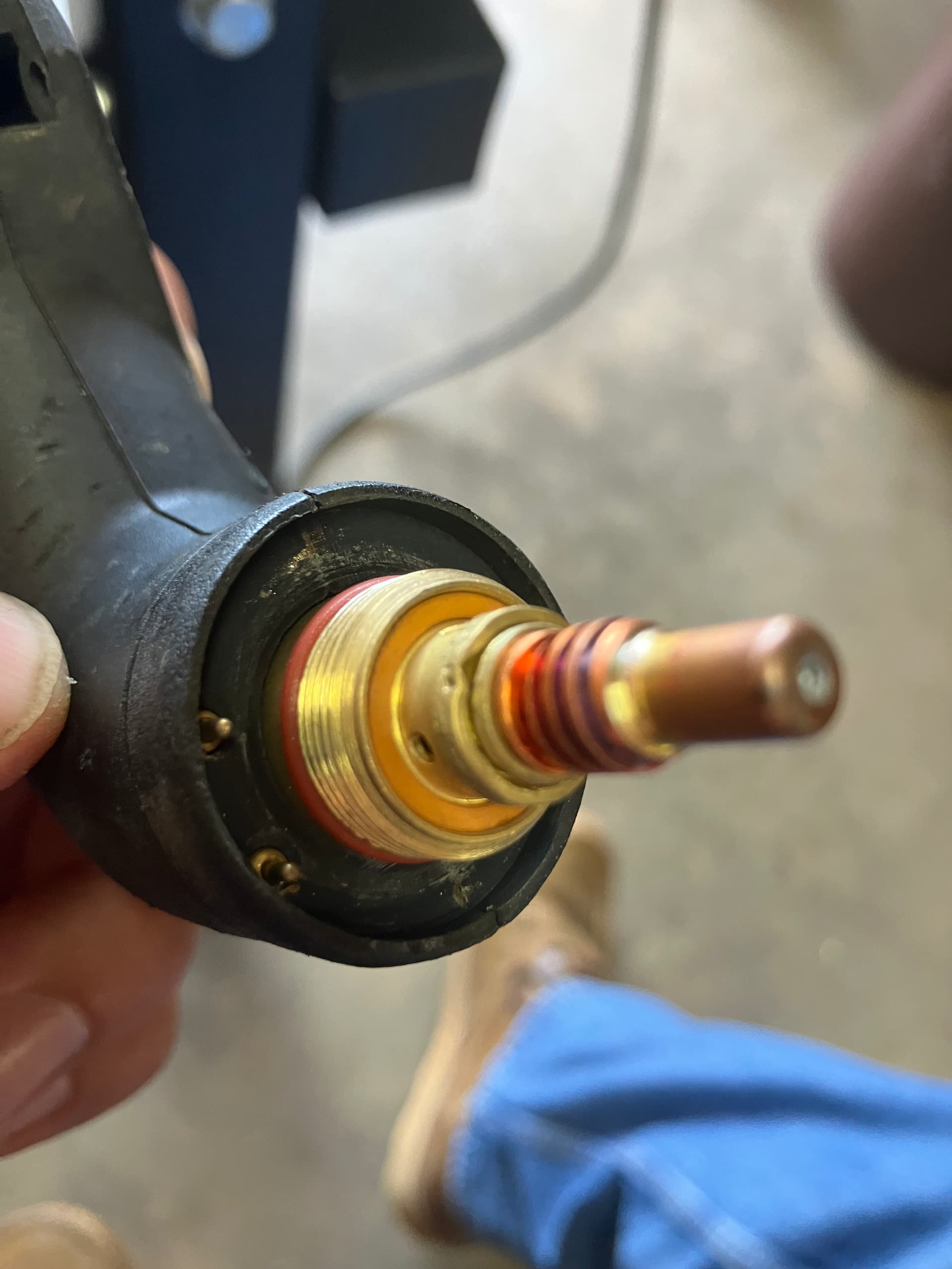

So, i think when the cutter touches the table to sense the height the tip IS sticking and throwing errors. Its sticking at an angle usually or just straight in. Im thinking this is the issue by it sticking its not allowing air to flow. Now the hole where the electrode is in the pic looks damaged at the 10-11 o’clock position. Could this be it? @Bigdaddy2166 this is what im using.
I would get with George, @mechanic416 . That torch appears to be cross-threaded or damaged in some way. Did someone put pliers or vise grips on it? George can get you a new torch head assembly if required. Does the electrode push up and snap back with your finger?
the electrode doesn’t stay depressed but it doesnt fall out freely if you tip it over. I didnt out pliers to it. But i did buy it second hand, I know, LOL.
It should push in and spring back. This is an Everlast torch but the principle is the same.https://youtu.be/2hyaNRC3tv8?feature=shared
So, my step-dad brought his Plasma cutter over and we hooked it up and the table works great. I’m thinking because the tip on mine is sticking when is goes to sense the height and then sticks is the problem. So, I need to figure out how to get a new tip/guts or cable and do the worst-case scenario and buy a whole new Plasma cutter. Thanks everyone for their help and input.
Personal message the guy @mechanic416 . He can sell you the new part or you can send it to him to fix. He has a plasma shop in Delaware and is a major contributor here on the forum.
Sorry been out all day. You will need a new torch head. It will cost $150 + shipping. Or I have a new complete torch for $290 + shipping. Or you can change it to a IPT60 torch head so you can use better consumables. PM me and we can talk about all the options.
