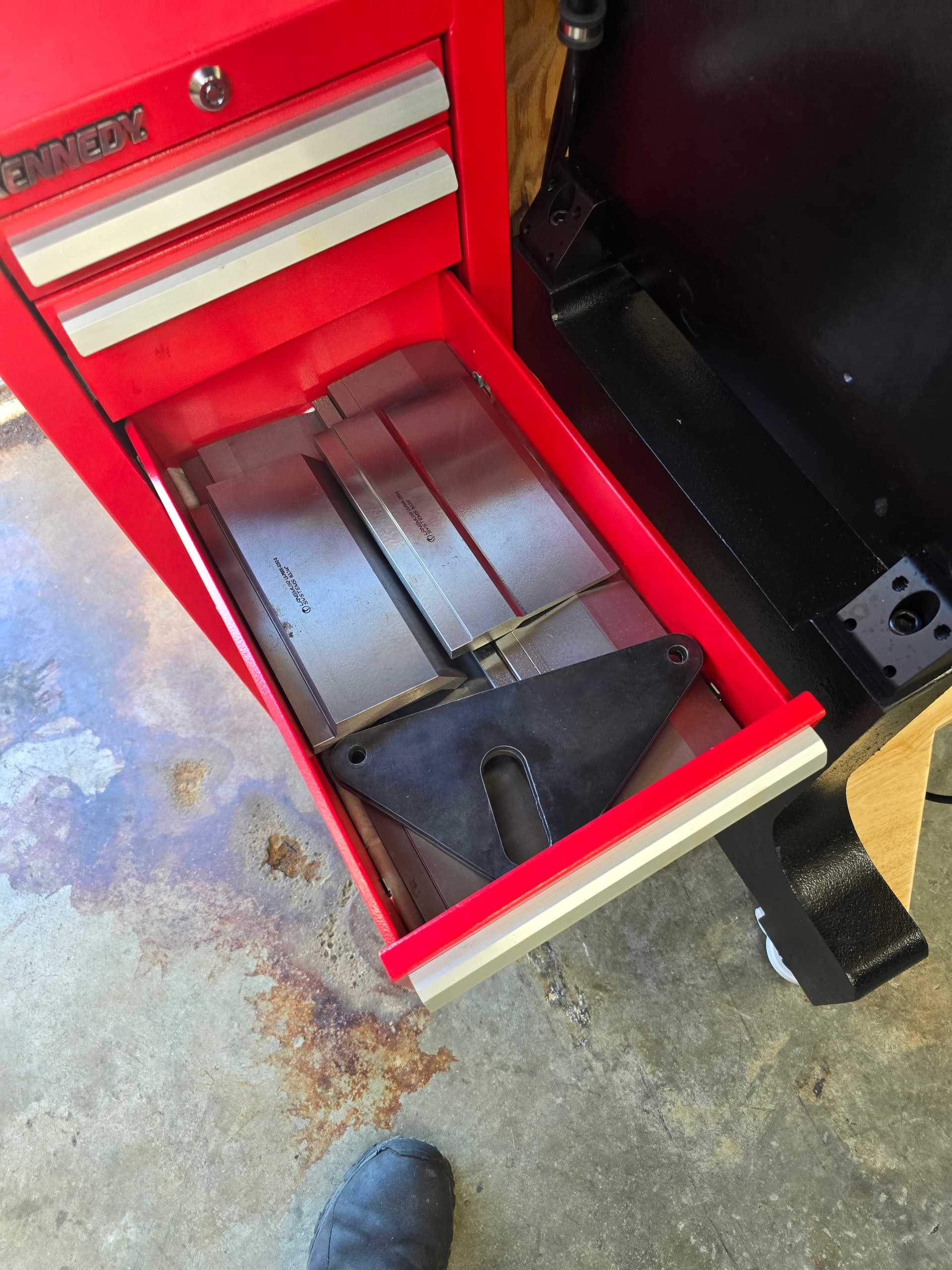

I got almost every die and punched with the machine.

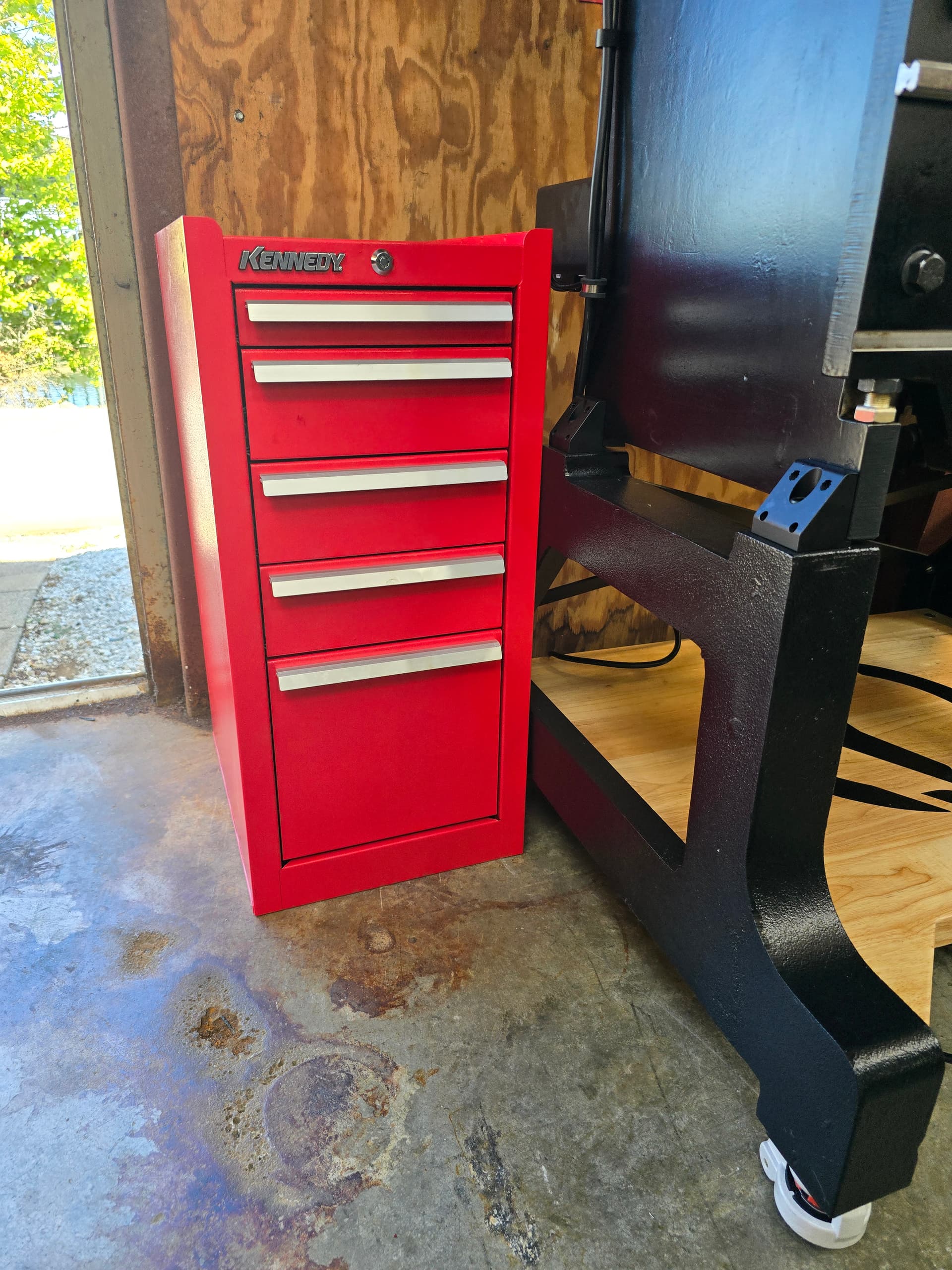

I purchased an 18 wide x 20 deep and 38 in tall.
All my tooling fit inside with room for some tools.
I also milled the one die holder, so I now have the entire bottom covered. The bottom machined surface has 1/4 - 20 holes drilled and tapped for the use of set screws to hold risers in place.
For those thinking of tooling storage. Just make sure the drawers in the box are at least 17" deep. Not the box, the drawers. There are a lot of cheap alternatives, but almost all the drawer depth is less than 16 or less, even though the box was larger.
Note if you leave this tooling out in a humid environment, it will start to form surface rust everywhere you have touched it. I put WD 40 of them and put desiccant packs in the drawers.100g Rechargeable Desiccant Pack… Amazon.com

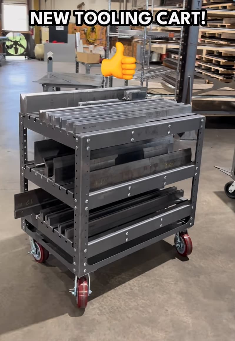

Regarding tooling storage, check out LaswrBros. They sell the design if a tooling cart for $5. What I’m going to do is make a cart using their design that is mostly cart with a mid-level shelf that will hold my tooling. I might add drawer slides…using the 600lb Accuride slides.

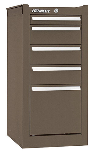

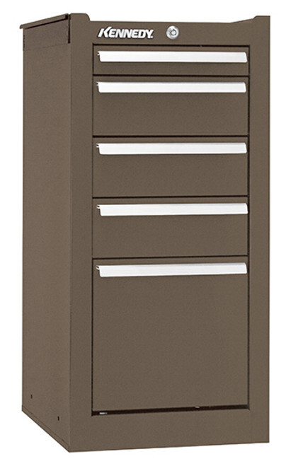

What Model # is your Kennedy Cabinet and what did it cost ?
I googled … LaswrBros…and could not find anything. Do you have a Website ?
Kennedy K1800 Series Side Cabinet, 5 Drawer, Red, Steel, 13-1/2 in W x 18 in D x 29 in H 185XR | Zoro $695

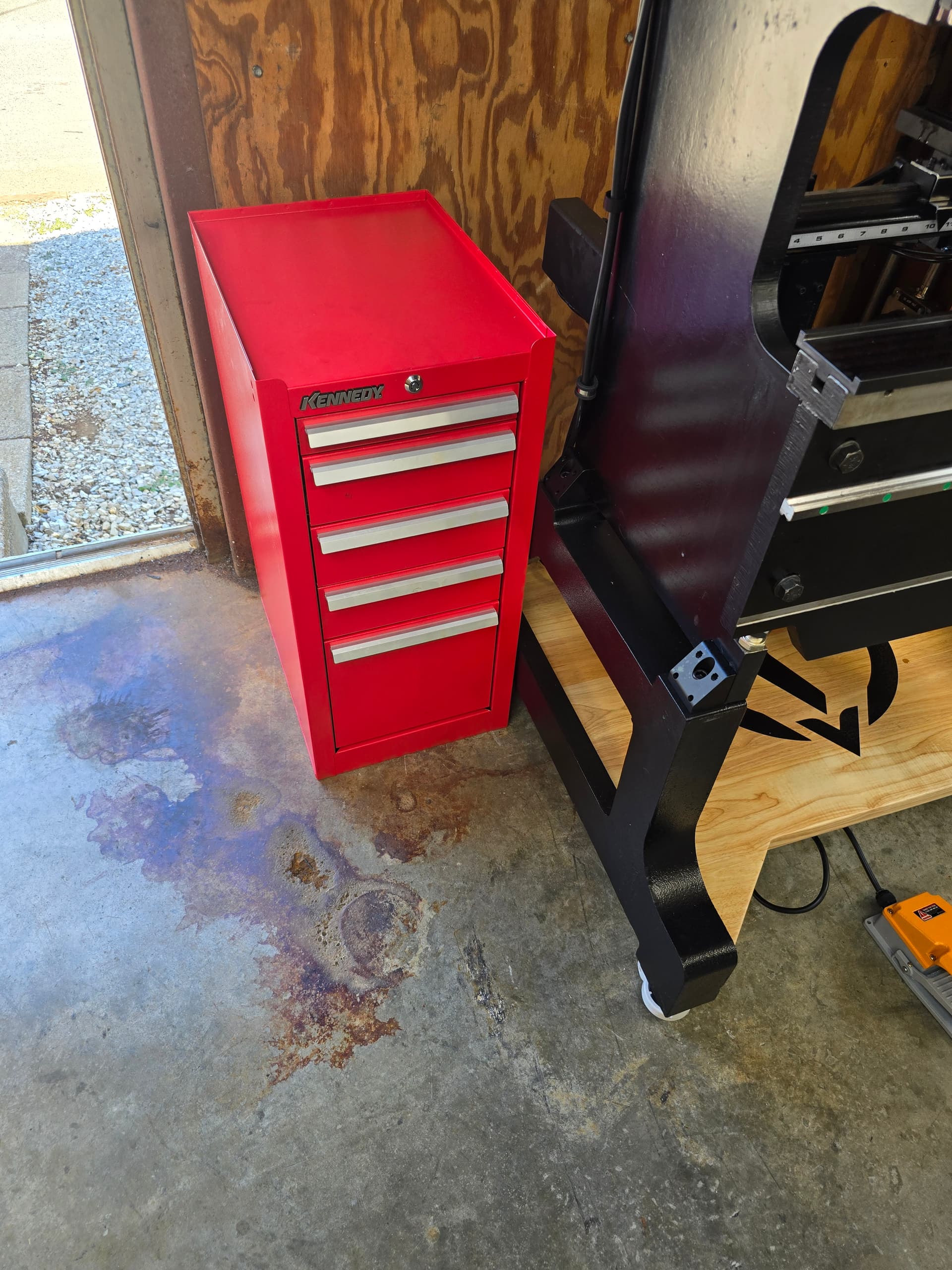

I’m sure you can get a better deal. I needed it to fit in a certain location.
I am assuming you will have a dedicated place for the Press and you will leave it there. What if you cut a 1/8" x 12" x 48" steel plate , cover it with Stair Grip tape, and bolt it to the floor. Buy some magnets and attach them to your Foot Pedal. Would that help ?
I cut out a 10x10 piece of 1/2 A36 for it to bolt down to. This way, I can kick it out of the way if needed.
The other issue is the foot guard to close to the pedal for my Sasquatch foot. Easy mod also.

Enough with these drawers, make a cart because you can!
Here you go - https://laserbros.shop/
If you look at the shop cart, and the tooling cart, you’ll see that the parts are likely interchangeable which means you could have a hybrid cart…one shelf for tooling, top shelf for a work surface, bottom shelf for piles of cluttered mess. :grin:
