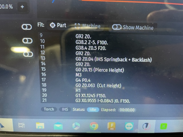

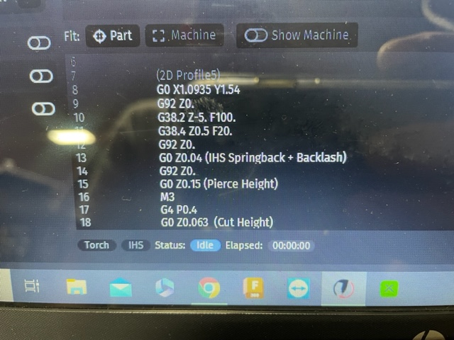

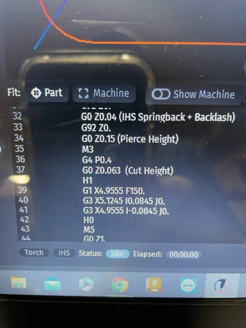

In a rush to get to work so snapped a couple pics. Let me know if this is what you asked for. If I remember correct it is line 12 and 13 that has the error.

Drove me nut so I had to walk away for awhile. Time to get this figured out but don’t know how to read the code and hoping someone that does can take a look and tell me if it’s in the code or I am having a mechanical issue.

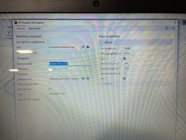

From the code you’ve posted, it matches with the settings you’ve entered into Fusion.
8 G0 X1.0935 Y1.54 - Travel to pierce location
9 G92 Z0. - Reset Z axis to 0
10 G38.2 Z-5 F100. - Probe Z axis down until limit opens
11 G38.4 Z0.5 F20. - Retract Z axis until limit closes
12 G92 Z0. - Reset current Z axis position to 0
13 G0 Z0.04 (IHS…) - Raise the Z axis by springback + backlash. .02" (entered in Fusion) + .02" in post.
14 G92 Z0. - Reset current Z axis position to 0
15 G0 Z0.15 - Raise to pierce height
16 M3 - Turn Torch on
17 G4 P0.4 - Wait for Pierce Delay
18 G0.063 - Lower to Cut Height
Keep in mind, that IHS Springback + Backlash are adding .04" to your pierce and cut heights you have entered in Fusion. You may want to adjust your heights to take this into account.
This appears to be the 1st part / piece in the cut file. You had mentioned that the error occurs at the start of the 2nd. Can you scroll down the code to the next occurrence of these commands. (Should be almost identical.)

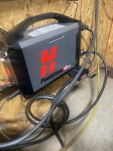

I have the Hypertherm 45XP with CPC port and machine torch and Langmuir cable so our systems are the same but the set up could be different as I have extensions on both leads from the VIM box/cable and have a 16 foot USB cable from printer to enclosure. I only explain this to say: “Your settings may need to be different from mine.”
First off, I have never been able to run a cut program on FireControl with a pierce delay of less than 0.5 seconds and you have 0.4 seconds set. And this was true before I put the extensions on the CPC/VIM cabling.
Secondly, I have done extensive testing of my actual cut height and found that I really needed to make some major changes in processing in Fusion 360 to get the desired cut height of around 0.06 inches. The THC may be searching for the correct height and merely stopping as it was unable to maintain the current. Check you cut height and look to see if it appears further up than you remember. 0.06 inches is pretty close to the metal so it will be obvious if the torch is up near the 0.1 inch area.

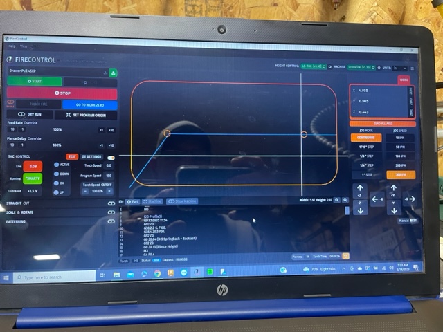

Good info and thanks for the screenshot!

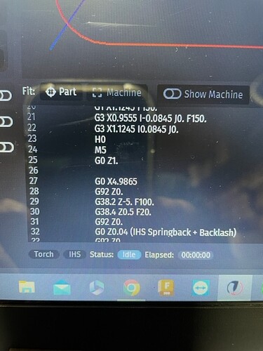

Here is a couple more screenshots of the code. Not exactly sure what I am looking at but wondering why line 26 is blank. Could this be my problem?
I am just learning bits and pieces of the gcode but that space is normal. It means that contour is complete.
Line 24 M5 (M5 turns off the torch)
Line 25 G0 Z1 (Z1 tells the z to move/retract to 1 inch, to prepare for moving to the next location)
I am assuming the space is provided to make it easier for you and I to read it but the machine ignores the blank lines. Machines are very literal: They do not take a break unless told to do so.
Such as line 36. That is what a pause looks like: “P0.4” That tells the machine to pause for 0.4 seconds. That is the Pierce Delay. Mine would be “P0.68”.
