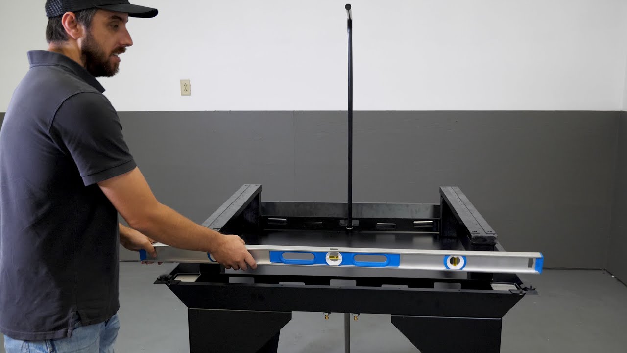

Baseplate seems set back slightly from early pics.
Uprights are 3 x 3 square tubing?

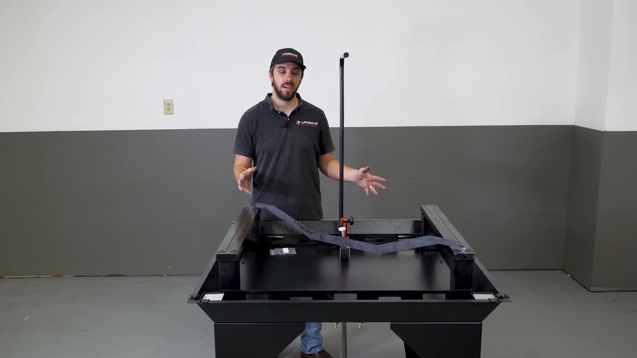

Worth using a vibrator for the concrete?
Steel rebar for additional strength?
How about filling the area between the stabilizer plates with concrete too?
Bump for the rebar question. Is there any benefit? The whole time i was watching the videos i was thinking to myself ā€œSelf, I know Iā€™m going to crash the machine and crack that concreteā€. Are my fears legit or is concrete just that strong in comparison to my mistakes?

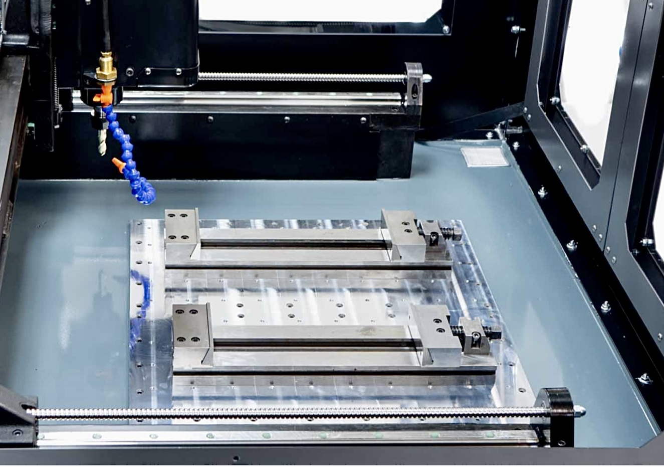

as for placement of the table, the video uses a preproduction unit and in your last pic, you can see that the spindle can go behind the table, so having it backed up is a good thing.
Iā€™m just pointing out the inconsistencies. It may be too far forward based on the spindle location but the plate is 20ā€ and the Y travel spec is 21.8ā€.
https://www.langmuirsystems.com/mr1#specs
If the plate is moved back so that the anchor bolts are behind the cross plate (approx 37ā€ x 3ā€ x 1/4ā€) that position the rail plate towers, the base could end up too far back. Just guessing at this point because I have no way to mock up the spindle, gantry, and all the rails to verify anything. Hopefully weā€™ll know in the next few videos because their page on the MR-1 base design shows a different mock up than the final result. Base Design | MR-1 CNC Gantry Mill | Langmuir Systems

Yes, concrete is strongā€¦in compression. Not nearly as strong as iron or steel, especially under tension. And not all concrete is created equal. Iā€™ve read recently strength can vary up to 6 times depending on the admixtures. Iā€™m just learning about most of it so I canā€™t offer much advice but can pass on some references.
Food for thought.
Regarding baseplate position you are correct. Pre-production unit we had the baseplate biased to the front of the machine. Production units will have the baseplate centerline in the same location as the envelope centerline.
I think itā€™s worth noting that maximum strength is not a primary design factor for a CNC milling machine. Stiffness and damping are significantly more important. Considering that the peak loads imparted on the machine by the cutting action are never greater than ~150 pounds, the concrete is never loaded remotely close to its limit in either tension or compression.
Concrete is excellent for both stiffness and damping and thatā€™s why it works so well in MR-1.

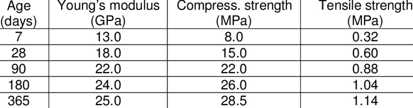

Itā€™s concreteā€™s lack of elasticity that Iā€™m trying to point out. The reason we donā€™t see bolts made out of concrete is because itā€™s extremely weak when it comes to elongation. It also takes a lot longer to fully cure than most people realize. In fact some say it never cures 100%.
MPa x 145 = psi
.32 x 145 = 46.4 psi
.60 x 145 = 87 psi
Ultimate Tensile Strength of 1018 steel is 64,000 psi. You donā€™t usually see compression strength rating for steel but Iā€™ve read itā€™s something like 200,000 psi.
Concrete is normally rated by itā€™s compression strength.
28.5 x 145 = 4,133 psi

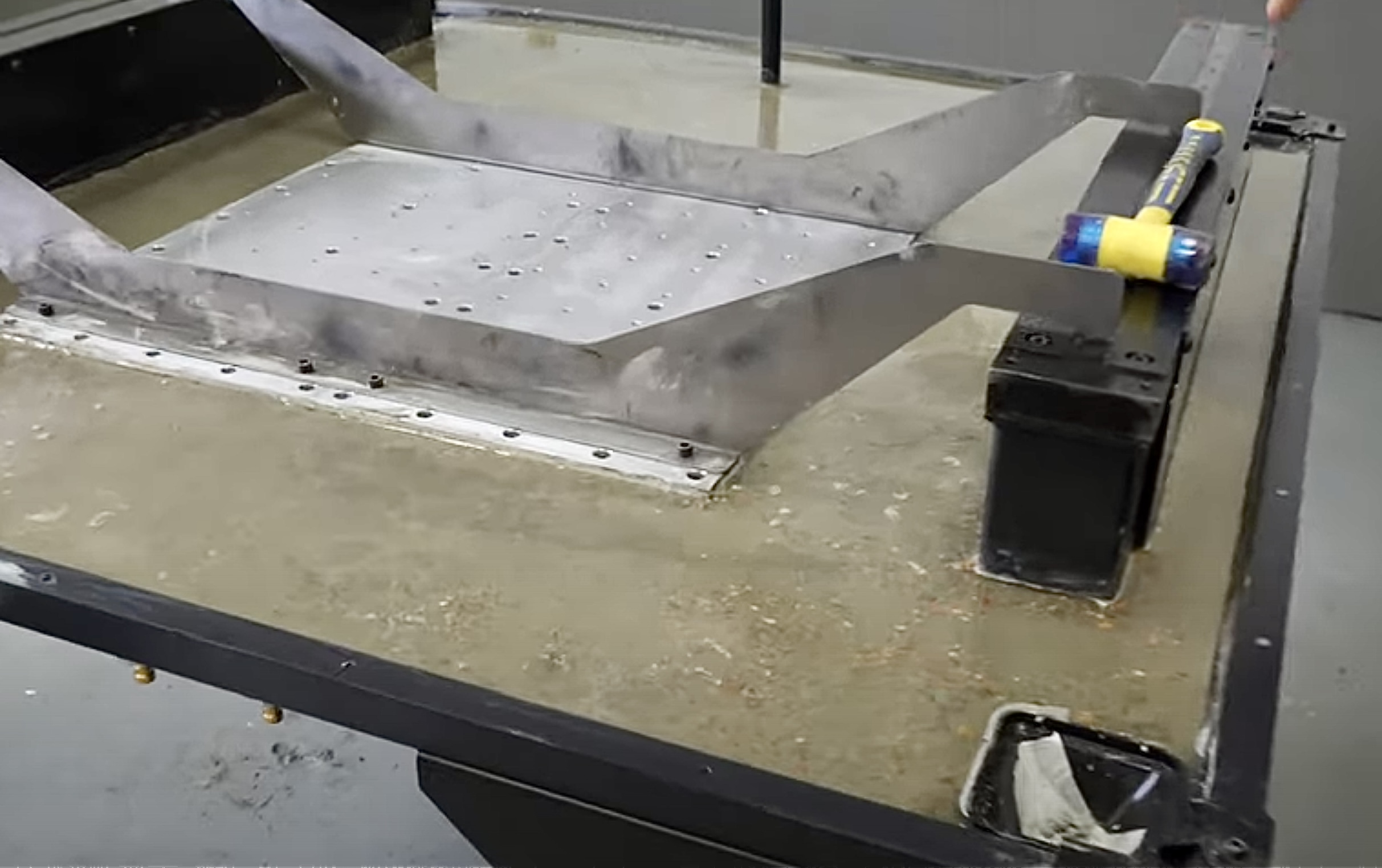

When I first read about using concrete for dampening and rigidity, I thought what a great idea. Later I was taken by surprise when I saw the anchors fastened to the bottom of the aluminum plates and just pushed into wet concrete. Then it was centered with a tape measure and some funky plates to get the table to the correct height to the rails.
In my simple mind I was thinking there would be a steel plate or flat bar bolted to the base (same as the ā€œYā€ axis rails) located in a precise position drilled a tapped to except risers that had threaded holes for bolting on the aluminum plates. Next step would be to pour in the concrete to the required level and bolt on the aluminum plates.
Some of my concerns are, will there be certain areas on the plate that will vibrate? One of the quadrants of the plate is not as rigid? Will the table (aluminum plates) be secure with anchors into concrete and not fastened to anything?
My experience is in machine shop and not construction of concrete slabs and anchors. Iā€™m just looking for some feedback and reassurance from the experts at LANGMUIR.
