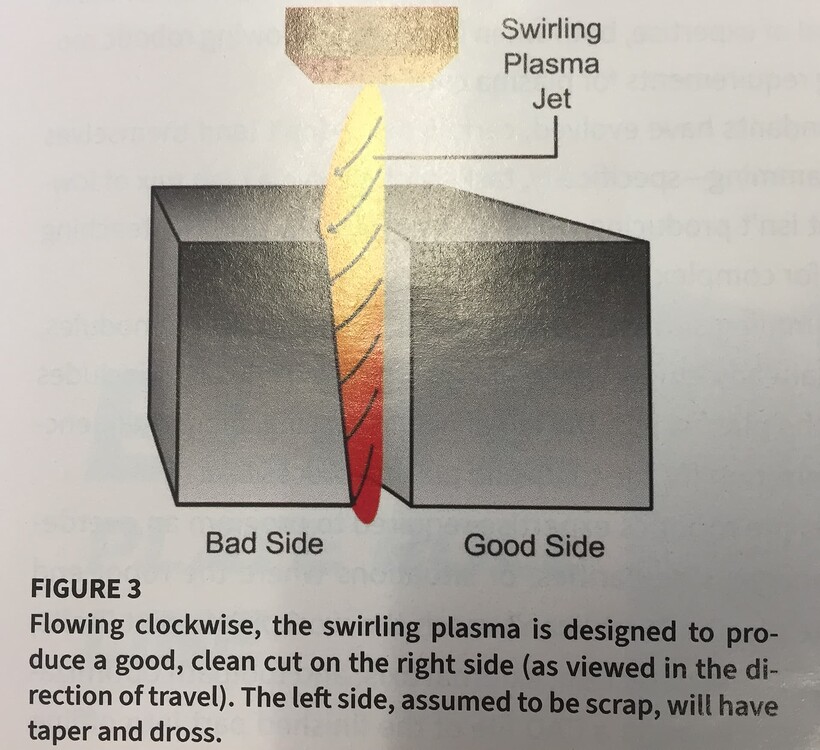

What I have noticed is a fairly concentric bevel in all my cuts. I have adjusted IPM, Pierce Height, Cut Height, Kerf, Different Nozzles and Pierce Delay to reduce the bevel size. But the original settings I got where the best. The max bevel i am getting is 6 degrees and the “good” side is about 3 degrees. Difference between top and bottom of the bevel is .050"
From what I have read here and attached pictures below, BEVEL IS UNVIABLE to remove and have a perfect squared part.

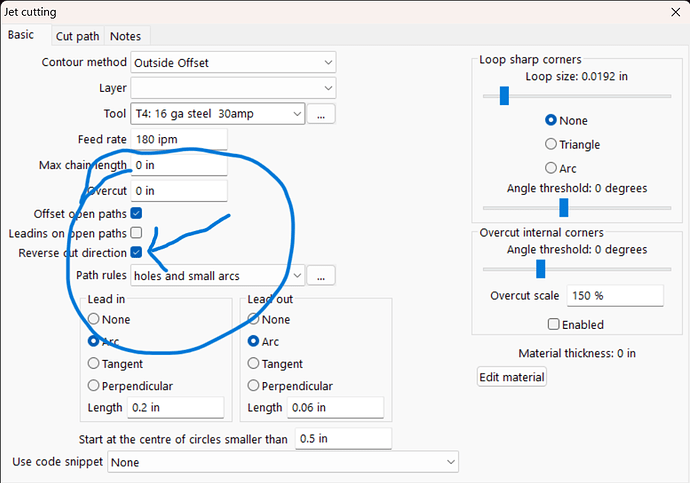

My 1st question is, for sides that I need the least amount of bevel (mounting locations) can I program in Sheetcam for a tool path to cut of the good side of the plasma torch?
Second question, how can I accurately program in Sheetcam, a tool path to cut on the good side of the plasma for cutting holes?

As for SheetCAM and picking the right offset, here is a post from David (one of our resident geniuses) that answers that:

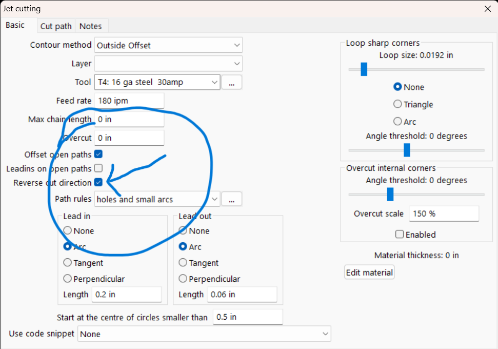

Select “reverse cut direction” in the Jet Cutting Operation screen. This will make sure that the machine travels in the correct direction, so that the “good” side is always on the part that you want to keep.
If you are using a single layer for the whole part(recommended), always select “outside offset” in that screen. This will allow Sheetcam to assign the correct offset to inside and outside cuts.

For clarification, I did not measure cut height, I only adjusted in the program by +/- .050" increments. I will square the plasma torch to the material this time. It was squared to the machine slats. Makes sense to square it to the material I am cutting. Thank you for the information!
I did not have reverse cut direction or offset open paths selected. I’ll select those and run it again! Thanks for the input!
Awesome thanks a ton for that information. I will gladly lube it up haha
I’m not sure you want offset open paths selected. At least the things I have cut, I wanted the the open path’s cut right on the line not offset.
I wouldn’t use the “offset open paths”.
An open path is a line that isn’t connected to anything else. Sometimes they are decorative and it doesn’t matter if they get offset.
If the open path is a bend relief cut, you want it to cut directly on the line for accuracy of the bend. Offsetting to one side or the other would be bad, in that situation.
