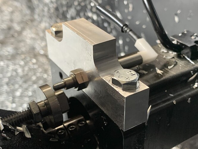

I did upgrade all the drivers to the high power units. Installed the Merkel limit switches . And bored a 4 inch drain in the center behind the base plate.

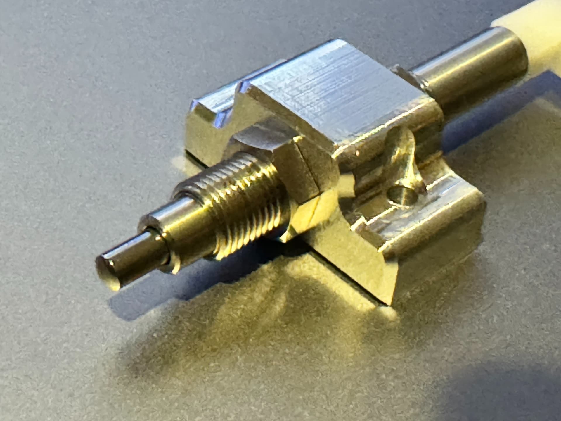

Can you send me a picture of their merkel limit switches? Curious what I received this last summer. Thanks!
My machine is in my shop at work. I will be at a Marina electrical conference till Monday. Here is a perfect example of a properly installed Merkel switch that a friend of mine posted.
Thanks for the picture. Is there a reason for the raised center section, or could it have been made out of lower profile stock?
I’m still running the original limit switches without issue, but will put the upgrade on my list of projects to do.
Thanks for sharing. That’s definitely not the switch I have that came with the kit. McMaster Carr?? If you have a model number let me know and I’ll buy those. Thanks again! Have fun at the conference.
Mark
8mm x .75mm thread. Not a must have. My problem was I had added a sprayer hose for cleanup. I had not anticipated the original coolant would be like maple syurp when it dried. Fusion 2240 coolant works 10 times better and will not turn your aluminum black. Not sticky either…
The picture is a friends machine but, mine are almost identical. No reason for the raised section. Just looks :sunglasses: I will say that I have not had a single limit switch related issue since.
I kept my mounts smaller to mount to the original holes, but they are working perfectly. I actually like the right angle version shown here. Highly recommend.
Same here. I switched (a little pun there) over to the CSK087B-RL and haven’t had any problems with squareness or the machine repeating work coordinates. 100% recommend the upgrade.
The RL switch just has a right angle lead coming out of the back instead of straight. The straights were out of stock when I ordered mine :laughing:
