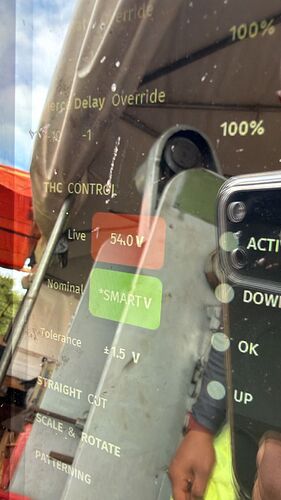

THC showing voltage when not cutting
Hello everyone, blessings. I’d like to know if any of you see that number on the TCH panel, even with the plasma cutter off, indicating live voltage. It temporarily disappears and returns to normal when that static voltage is present, but then when I turn on the plasma cutter, it increases to 190 and 210 volts, preventing the height control from working efficiently.
You need to verify you’ve actually got voltage coming out of your plasma cutter while it is disconnected from the crossfire table. If you don’t, then you’ve got some sort of Emi issue going on. If you do, you got something glitching inside your plasma cutter.
