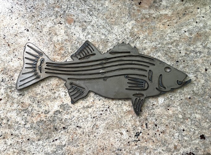

So I’ve read a lot about this issue before getting my table and in the short time I’ve had it assembled (2 days) I’ve cut out a bunch of test stuff and a couple of real items. All with very good success. Today I decided to put water in the table and leak check my welds in the seam. As luck would have it I had a couple of pin holes to fix. Drained the table rewelded a couple of spots and refilled the table.
Loaded a piece of metal and did a dry run all good! Started the camera nad it started up did a pierce and quit. Got the voltage waring and I realized I hadn’t put my work clamp on the work itself. Fixed that reset the program push start… Same thing… I run the THC test and sure enough it fails. I unplug the laptop and run the test again and voila it passes.
So strange, I cut my piece out no problem. Seems strange that the only thing I did was add water to the table and now the laptop has to be unplugged. Has anyone else seen this? Here’s the part!
